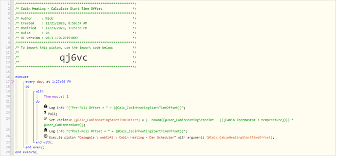

I am attempting to vary the start time of my heating system based on current thermostat temperature reading, my heating setpoint and the heating rate. I have set up my heating set point and rate as global variables, the calculation then takes one from the other and multiplies by 7 (minutes per degree) to figure out how long before the heating needs to switch on to be warm in time for use.
I’ve tried various, set offset as global variable, run a piston to calculate this, then another (a couple of minutes later) to use this. I’ve tried calling the 2nd piston from the first, with and without an argument.
I’m going nuts…
Heating switch on based on time I want it to be warm minus offset minutes
Sometimes ignores the offset, sometimes I ‘think’ it’s calculating, but using the last calculated offset.
Caller Piston:
Callee Piston:
Caller Piston:
12/23/2020, 1:26:59 PM +38ms
+0ms ╔Received event [Casagale].time = 1608730020000 with a delay of -963ms
+51ms ║RunTime Analysis CS > 17ms > PS > 6ms > PE > 29ms > CE
+54ms ║Runtime (38937 bytes) successfully initialized in 6ms (v0.3.110.20191009) (53ms)
+55ms ║╔Execution stage started
+66ms ║║Cancelling statement #27’s schedules…
+73ms ║║Calculating (string) Pre-Poll Offset = + (string) -95 >> (string) Pre-Poll Offset = -95
+79ms ║║Pre-Poll Offset = -95
+80ms ║║Executed virtual command [Cabin Thermostat].log (2ms)
+345ms ║║Executed physical command [Cabin Thermostat].poll() (262ms)
+346ms ║║Executed [Cabin Thermostat].poll (264ms)
+357ms ║║Calculating (decimal) 20.0 - (decimal) 6.5 >> (decimal) 13.5
+362ms ║║Calculating (decimal) 13.5 * (decimal) 7.0 >> (decimal) 94.5
+365ms ║║Calculating (decimal) 0.0 - (decimal) 95.0 >> (decimal) -95.0
+368ms ║║Executed virtual command [Cabin Thermostat].setVariable (1ms)
+374ms ║║Calculating (string) Post-Poll Offset = + (string) -95 >> (string) Post-Poll Offset = -95
+378ms ║║Post-Poll Offset = -95
+379ms ║║Executed virtual command [Cabin Thermostat].log (2ms)
+389ms ║║Executed virtual command [Cabin Thermostat].executePiston (6ms)
+392ms ║╚Execution stage complete. (338ms)
+394ms ║Setting up scheduled job for Thu, Dec 24 2020 @ 1:27:00 PM GMT (in 86400.569s)
+401ms ╚Event processed successfully (401ms)
