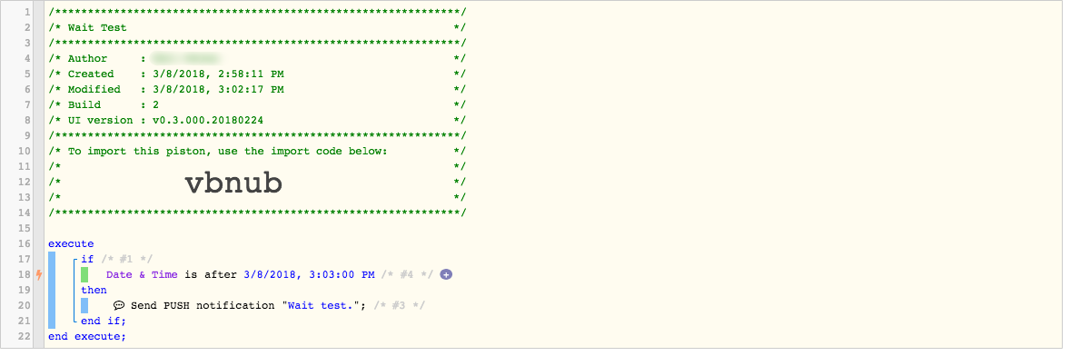

As a test, I did this and it did send me a notification at 2:47:10pm (obviously ignore the commented out stuff)
I’ll try it again. It doesn’t have the little lightning bold next to it so I figured it wasn’t an actual trigger.
By the way, after I saved the piston, I had to hit the “test” button in order to make it say “setting up scheduled job for …”
After hitting “test” button, then I get:

| +138ms | ║║Requesting a wake up for Fri, Mar 9 2018 @ 2:47:10 PM EST (in 85707.26s) |
| +166ms | ║╚Execution stage complete. (43ms) |
| +183ms | ║Setting up scheduled job for Fri, Mar 9 2018 @ 2:47:10 PM EST (in 85707.218s) |
| +189ms | ╚Event processed successfully (189ms) |

It is being triggered by date/time. But it appears that simply saving it doesn’t run through the piston and re-evaluate it. Guess you gotta hit the “test” button. One of minions may be able to explain that part.

Will this not work for you?
I forced the subscribe as it’s a condition not a trigger (even though my simple piston only has a condition so on it’s own it would subscribe anyway).
That’s a condition, and I have other defined triggers in the same piston so I would have to move this off to it’s own piston but that might be the easiest thing to do at this point.
Right, and thus why I mentioned forcing the subscription to make it act as a trigger. But without seeing your whole piston it was hard to see if it would work.
I didn’t know you could do that, I’ve never played with subscription. So, if you set to always subscribe it would treat it as a trigger?
