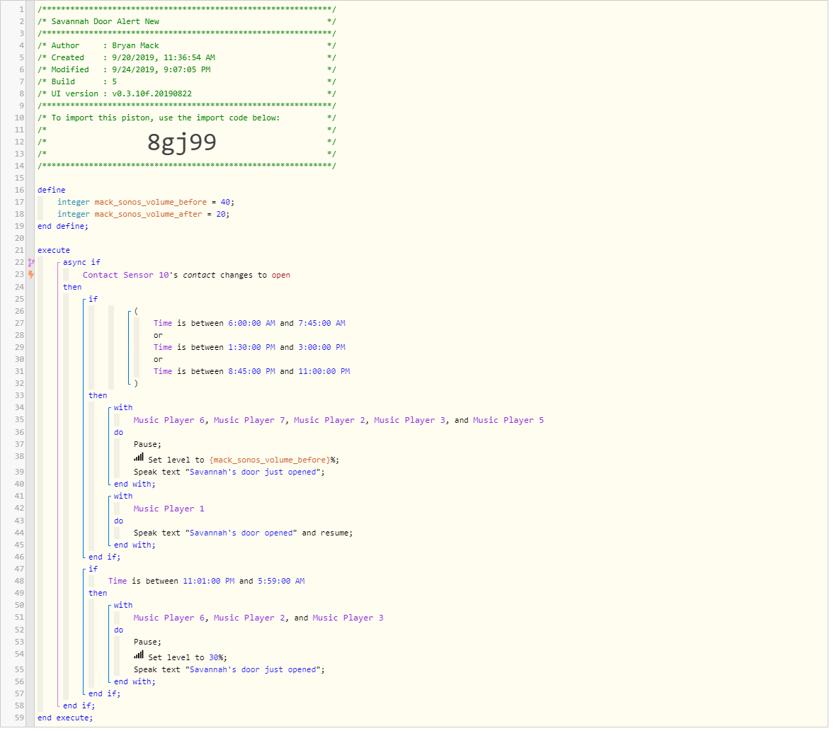

Piston only firing one of my WITH clauses
When my toddler’s contact sensor opens (her door), 5 of my sonos speakers will pause, adjust volume, and speak to me that her door will open. 1 of my sonos speakers will simply speak text and resume.
The 5 speakers pausing/adjusting/speaking work fine. The 1 speaker that is supposed to just speak & resume does nothing. Music Player 1 at line 41 is what is not firing**
I only have minimal logging set, and that says it’s firing. I just switched it to full logging, but can’t produce a log until I get home tongiht. I will edit this once I have that log.
Within that first then, it is impossible to execute the first ‘with’ without executing the second unless an error occurs to stop the piston execution. Have you done a simple test to make sure the speak text works with that speaker? Create a simple piston that just does speaks through that one speaker and make sure it works.
It works with that speaker for sure. It was working formerly. I used to have all of the speakers do the same thing – but the one I split off is my sonos playbar - and it was blasting the TV and not re-setting the volume after it spoke, so I split that into it’s own “then” so the volume doesn’t adjust. Now, the playbar does nothing. The others all perform as expected. I was wondering if maybe that it’s trying to use TTS twice in the same “WITH” with the same text, that may be the problem, so I slightly changed the text on the second one – that didn’t fix it.
Hmmm, I am at work so can’t confirm, but the thing just fired and it looks like it worked, I’ve changed nothing. “Living Room Sonos” is the one of concern …

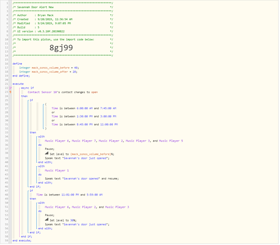

Can you try changing the broken “Speak text” command on line 44 to match the working “Speak text” on line 39?? (IE: remove the “and resume” portion)
I’ll give that a try. I’ve never understood what the difference is between “resume” and “restore”. My whole point of doing this is because I hate that it turns the volume way up on my TV to blast this message, so I modified it. If I’m not listening to a sonos, I want it to play at X defined volume. If I AM listening to the TV, however, I want it to play at the volume I’m listening at currently, and then go back to the TV show I’m watching.
Side Note:
I just noticed that you have an ASYNC IF here. I would change that back to a normal IF.
(logic flows very differently with ASYNC, and it is not needed here)
Will do, note that I added async just to troubleshoot this, so have confirmed it doesn’t work without it. But no need to have it in there, I agree.
