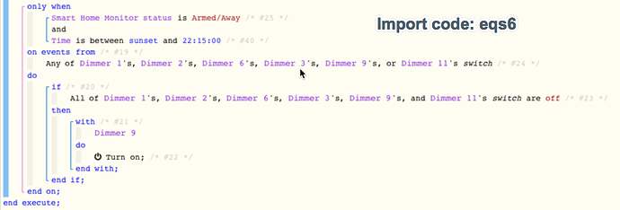

I’m stumped. How do I create a Only When / On Events From logical construct? That part of the Wiki is a stub. Can’t find anything here or on Google search. I’ve looked high and low in WC and cannot find it. Frustrated!!
I want to insert this snippet from Robin that determines if all specified lights are off, then turn one back on. I tested this last night in a stand-alone piston after importing Robin’s code from eqs6 and it worked perfectly. But I want to add this code to my Vacation piston

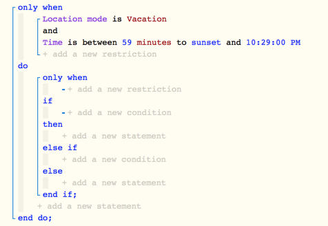

OK, still stumped how to actually insert the “On Events From” statement into the code. “Show advanced statements” is checked.

How can I add “On Events From” as a top-level statement?

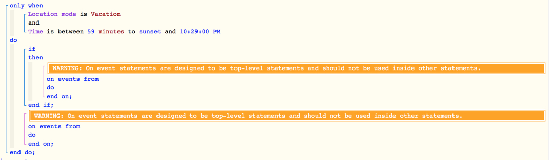

Click on + add a new statement that is outside of any other blocks, and then click on this:
temp
You can also drag misplaced code if you have the option turned on up top:
temp
Thanks. Got it.
Not very intuitive. I sure fumble around a lot in WC trying to figure this stuff out.
The add a new statement adds code right there, so you can be selective where it goes.
(or just do what I do and drag it to it’s proper place afterwards)
