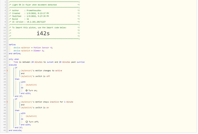

In the second IF in this piston, I want the light to go off ONLY if the switch was turned on via webCoRE, and not by being physically turned on by a person. Is this possible?

Ya… it’s a pain in the ass for sure. I’ve tried so many combinations. I’m just trying to get it that the second part of the piston doesn’t run when someone physically turns on the light, since the conditions would now be met (sensor > no activity + light ON). It always turns off the light after sensor motion becomes INACTIVE.
