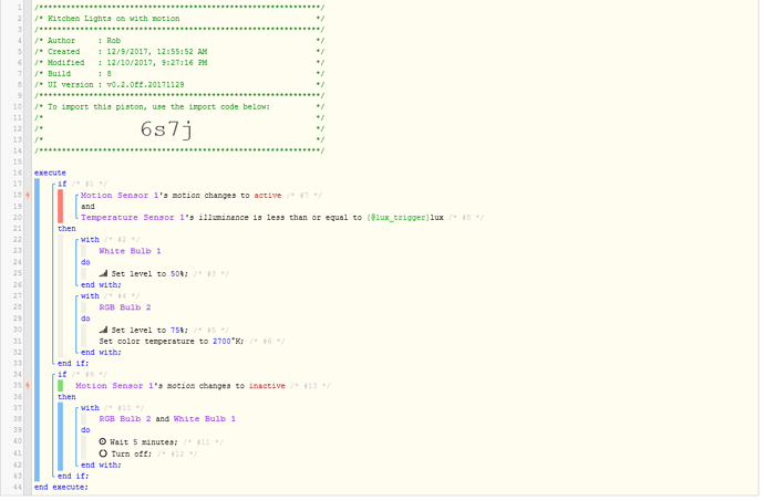

I sort of already do this. I simply have the lights turn on when either one of us comes home and it’s dark out. I also have a motion sensor in the kitchen to turn the light on with motion when it’s dark out, set a timer for 5 minutes and turn it off if there’s no motion. That’s it!
Cool, could you post a sample of your piston please
Thanks

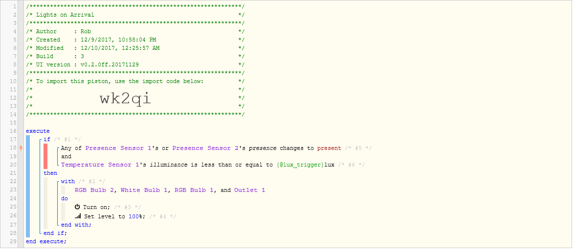

Sorry for the delay. I had to wait to get back to my desk.
It’s actually two separate pistons. One turns the lights on when we get home and does not turn them off. They get turned off by the Good Night routine when things settle down.

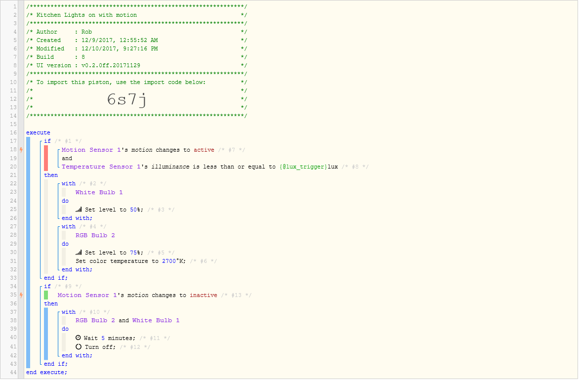

The second piston (which I think we’re going to wear out since we use it so much) just turns the kitchen lights on and turns them off after 5 minutes of inactivity. I have to set the color temperature because I use that light for other notifications (traffic, weather, turn it pink when my wife gets home, etc).
Editing to add: Motion Sensor 1 is in the kitchen. Temperature Sensor 1 is actually the weather tile. @lux_trigger is a global variable I’m using for a few other pistons when it’s dark (landscape lights, living room lamp, etc). Currently I have it set at 650 lux. RGB Bulb 2 is my under-cabinet LED strips. White Bulb 1 is a dimmer for the Island Light.
