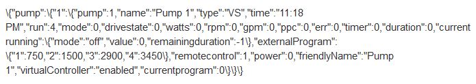

I read somewhere that one need to escape the curly brackets, so I did that with this fugly hack:
which yields this:
So this is the essence of the piston, i can post it yet it doesn’t really say much more than what’s below:
