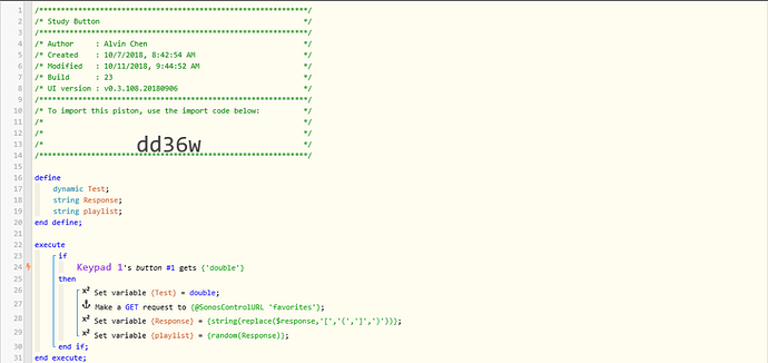

I have a piston that makes a web call, then it returns information in the form of [“Favorite1”,“Favorite2”,“Favorite3”,“Favorite4”,“Favorite5”,“Favorite6”,“Favorite7”,“Favorite8”,“Favorite9”,]. I am trying to select a random one of these, but it does not appear to work.
$response comes back fine, and the variable is set, but selecting a random one does not work
random function returns a number, not a string value

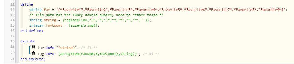

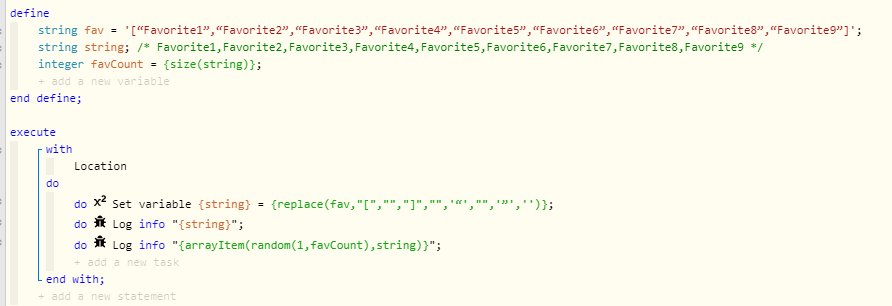

I had to do it in steps… see if this makes sense. I had to replace() the funky double quotes, is that from a mac?
Edit: Moved the replace() function in the variable definition…
