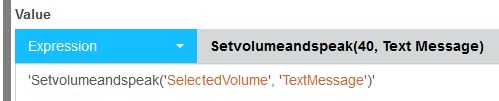

and as typed in the expression box:
'Setvolumeandspeak('SelectedVolume', 'TextMessage')'
which returns:
Setvolumeandspeak(40, Text Message)
temp
It helps when you see the translation of the code in real time (grey background) as you type, making it easy to correct any grammatical errors. Often you’ll have to populate the variables once though to see it properly.

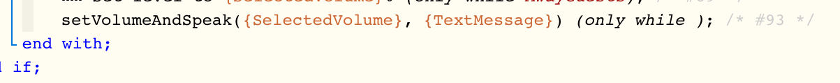

Here’s the piston. WebCoRE added curly brackets, but they were not typed in the expression box.
temp
