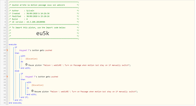

I want to push a button to pause a piston and resume , my buton does not have the held fonction !
Cant get my button to resume my piston , easy task but my button does not support the held fonction

First off, I would separate the two IF’s into their own block of code. (not inside the else)
Secondly, one button can not directly do two different tasks. Each time it is pressed, the same command will always be sent.
A possible workaround is to create a Simulated Switch. Each time Keypad 7 gets pressed, it toggles the SimSwitch. Then create another piston monitoring the SimSwitch. When the SimSwitch changes to on, then pause the third piston. When it changes to off, then resume it.

Thanks for the trick i didnt think about a simulated switch , good workaround .
Seems a shame to waste a physical button on something that’s only used 3-4 times a year… I use a simulated switch called ‘automation’ and every piston I write checks if automation is on before executing. For the rare times I wish to disable things, I just open the app and toggle the switch.
If you prefer the use of your keypad, then rather than using a simulated switch that only gets toggled by webCoRE, cluttering your ‘things’ list, I’d suggest toggling a boolean type variable instead.
