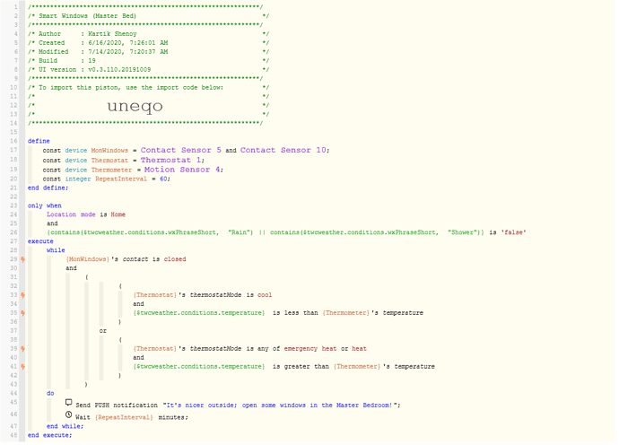

I have a piston which sends a push notification if the external temperature is higher/lower than my thermostat’s target temperature when it’s heating/cooling respectively and the windows are closed. It’s an indefinite loop which keeps running as long as the conditions are met. I added a wait statement to limit it to 1 notification per hour.
I was expecting to see at the most 1 notification for this in an hour.
The wait is being bypassed by new events which trigger the piston causing a notification to be sent way more often.

As can be seen from the logs, anytime the temperature inside or outside the room changes, it triggers the piston to run.
The only thing I can think of is to create another piston (callee) which pauses the caller piston, loops on the same conditions but doesn’t subscribe to them and resumes execution of the caller piston when the condition fails. Is there a better way to go about this?
You can click on every line with a trigger that you don’t want and in the settings unsubscribe from it.
You could probably fix things by turning off automatic subscription on the temperature conditions.
Alternatively you could consider that the key event for starting your loop is the contact changing to closed, and make that an explicit trigger with the piston rebuilt around it. That would probably include handling the ‘only when’ logic elsewhere. I am a great fan of handling ‘only when’ logic just about anywhere but in an ‘only when’.
Or you could consider that if you are only going to have a notification every hour you could just have the piston run every hour and see if there is anything for it to do, and really not worry about when the first notification might come along.
