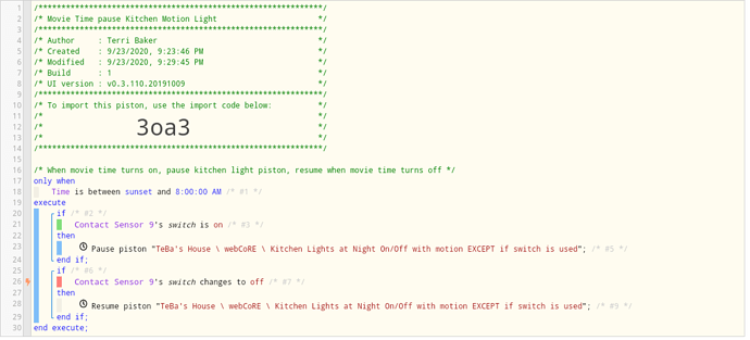

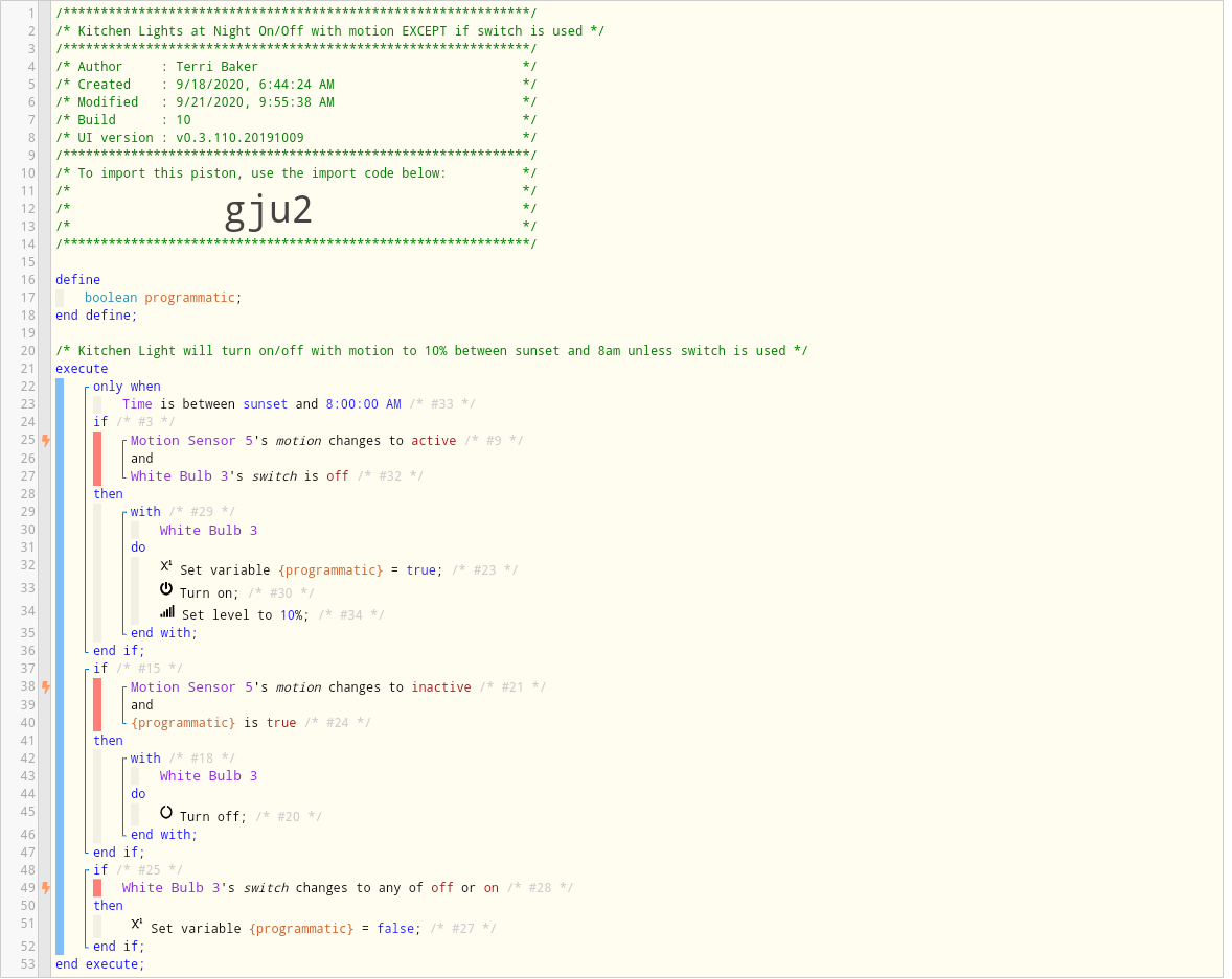

I have a piston the turn the kitchen lights on/off by motion at night.
I don’t want the lights to turn on by motion while watching a movie so i created a pause piston.
Kitchen lights will not turn on by motion when switch is on
Kitchen lights still turn on by motion

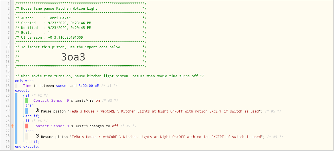

Your pause piston includes an explicit trigger on line 26 that means it will only automatically fire when the state of the switch changes. So if the switch is already on at sunset nothing will happen. If the switch does get turned on between sunset and 8am the piston should be paused. Could that be what you are experiencing?
I would recommend changing line 26 to the condition ‘is off’. That removes the explicit trigger from the piston and the piston will instead run at sunset, 8am, and whenever the switch state changes to try and best serve the conditions.
Obviously you can’t literally combine the two as a paused piston can’t resume itself, but you could add in the override to the logic.
Thank you. I will test this tonight and let you know if that fixed the problem.

@orangebucket the change to line 26 fixed it. Thank you
