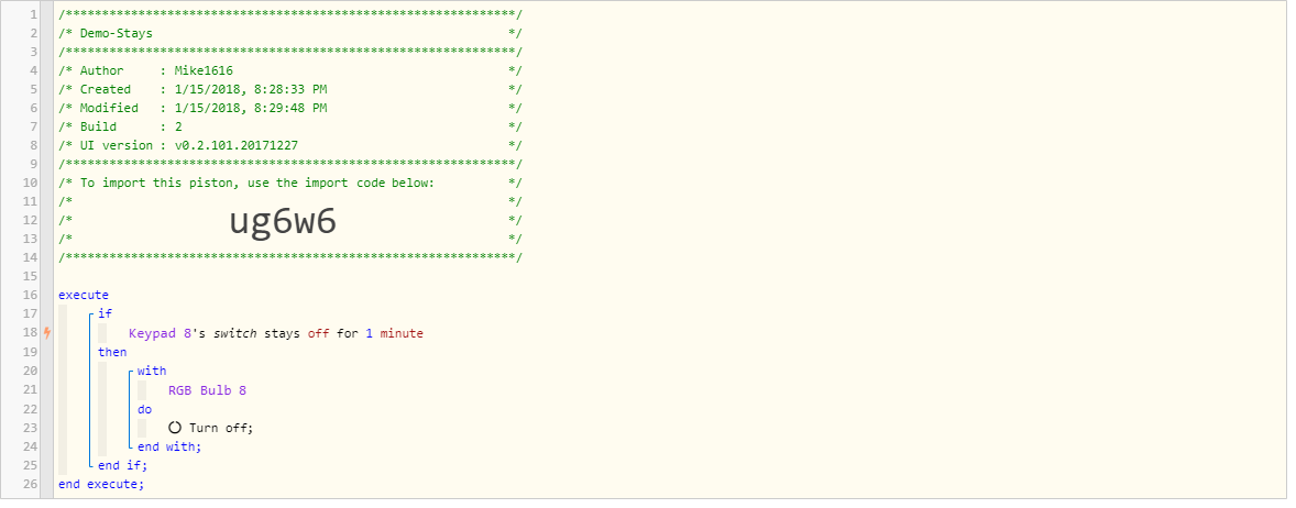

You could write it up like this:
IF Thing 1 stays off for 1 minute
THEN
When Thing 1 turns off it will send a notification to his piston that it has just turned off, which will in turn cause a Timer to start and wait for 1 minute. If Thing 1 stays off for the full minute the next steps will execute.
Does that fit your needs? I hope I read your requirements properly.

Correct.
Either way can be done really, it’s just one more command.
IF thing 1 changes to OFF
and
Thing 1 stays OFF for one minute
The first is a Trigger, the 2nd is a condition so those will work together on the same IF block.
Or you can just say:
IF thing 1 stays off for 1 minute
In the absence of any triggers the piston will use this condition as the trigger which will cause the piston to run.
One note of caution though… Be sure you account for what the steady state is otherwise you could have the piston running ALL THE TIME. So if you don’t want it looping back into itself you usually need to add some other logic to account for that.
