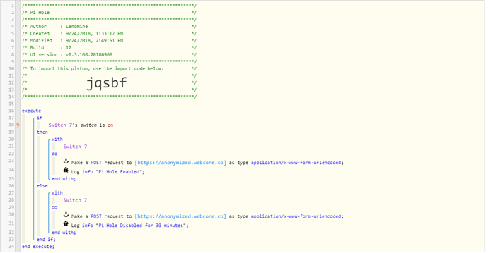

Webcore does not appear to be sending the web request to my pi-hole on my local network.
I expect Webcore to send a post request to my local pi-hole to use the API to disable it for 60 minutes.
The console reports everything is running, but Pi-hole is not changing its status. If I copy and paste the same link in Firefox the request is successful.
4) Post a Green Snapshot of the piston![image|45x37]
( 9/24/2018, 2:54:23 PM +46ms
+0ms â•”Received event [Home].time = 1537826064021 with a delay of -976ms
+60ms â•‘RunTime Analysis CS > 14ms > PS > 31ms > PE > 15ms > CE
+62ms â•‘Runtime (39554 bytes) successfully initialized in 31ms (v0.3.108.20180906) (61ms)
+64ms â•‘â•”Execution stage started
+65ms ║╚Execution stage complete. (1ms)
+66ms ╚Event processed successfully (66ms)
9/24/2018, 2:54:04 PM +581ms
+0ms â•”Received event [Home].wc_async_reply = httpRequest with a delay of 0ms
+71ms â•‘RunTime Analysis CS > 27ms > PS > 26ms > PE > 18ms > CE
+73ms â•‘Runtime (39559 bytes) successfully initialized in 26ms (v0.3.108.20180906) (72ms)
+74ms â•‘â•”Execution stage started
+96ms â•‘â•‘Pi Hole Disabled for 30 minutes
+97ms â•‘â•‘Executed virtual command [Pi Hole].log (1ms)
+100ms ║╚Execution stage complete. (25ms)
+101ms ╚Event processed successfully (101ms)
9/24/2018, 2:54:03 PM +931ms
+1ms â•”Received event [Pi Hole].switch = off with a delay of 44ms
+51ms â•‘RunTime Analysis CS > 12ms > PS > 25ms > PE > 13ms > CE
+53ms â•‘Runtime (39541 bytes) successfully initialized in 25ms (v0.3.108.20180906) (51ms)
+54ms â•‘â•”Execution stage started
+65ms â•‘â•‘Comparison (enum) off is (string) on = false (2ms)
+67ms ║║Cancelling condition #2’s schedules…
+68ms â•‘â•‘Condition #2 evaluated false (8ms)
+70ms ║║Cancelling condition #1’s schedules…
+71ms â•‘â•‘Condition group #1 evaluated false (state changed) (12ms)
+74ms ║║Cancelling statement #9’s schedules…
+85ms â•‘â•‘Sending internal web request to: 10.0.0.250/admin/api.php?disable=1800&auth=c811e37cfb5aff0159cbb42d9f2d77e57b9151c6574a3a34436a1dc78dc1f2d7
+88ms â•‘â•‘Executed virtual command [Pi Hole].httpRequest (3ms)
+89ms â•‘â•‘Requesting a wake up for Mon, Sep 24 2018 @ 2:54:24 PM PDT (in 20.0s)
+95ms ║╚Execution stage complete. (41ms)
+97ms â•‘Setting up scheduled job for Mon, Sep 24 2018 @ 2:54:24 PM PDT (in 19.994s)
+109ms ╚Event processed successfully (109ms)
9/24/2018, 2:53:48 PM +482ms
+1ms â•”Received event [Home].wc_async_reply = httpRequest with a delay of 0ms
+73ms â•‘RunTime Analysis CS > 29ms > PS > 28ms > PE > 15ms > CE
+75ms â•‘Runtime (39553 bytes) successfully initialized in 28ms (v0.3.108.20180906) (74ms)
+76ms â•‘â•”Execution stage started
+95ms â•‘â•‘Pi Hole Enabled
+96ms â•‘â•‘Executed virtual command [Pi Hole].log (1ms)
+99ms ║╚Execution stage complete. (22ms)
+100ms ╚Event processed successfully (100ms)
9/24/2018, 2:53:48 PM +159ms
+2ms â•”Received event [Pi Hole].switch = on with a delay of 58ms
+75ms â•‘RunTime Analysis CS > 17ms > PS > 38ms > PE > 21ms > CE
+78ms â•‘Runtime (39546 bytes) successfully initialized in 38ms (v0.3.108.20180906) (75ms)
+79ms â•‘â•”Execution stage started
+91ms â•‘â•‘Comparison (enum) on is (string) on = true (2ms)
+93ms ║║Cancelling condition #2’s schedules…
+94ms â•‘â•‘Condition #2 evaluated true (9ms)
+95ms ║║Cancelling condition #1’s schedules…
+97ms â•‘â•‘Condition group #1 evaluated true (state changed) (11ms)
+100ms ║║Cancelling statement #5’s schedules…
+112ms â•‘â•‘Sending internal web request to: 10.0.0.250/admin/api.php?enable&auth=c811e37cfb5aff0159cbb42d9f2d77e57b9151c6574a3a34436a1dc78dc1f2d7
+116ms â•‘â•‘Executed virtual command [Pi Hole].httpRequest (4ms)
+117ms â•‘â•‘Requesting a wake up for Mon, Sep 24 2018 @ 2:54:08 PM PDT (in 20.0s)
+124ms ║╚Execution stage complete. (45ms)
+126ms â•‘Setting up scheduled job for Mon, Sep 24 2018 @ 2:54:08 PM PDT (in 19.993s)
+173ms ╚Event processed successfully (173ms))
