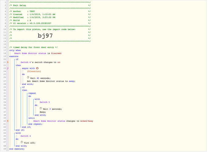

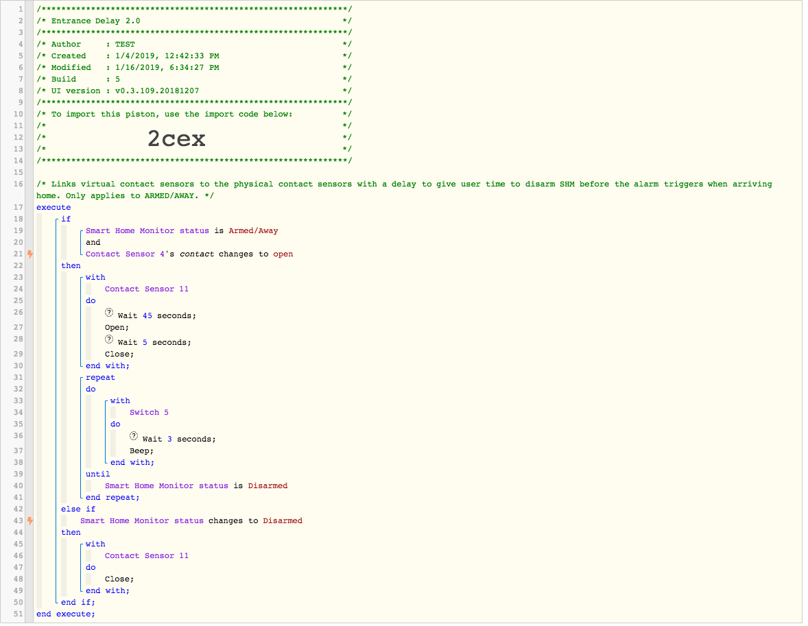

Piezo buzzer not turning on every 3 seconds when Smartthings is armed away and the front door opens.
Piezo buzzer goes off every 3 seconds until Smartthings changes to Disarmed.
Contact Sensor 4: Front Door (real)
Contact Sensor 11: Front Door (vitual)
Switch 5: Piezo Buzzer
