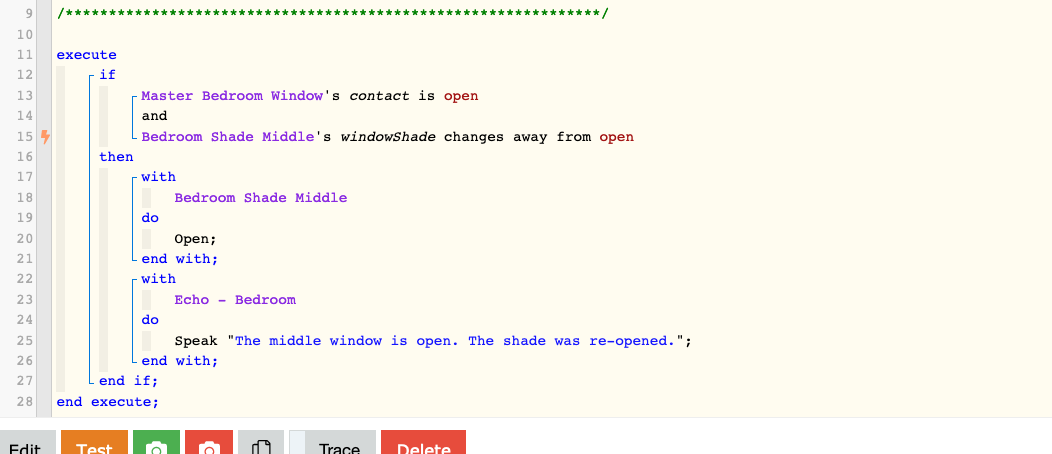

Hi,
I’ve had this piston running for years and for whatever reason, starting today, it doesn’t want to work right. I’ve attached a copy of the piston, as well as the log. Earlier today it was set so that when the shade “closed” and the window was open, it would re-open the shade and then speak. I changed it a bit just now thinking for some reason the logic is no longer working. What am I missing here?

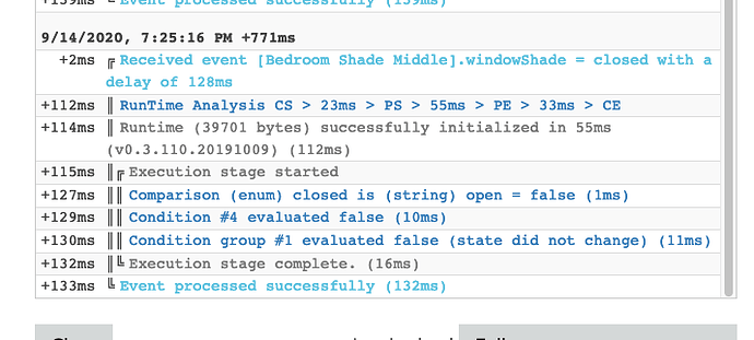

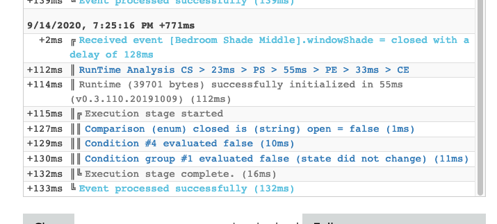

The log shows the Bedroom Window was closed, so no commands were executed…
Just to clarify…
Was the piston above edited (changed) before or after 7:24 PM?
It is crucial that the log and the piston match exactly. I have gotten into the habit of clearing my logs anytime I make any edits. (since the old log cannot be relied upon at that point)
Now it’s working, out of no where. I am also getting a bunch of the voice notifications (built into the piston), so something must have backed up somewhere.
As noted in the post I linked, they re-enabled it temporarily. It’s working for me ATM, too.
