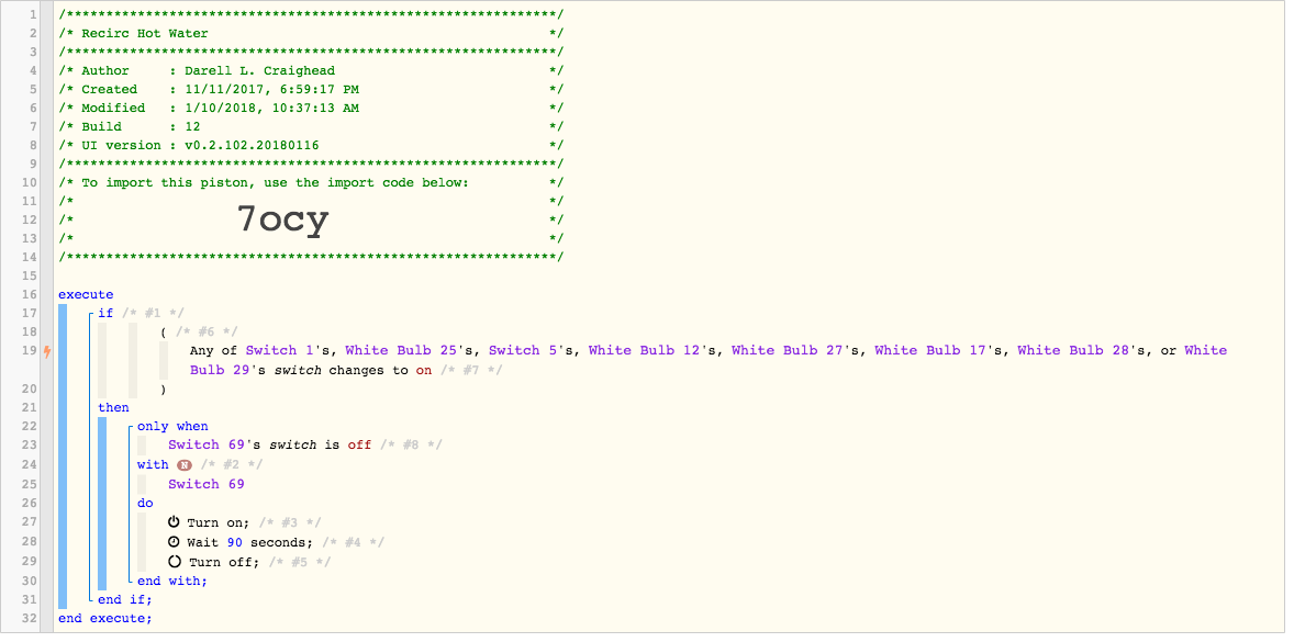

Piston works within 1-2 seconds sometimes - other times could be 5 minutes
If any of the listed switches turns on and a specific switch is off, then turn on a switch for 90 seconds then turn it back off.
Sometimes it works as expected. Other times the trigger is hit but the action does not execute for up to several minutes.
My guess would be multiple triggers backing up full execution of your piston… but without a log, that’s all anybody can do is guess.
Can you turn on full logging and post a sample from delayed execution?
Are all of your switches Zwave/Zigbee, or do you have any WiFi devices (TP-Link, Wemo, iHome) that depend on having the command sent to a cloud server before coming back to the device/hub? If both the any of device triggering the piston and switch 69 are dependent on a cloud service, then I could definitely see several seconds of latency being “normal” (although obviously undesirable).

Just a thought while we wait for it to tell us something in the logs… do you by chance have a piston that turns on a bunch of those lights at the same time? I wonder if the piston is being swamped by switch updates and falling on its face temporarily.
