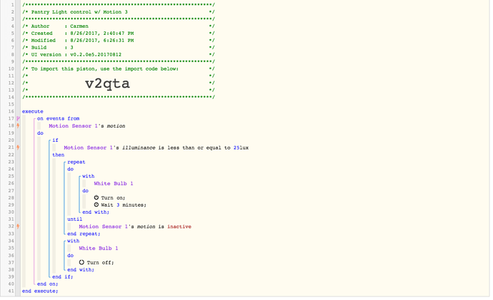

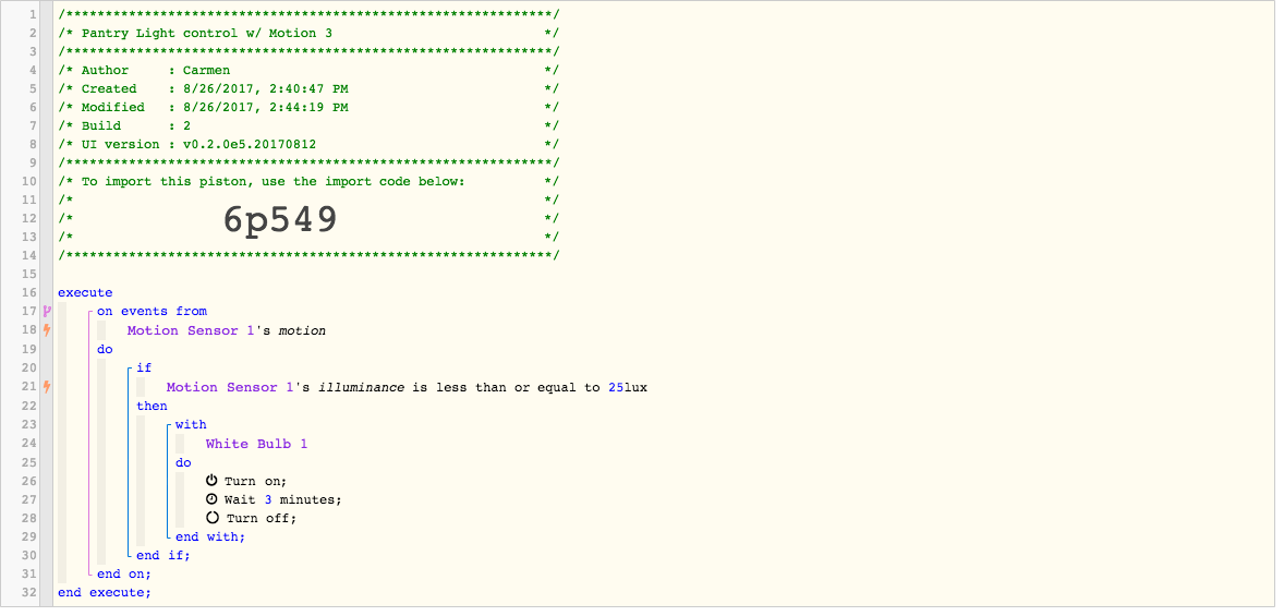

… and to add to this i just noticed now that i am not sleepy. I no longer have my illuminance criteria with “EVENT” so getting the first version to work is def. more inline with what what I am ultimately looking for.
#22
think i got it - need darkness …
#23
Cover the sensor with your hands
#24

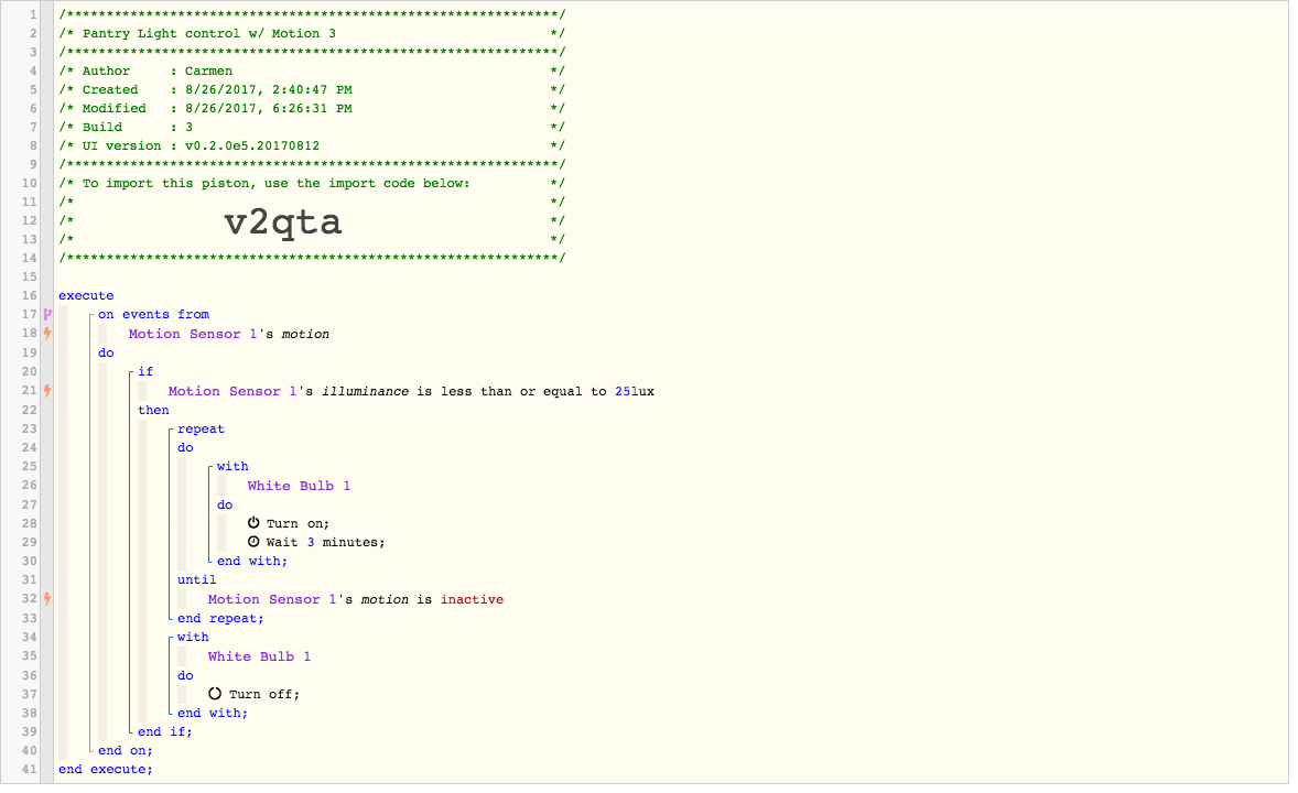

My buddy tested my original logic in his garage and the illuminance would trigger thus not shutting off the light.
He wrote this to get around it and I am going to be testing it tonight in my pantry,
#25
This way it ignores the light sensor after the lights are on.
#26
Boom! Works perfectly.
