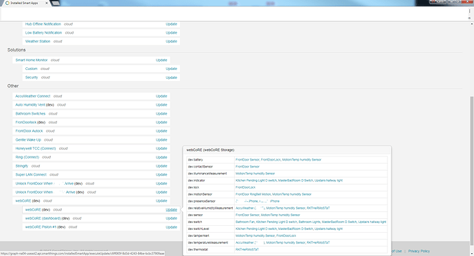

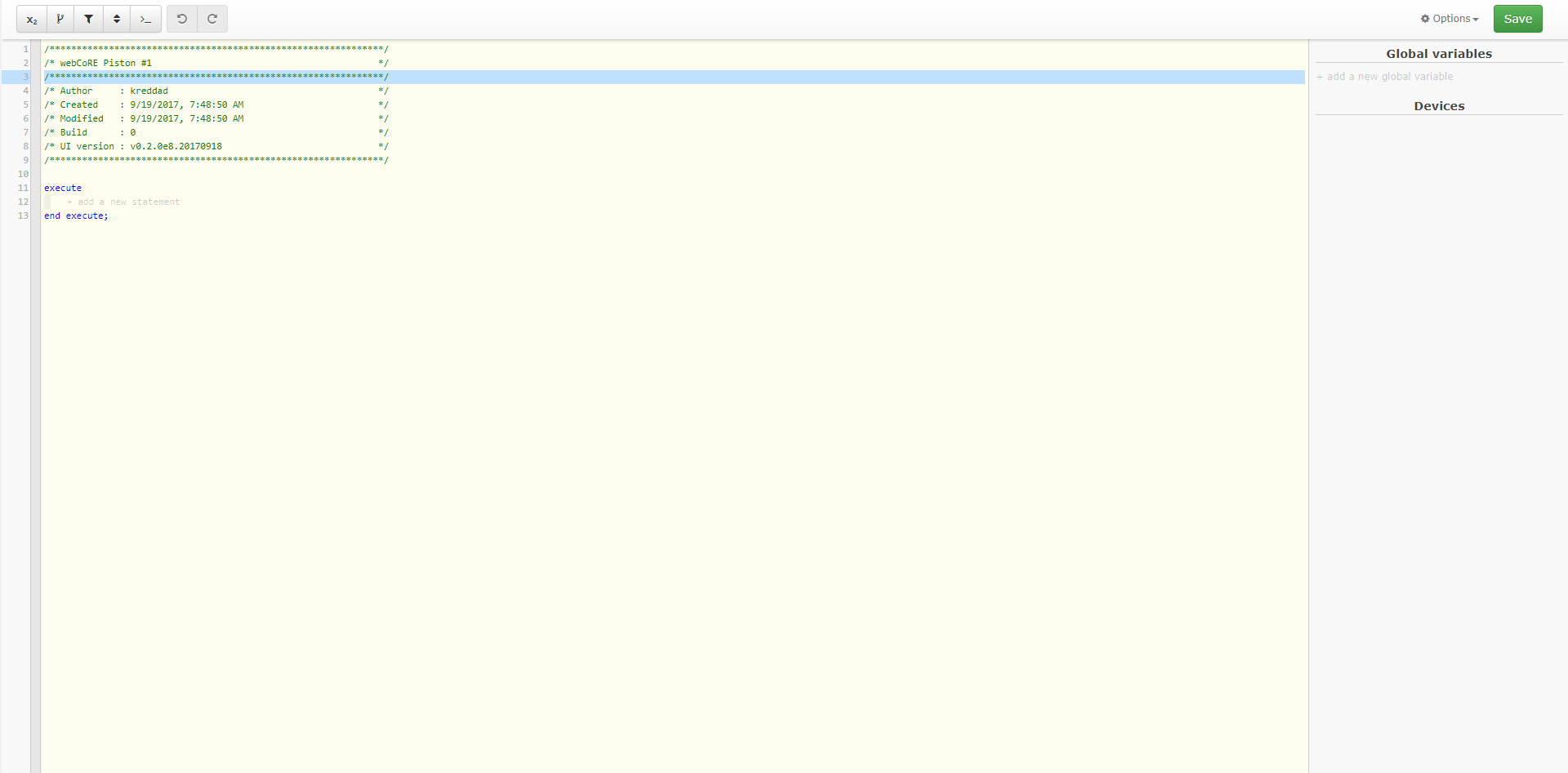

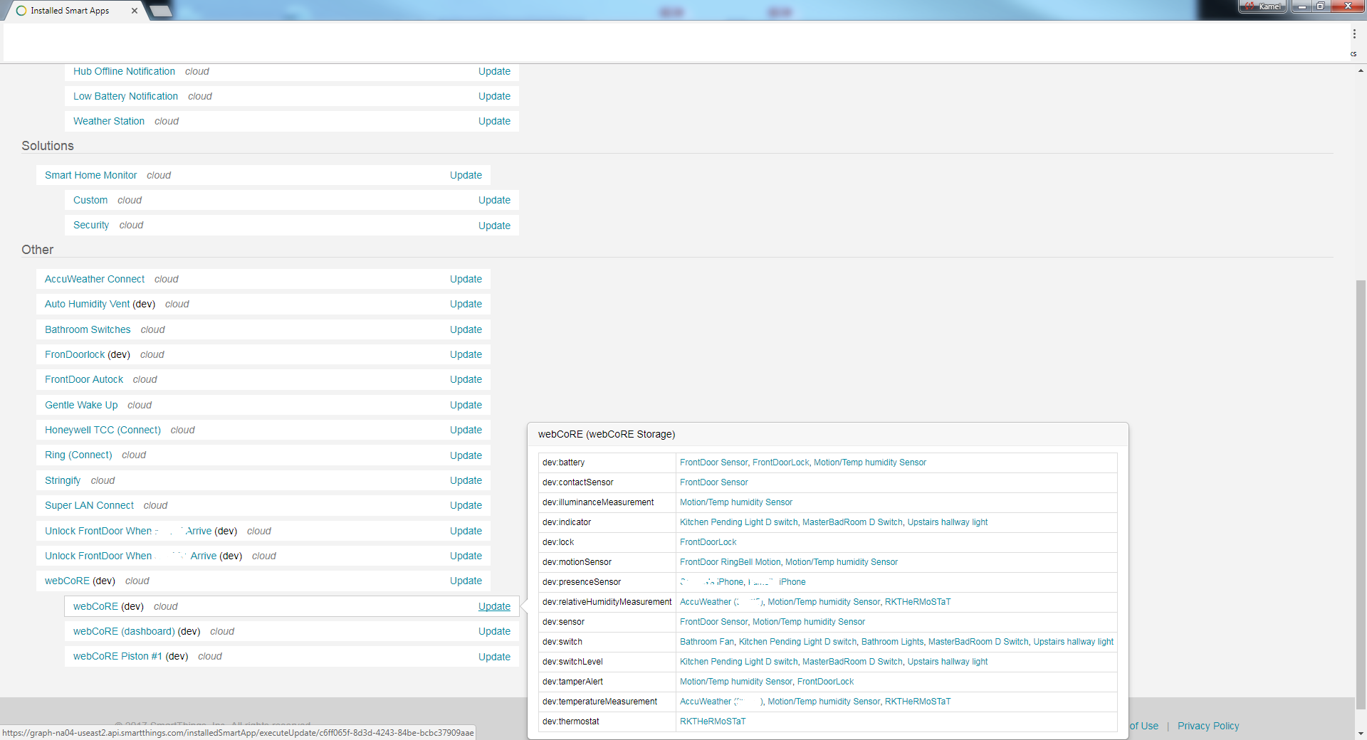

thank you for replying I did all steps, but I still don’t see my devices, pleas see the attachments

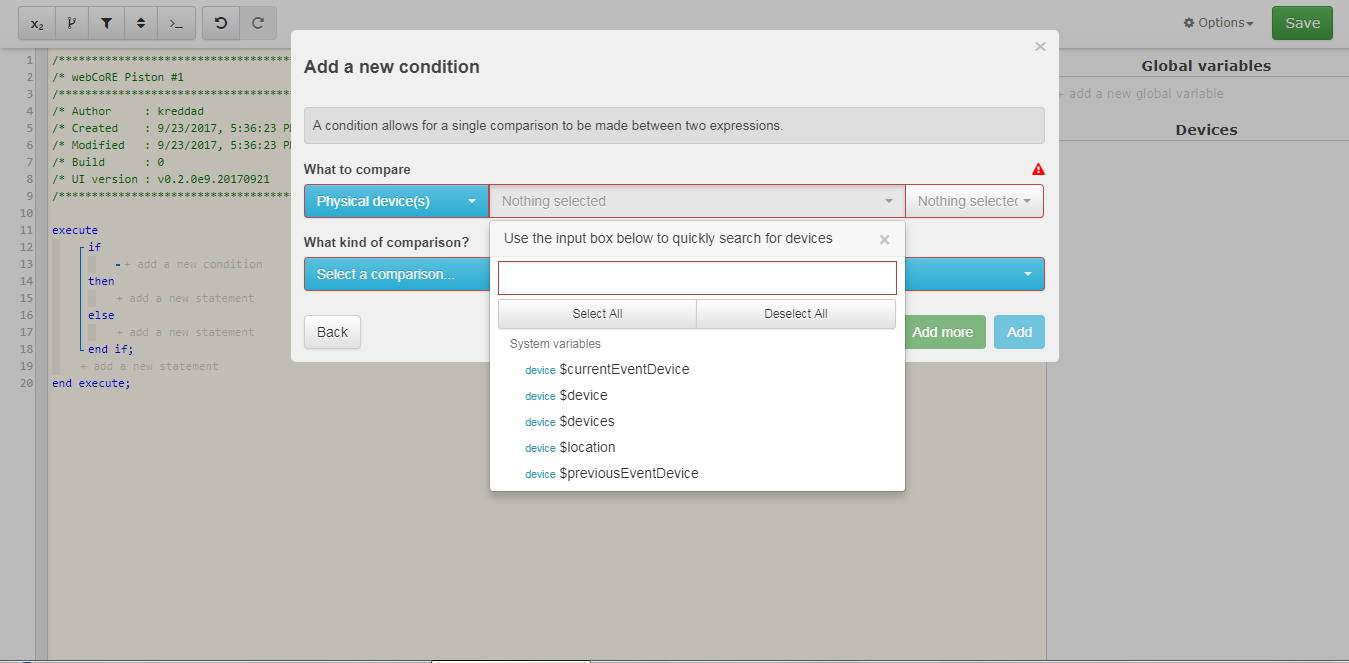

Click add a statement, select condition and then next to physical devices click that drop down.
Thank I did, didn’t work
Can you share a screenshot of the empty list please?

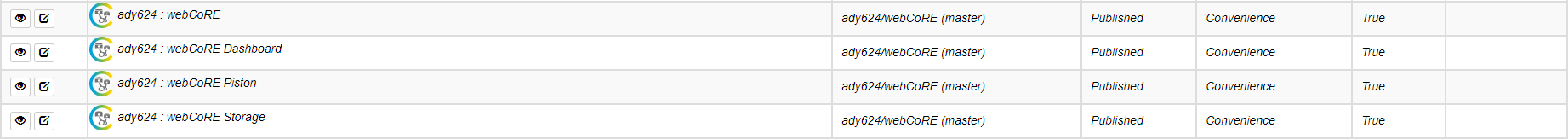

  1. log into the SmartThings IDE From this link
  2. After logging in copy the URL down into a post (if all this does not work)
  3. Click “My Locations” and then click on the Name of your location.
  4. Now go to the My SmartApps page. Is webcore still there?
thank you for your help I did update to latest (v0.2.0ea.20170924) and did work; I can’t wait to start my first piston
