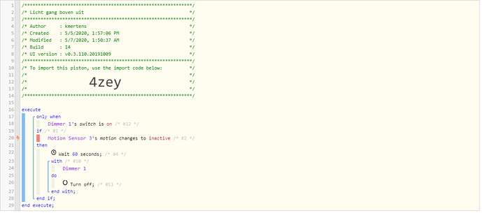

I have a piston which looks at the motion sensor’s activity.
When it goes into inactive it is set to wait 60 seconds to turn off the light that was previously on.
This assures that if there is motion again within these 60 seconds, the piston will stop executing and start again when the motion is inactive so that the light stays on until I am gone.
Maybe the way I am handling this isn’t the best way to accomplish what I want to do?
Turn off the light if below steps are completed:
  • motion changes to inactive
  • wait 60 seconds
Piston stops before 60sec wait ends. Even though there was no new motion.

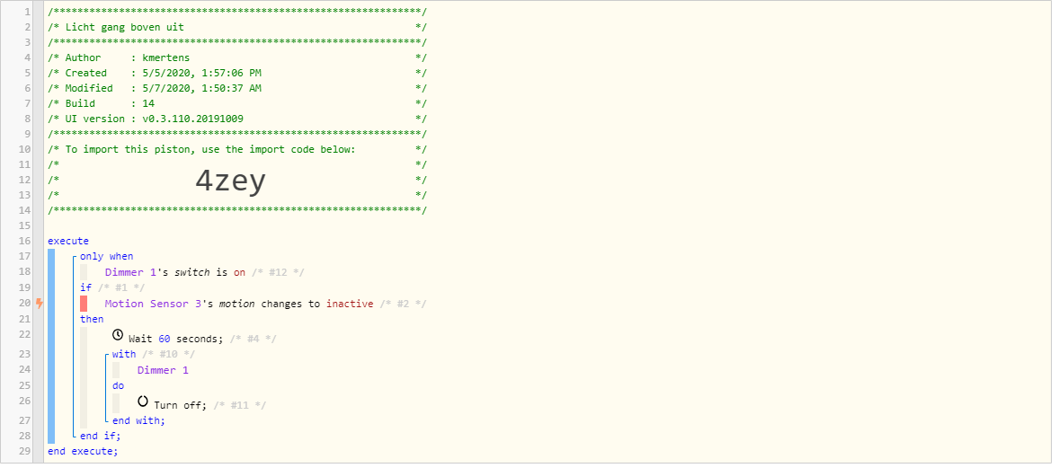

4) Post a Green Snapshot of the piston

Looking at the logs, what is actually happening is ‘changes to inactive’ is evaluating as false for some reason. The piston doesn’t seem to have cached the earlier change to active. There must be something I still don’t understand about how things work.

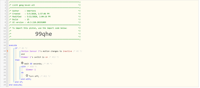

I think that if you subscribe to events you ought to make sure they can be evaluated when they come along, otherwise why create explicit triggers? So personally I’d lose the restriction and have:
if motion sensor changes to inactive
and
dimmer is on
Whether that is just personal taste or there is a technical reason for it, is another question.
Hmm, okay I’ll give that a try.
You mean like this then?
Yeah that is what he was saying, although, and it’s a personal preference of mine and I don’t think it matters in this case…
I like to have my trigger by itself. The trigger is what starts things off, I then set up my conditions. I would put the SWITCH is ON below the THEN with another IF and leave the trigger by itself.
Yes that is what I meant. I couldn’t really see anything wrong with your original piston but as it clearly didn’t work I took that to mean my understanding is incomplete.
What I do know is that when you do a ‘changes to inactive’, the piston compares the ‘new’ value carried in the event data with a cached ‘old’ value. However I’ve never figured out exactly when the ‘old’ value gets updated. So I was wondering if the previous instance of the piston (where motion has just changed to active) never evaluating the trigger was the problem.
Actually, the problem with your piston is that after the 60 second wait, the ‘changes to inactive’ is no longer true. It just IS inactive. I suggest moving the wait in with the turn off and set that with to ‘Never cancel tasks’. Then you should be good to go.

The truth of ‘changes to inactive’ is only determined when the comparison is evaluated. After the 60 second wait the piston wakes up, starts at the top and immediately fast forwards past the wait and so doesn’t evaluate the condition again.
The problem shown in the logs is that the piston receives the motion active event followed a little while later by the inactive event. However when the piston evaluates ‘changes to inactive’ it is returning false so it never gets to the ‘then’ block to even start the wait. For some reason it hasn’t recorded that the previous event was ‘active’ and so doesn’t think the value has changed.
