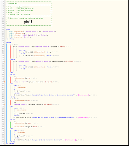

I’m wondering if this is the most efficient way of writing this piston. I have it shown below. Can you all take a look and let me know if there is a better technique or an gotchas that I’m not seeing.
I’m new to webCoRE but not new to logic. I’m used to Windows PowerShell so some stuff translates. I’ll post more looking for other general help but I’ll keep this one to this specific piston.
Using two presence sensors, turn off one of two groups of lights depending on if someone leaves or both people leave.
  • No need to take action if everyone is home
  • If Andrew leaves but Rachel is present: turn off entry light and send SMS that “Andrew left but Rachel is still home. turned off entry lights”
  • If Rachel leaves but Andrew is present: turn off entry light and send SMS that “Rachel left but Andrew is still home. turned off entry lights”
  • if Andrew and Rachel leave: turn off switch entry, driveway, christmas tree and send SMS that “Everyone left and {noOneHome} turned off.”
This piston does work I’m wondering if there is a better way.
Logs from webCoRE and not IDE. I turned the three lights on and presence on both sensors was present
  1. I set Andrew to not present and entry light went off and SMS was sent.
    1a. I set Andrew to present and turned entry light on.
  2. I set Rachel to not present and entry light went off and SMS was sent.
    3 I set Andrew to not present (Rachel remained not present) and Entry, Driveway and Christmas Tree lights went off and SMS was sent.

What about something like this
If any of ps1 or ps2 change to not present
if all of ps1 and ps2 are not present
Turn off all lights
Else
Turn off entry lights
Send message $currentEventDevice has left…
End if
End If
