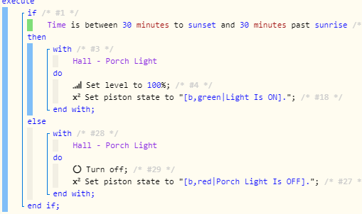

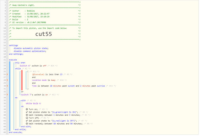

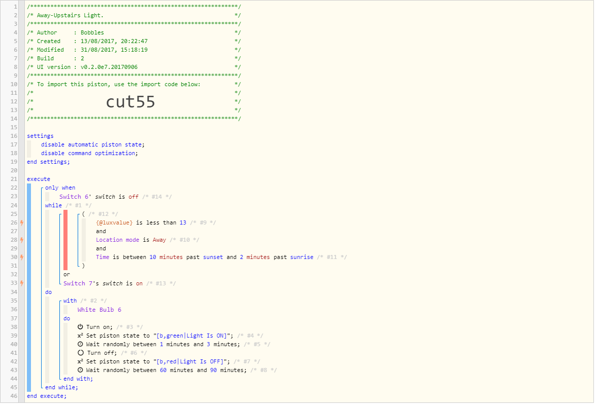

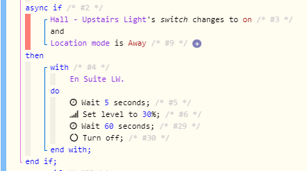

Here is a snippet from one that I have that has my En Suite Light turn on when my upstairs hall light turns on when we are away. (If that makes sense). :slight_smile:
TCP should be ‘never’ BTW. Missed that.
This turns my porch light on and off between certain times.
Just amend the times accordingly. Maybe sunset to 22:00.
What I would do would be to change the wait to wait randomly. You can then put in-
Wait Randomly between 5 and 30 minutes. This way it doesn’t look like the lights are going off at exactly the same time every evening.
This turns on and off my upstairs hall light when we are away at random times and for a random interval.
Ignore the ‘only when’ switch 6 and switch 7. These allow me to test or turn off my away mode lights.

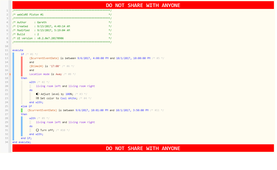

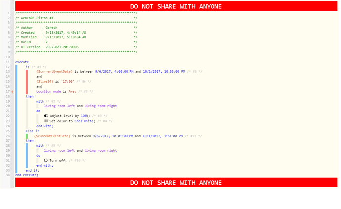

Think I might be getting somewhere, do you think this might work, I could join a few together regarding other light groups
well, that didn’t work

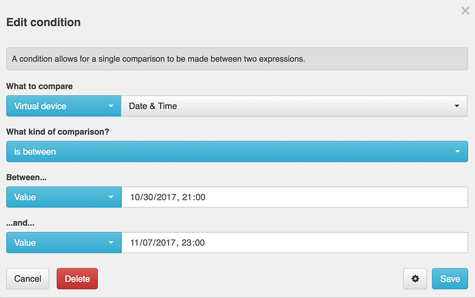

cant use $currentEventDate. instead use this if condition and change to your date and times:
