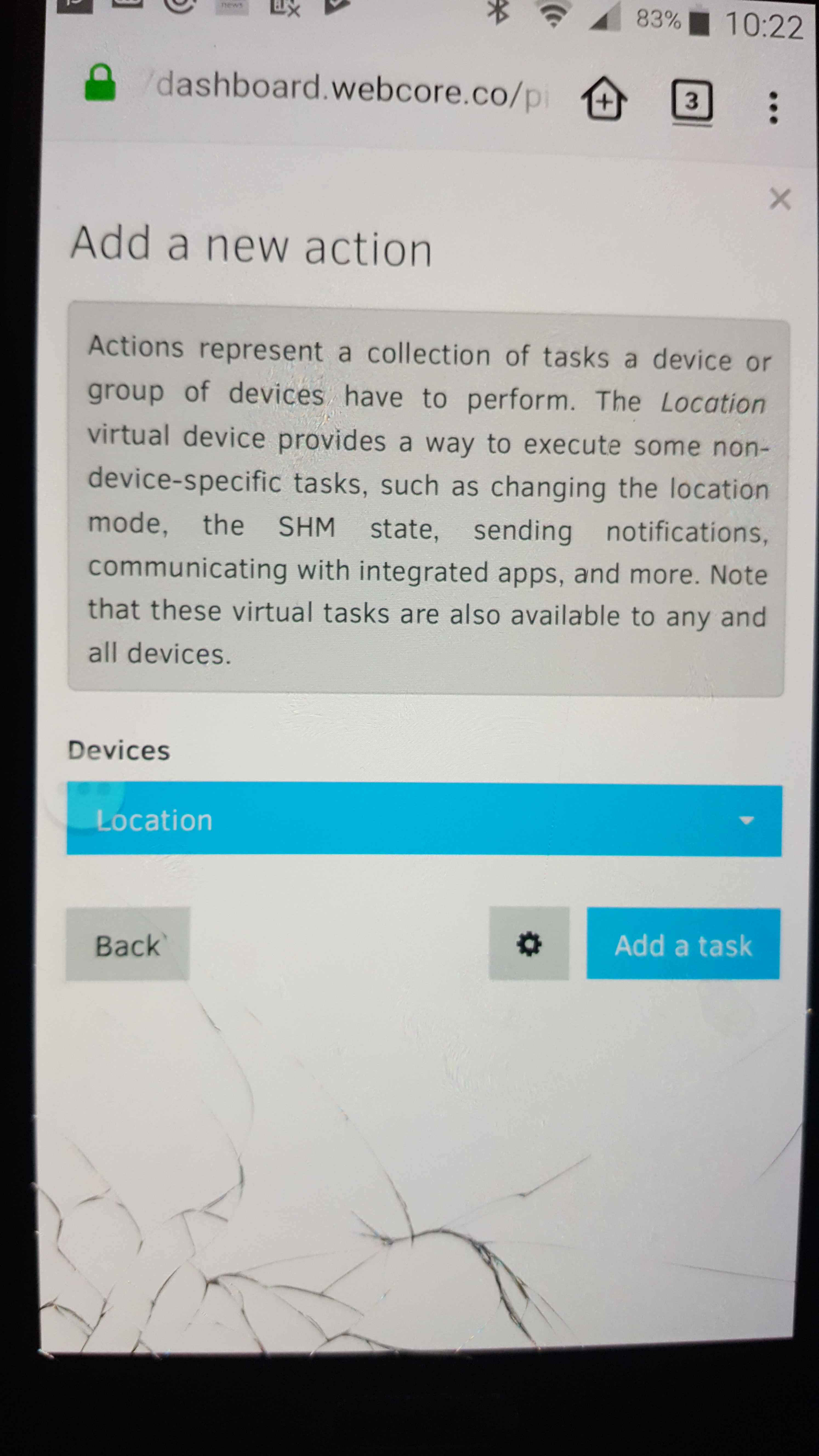

But when I start the simplest piston, choose an action, the only device available is “Location.” None of my webcore-recognized devices appear.
There should be a list of available devices
There are no devices, only “Location”.

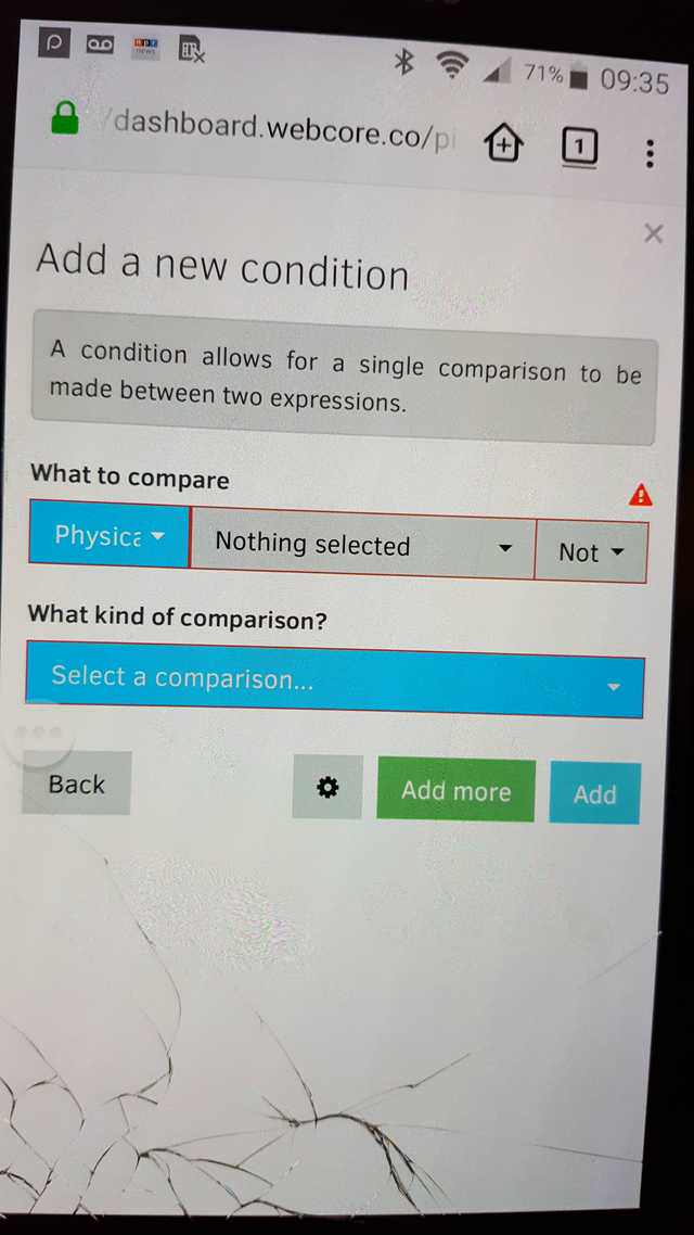

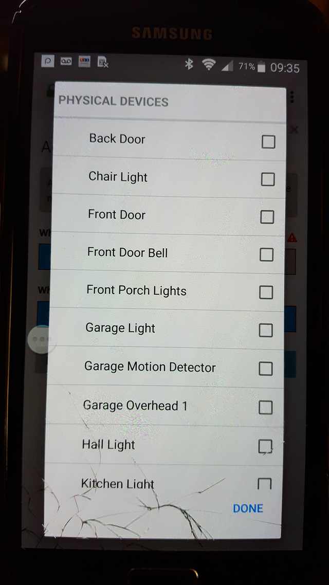

Yes I can see the devices when building a condition.
“Add a Condition”:
List of devices popup:

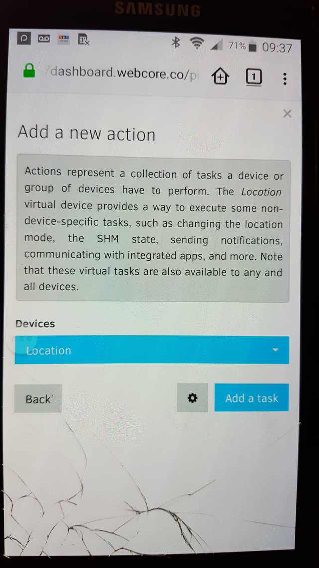

“Add a new action”
(Nothing pops up if i press “location.”)

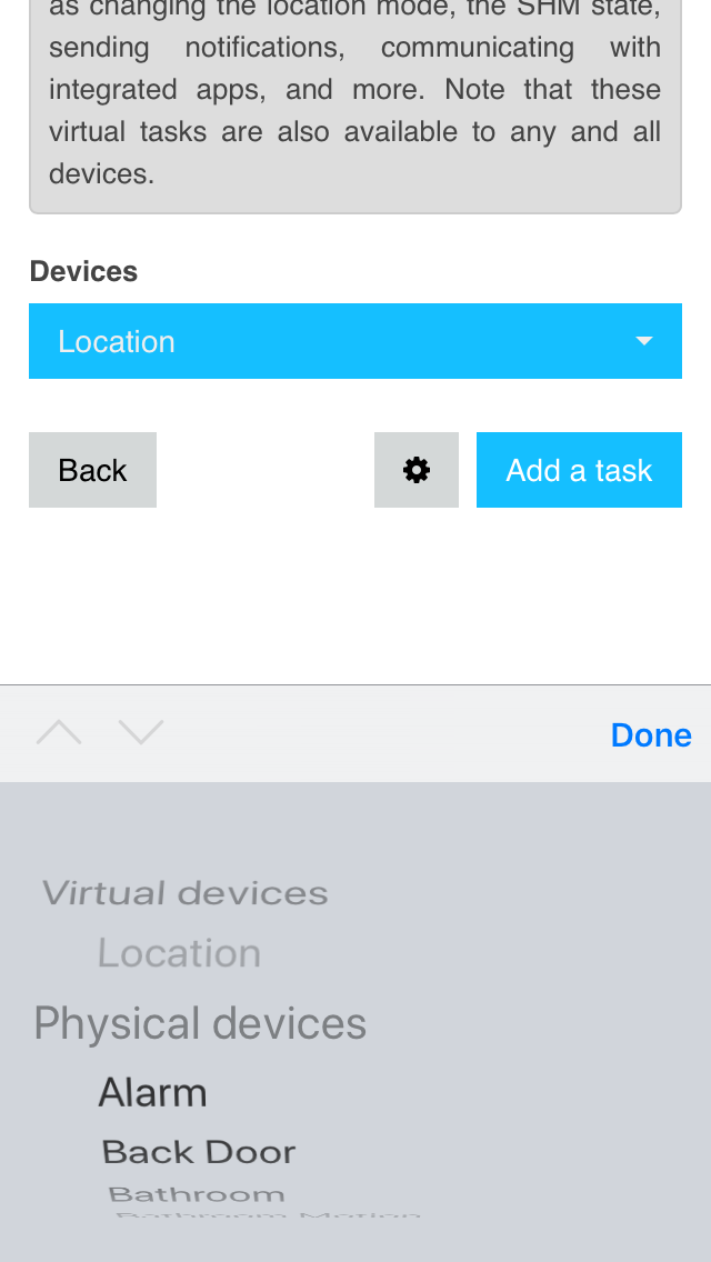

So, your problem isn’t that the devices aren’t connected to webCoRE properly… it’s that clicking the blue location bar doesn’t display the dropdown / selection list like it should.
This is what should happen on mobile:

I wonder if it’s related to the sensitivity of your smashed screen… can you try tapping other parts of the blue bar, from left to right.
#20
I’ll try that when I have time but the screen works for everything else and it doesn’t matter if
WHOA I just tried it (portrait/landscape no diff) but in the pause waiting for screen to rotate, a DEVICE LIST pops up!
Now I can select a device!
If there’s another problem I’ll know who to blame and I’ll come hunting you down.
Thanks, really.
#21
It’s intermittent. I don’t have time to work with it now but the dev list is very very slow to appear. More later.
