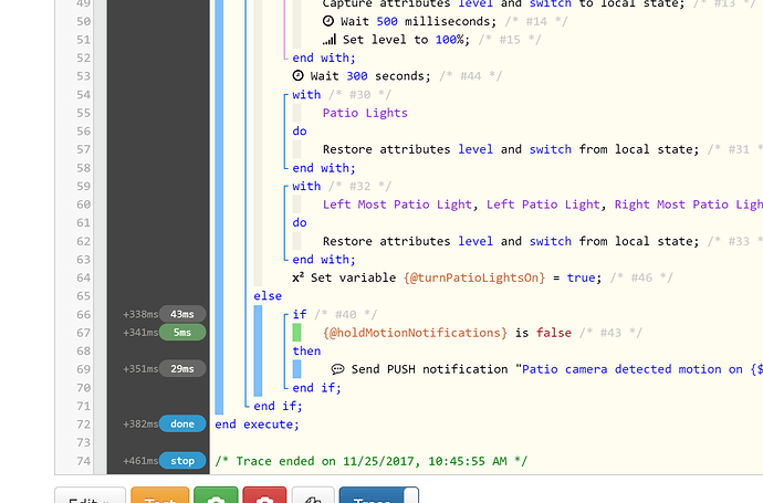

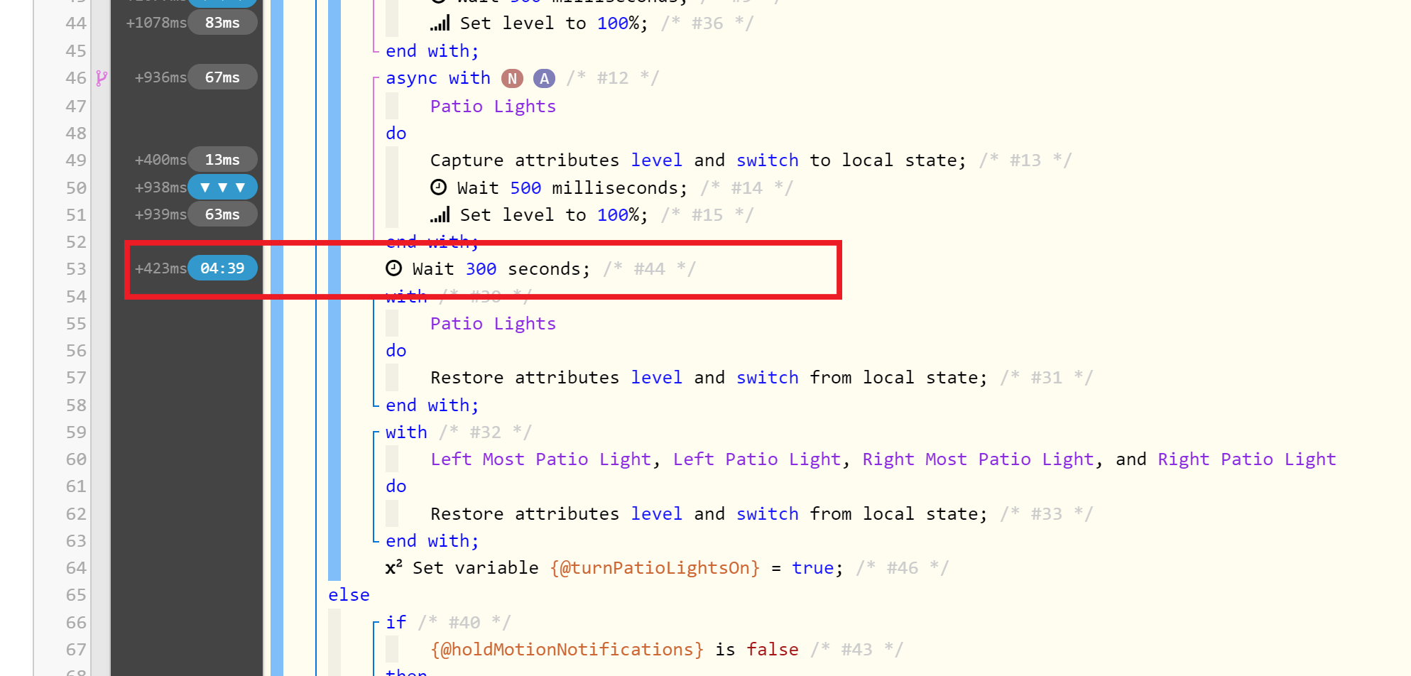

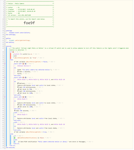

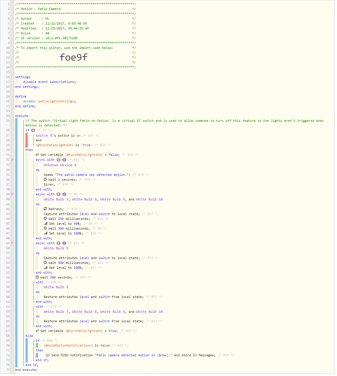

When one of my camera detects motion, Blue Iris sends a command to fire the piston shown below. What should happen is the piston fires, the lights turn on and the siren sounds, the 5 minute countdown begins, and then the lights turn off after 5 minutes. I temporarily set the variable turnPatioLightsOn to false because Blue Iris was detecting motion when the lights were turned off after 5 minutes and it was firing the piston again. This resulted in an endless loop of On -> Off –> On again. So the variable gets set to false and then I set it to true again once the lights have gone off.

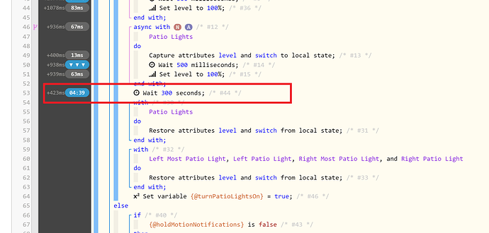

If works fine unless Blue Iris detects motion during the countdown and sends the command to fire the piston. In the first screenshot below you can see the wait counting down. If I step in front of the camera during the countdown, Blue Iris sends the command to fire the piston. But instead of ignoring the command based on the first if statement, the countdown seems to be canceled and the piston finishes without executing any additional commands.
Wait has been executed and I can see it counting down in the trace:

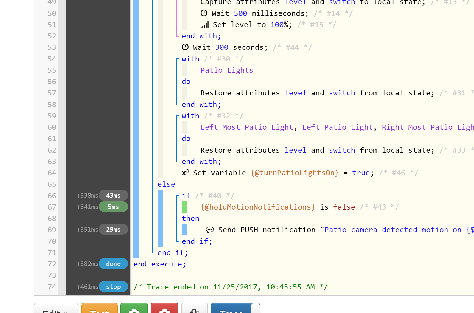

Camera detects motion during the wait, command is sent to fire the piston. Instead of evaluating the first if statement and determining nothing should be done, the immediately piston ends:
If motion is detected during the 5-minute countdown, the piston would be triggered but do nothing because the first if statement should evaluate to false based on the fact turnPatioLightsOn is false.
If the piston is re-triggered during the countdown, it should ignore everything and just continue counting down. Instead the piston says “my work is done here” and stops.
