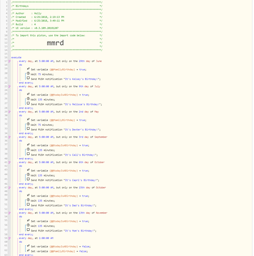

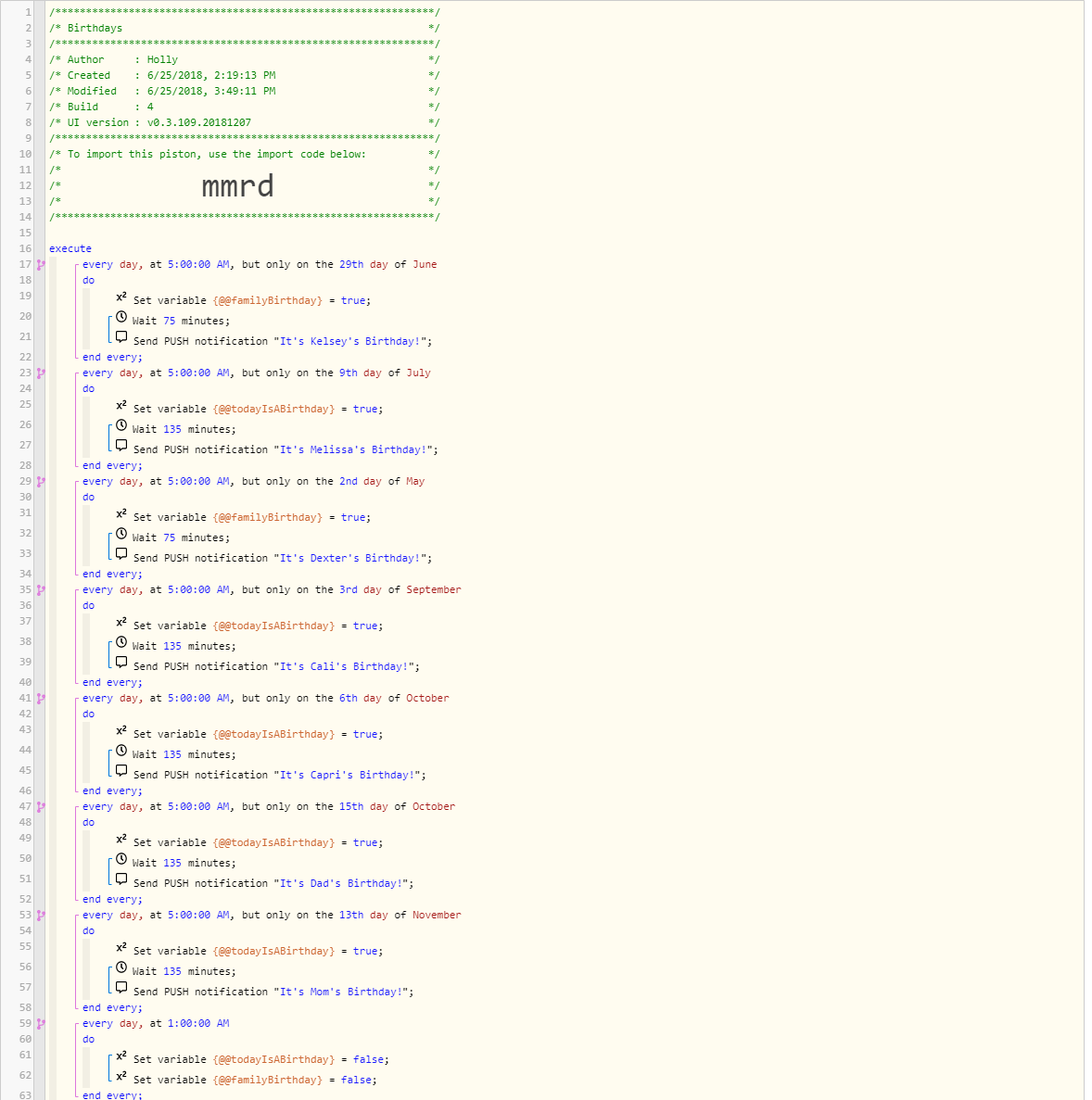

I have a birthday reminder piston that worked really well last year. Now it appears to be confused about the date, it is setting a variable to true on days it shouldn’t.
Example: On June 25th only, set @@familybirthday variable to true. I check the variable in other pistons.
It set my @@familybirthday variable to true today, 1/15. It has also set another birthday variable to true several times this year already when it shouldn’t. I see it setting the variable in the logs, I just don’t understand why…

Your piston sure looks right. Seems like a glitch in the system. Are you getting the Kelsey message or the Dexter message or is it inconsistent?
I suspect this is because you have 7 identical triggers in the same piston.
(all firing at the same instant)
If it were me, I would code the same way, but use different times for each, and drop the waits entirely.
For example, change this:
Every day at 5AM on the 29th of June
do
    Set variable
    Wait 75 minutes
    Send PUSH
End every
to this:
Every day at 6:15AM on the 29th of June
do
    Set variable
    Send PUSH
End every
Today I got the Kelsey message. I also got the Melissa message and the Capri message earlier this month already. It’s odd to me that it worked pretty flawlessly in 2018 but in 2019 it’s a little schizophrenic. Not sure what to try to fix it besides maybe re-creating the piston altogether…
The familyBirthday variable is particularly problematic because I use it to play a loud semi-startling “Happy Birthday” recording on first motion in the morning when set to true :smiley:
Thanks for the idea, I’ll try that.
