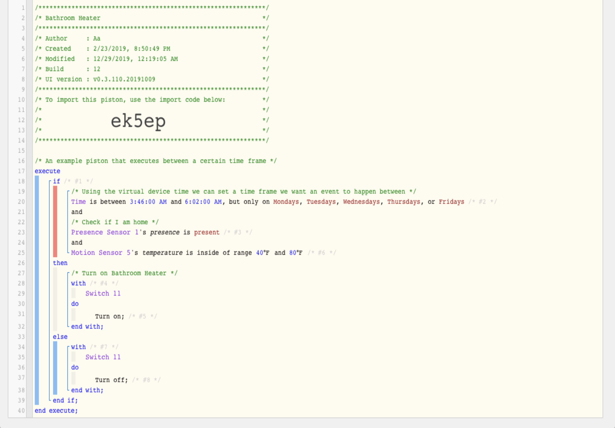

If I manually turn on the switch outside the times, the piston executes and turns it off as the time is not as defined and neither if the temperature. I do not want the piston to execute outside of the defined time.
I would like this piston to only fire during the defined times, how can I adjust the code to do so? Thanks

Ideally, a piston should have a single trigger, then as many conditions as you like beneath it.

Getting rid of the ELSE block entirely will help greatly, since no action will ever be taken unless the time condition is true.
Keeping the ELSE block means that if any of the 3 conditions are false, then the ELSE block executes.

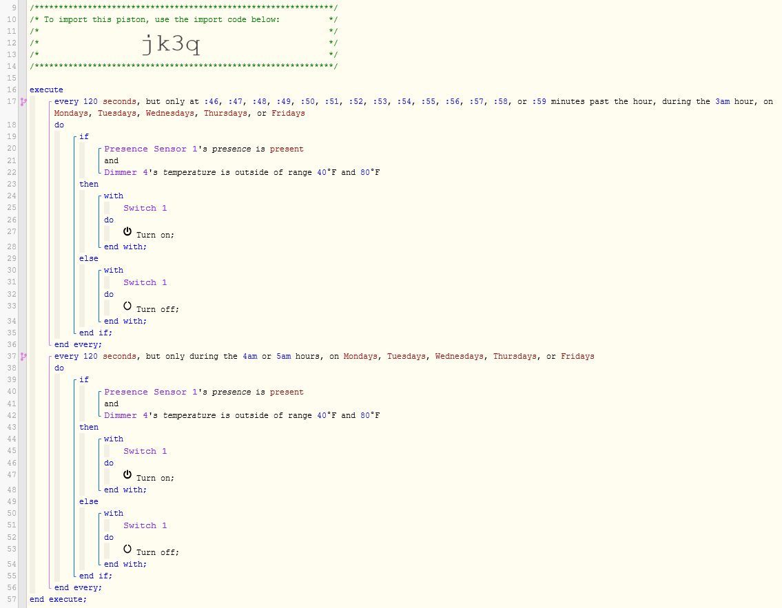

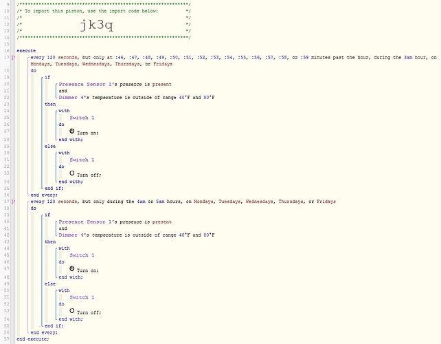

This statement contradicts your original post, but here is an untested piston that may do what you want:
Note: It stops working two minutes earlier than your original post. (at 6am)
Also, if this were my piston, I would add a tiny block to the very bottom as a safety net:
Every day at 6:03am, Turn off Heater
This makes sure that your heater is not left running all day while you are at work.
Edit:
I added your daily restrictions to the above piston.

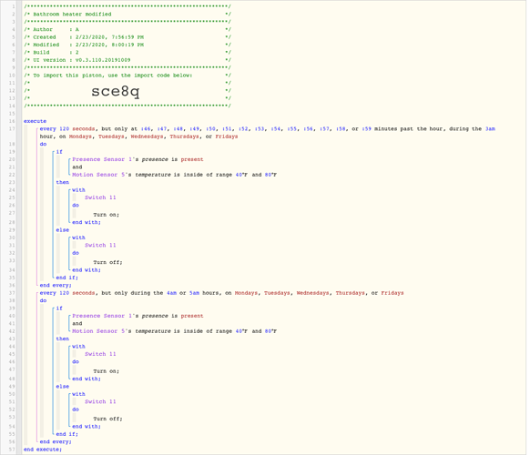

Can you please post your latest green snapshot here?
Upon re-reading your original post & piston, (with a clear head), I think I would just get rid of the ELSE block in “ek5ep”, and convert that last block into a separate IF block at the very bottom:
IF "something" happens, Then turn off heater
Worked perfectly
Piston “sce8q” looks good, but I am a bit confused as to why you want the condition to be “inside of range 40 and 80”.
