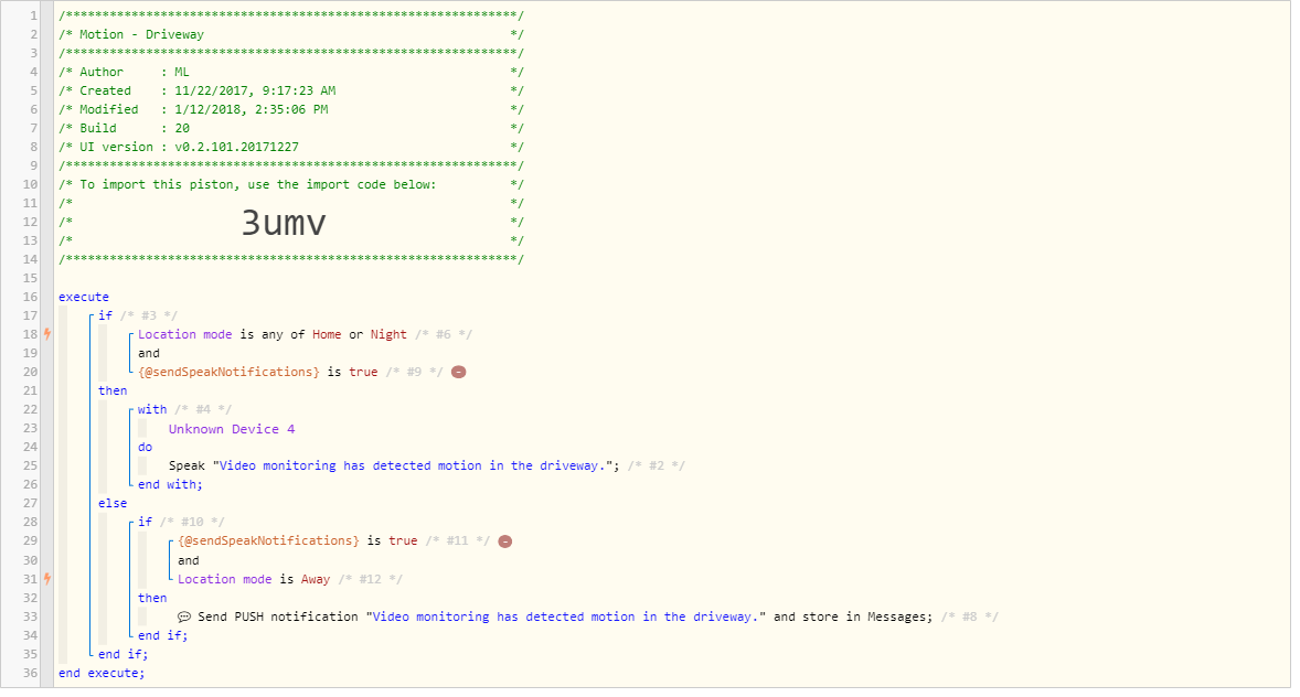

I want to suppress notifications in certain situations so I created a global variable that I can set to true or false. When I get ready to leave the house, the variable gets set to false, a 2-minute wait occurs, and then it gets set to true. I then use the variable’s true or false state to determine if push or speech notifications should be generated. This is intended to temporarily stop the barrage of notifications I get when I leave the house (“motion in the garage”, “garage door has been opened”, “motion in the driveway”, etc.).
It sort of works but sort of doesn’t. I don’t get the notifications when the events are detected but I get them all when the global variable changes back to true two minutes after being set to false. The variable in question is @sendSpeakNotifications. Blue Iris fires the piston shown in the screenshot when one of my camera detects motion. The same thing is happening with other pistons that fire when a camera detects motion.

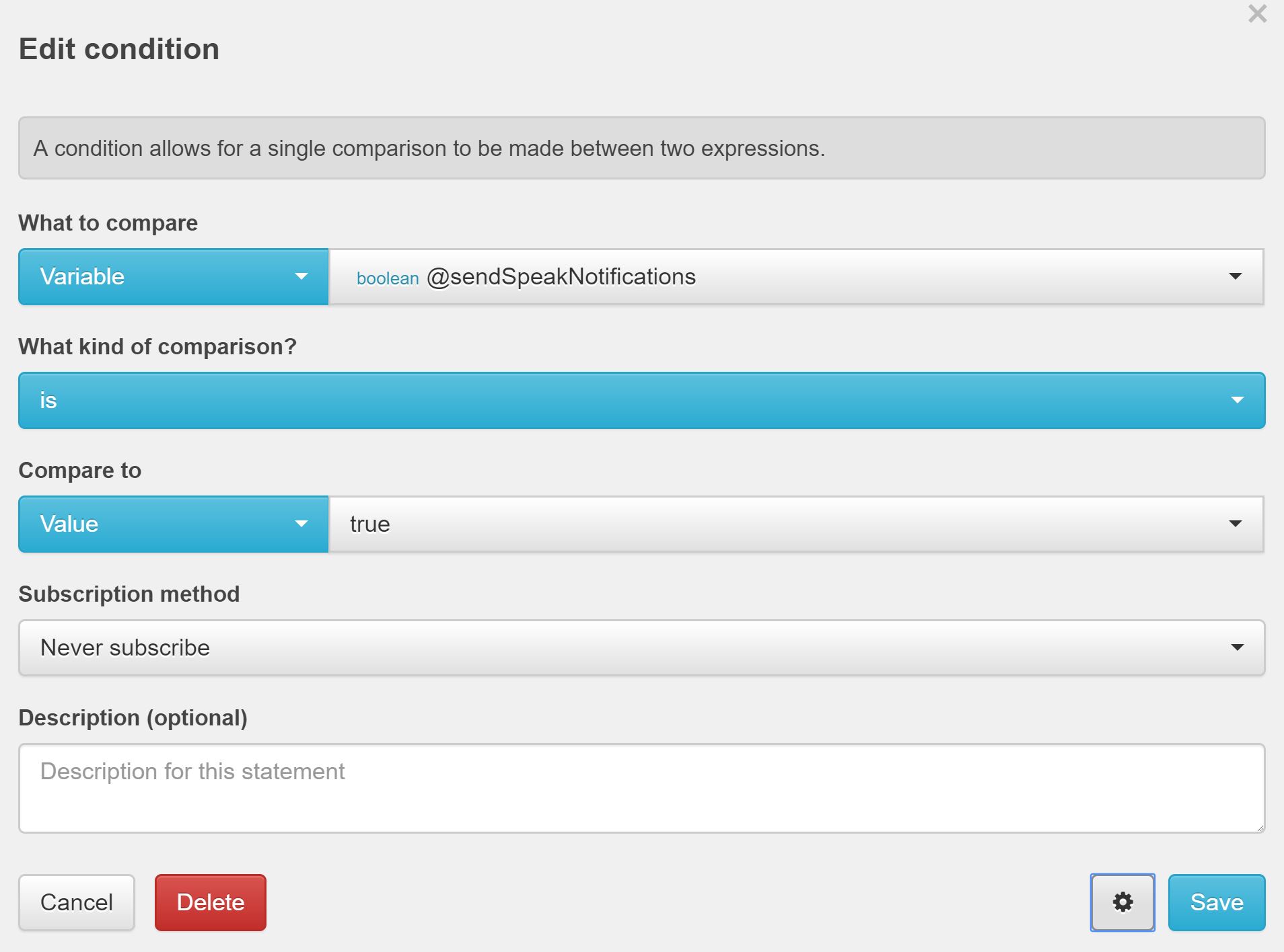

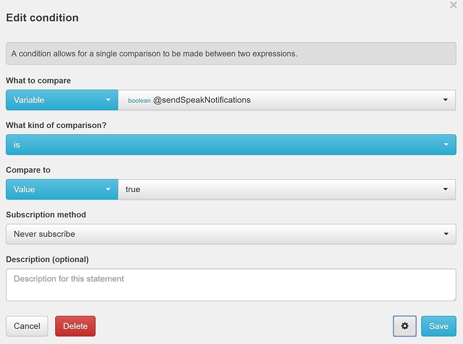

I’d appreciate any help in figuring out why the piston fires when the global variable changes to true, causing the notifications to be generated. The piston should run but because @sendSpeakNotifications is false, just ignore the send push or speak commands. I’ve included a screenshot of the variable’s settings.

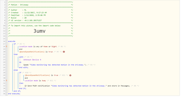

Because the @sendSpeakNotifications is false the piston should run but skip the lines that generate notifications.
As soon as the @sendspeakNotifications variable changes to true, the notifications get sent.

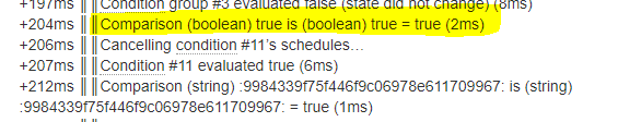

Received event [Home].mode = Away with a delay of 152ms
+180ms ║RunTime Analysis CS > 32ms > PS > 71ms > PE > 76ms > CE
+182ms ║Runtime (40426 bytes) successfully initialized in 71ms (v0.2.100.20171211) (181ms)
+183ms ║╔Execution stage started
+194ms ║║Comparison (string) :9984339f75f446f9c06978e611709967: is_any_of (string) :fd6b2fd9366cdca291a786245b40fcf7:,:4f87089617dfb9cee9d4ec80da10baf8: = false (3ms)
+196ms ║║Cancelling condition #6’s schedules…
+196ms ║║Condition #6 evaluated false (7ms)
+197ms ║║Condition group #3 evaluated false (state did not change) (8ms)
+204ms ║║Comparison (boolean) true is (boolean) true = true (2ms)
+206ms ║║Cancelling condition #11’s schedules…
+207ms ║║Condition #11 evaluated true (6ms)
+212ms ║║Comparison (string) :9984339f75f446f9c06978e611709967: is (string) :9984339f75f446f9c06978e611709967: = true (1ms)
+213ms ║║Condition #12 evaluated true (5ms)
+214ms ║║Cancelling condition #10’s schedules…
+215ms ║║Condition group #10 evaluated true (state changed) (15ms)
+218ms ║║Cancelling statement #7’s schedules…
+238ms ║║Executed virtual command sendPushNotification (16ms)
+241ms ║╚Execution stage complete. (58ms)
+243ms ╚Event processed successfully (242ms)
