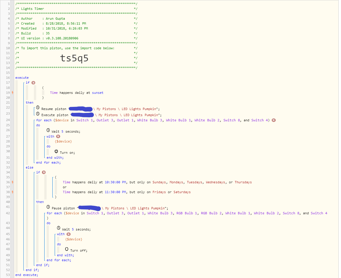

I have created a piston to turn on some lights around the house at sunset and turn them off at 10:30 PM. It was working fine for last several months. About three days ago, the piston stopped working. I turned on debug logging to full but there is nothing in today’s log at sunset time (around 6:07 PM). Yesterday, there was something:
10/30/2018, 6:11:14 PM +252ms
+1ms ╔Received event [MyHub].time/recovery = 1540937474250 with a delay of 1ms
+491ms ║RunTime Analysis CS > 199ms > PS > 234ms > PE > 58ms > CE
+493ms ║Runtime (40925 bytes) successfully initialized in 234ms (v0.3.108.20180906) (491ms)
+495ms ║╔Execution stage started
+497ms ║╚Execution stage complete. (3ms)
+500ms ║Setting up scheduled job for Tue, Oct 30 2018 @ 10:30:00 PM EDT (in 15525.249s), with 2 more jobs pending
+513ms ╚Event processed successfully (514ms)
10/30/2018, 6:10:15 PM +778ms
+1ms ╔Received event [MyHub].execute = recovery with a delay of 75ms
+147ms ║RunTime Analysis CS > 26ms > PS > 71ms > PE > 49ms > CE
+149ms ║Runtime (40912 bytes) successfully initialized in 71ms (v0.3.108.20180906) (147ms)
+151ms ║╔Execution stage started
+195ms ║║Comparison (time) 65415937 happens_daily_at (time) 1540937280000 = false (1ms)
+197ms ║║Condition #3 evaluated false (38ms)
+199ms ║║Cancelling statement #3’s schedules…
+207ms ║║Requesting time schedule wake up at Wed, Oct 31 2018 @ 6:08:00 PM EDT
+210ms ║║Condition group #2 evaluated false (state did not change) (52ms)
+212ms ║║Condition group #1 evaluated false (state did not change) (54ms)
+220ms ║║Comparison (time) 65415994 happens_daily_at (time) 81000000 = false (1ms)
+222ms ║║Condition #14 evaluated false (6ms)
+224ms ║║Cancelling statement #14’s schedules…
+229ms ║║Requesting time schedule wake up at Tue, Oct 30 2018 @ 10:30:00 PM EDT
+236ms ║║Comparison (time) 65416011 happens_daily_at (time) 84600000 = false (1ms)
+238ms ║║Condition #15 evaluated false (6ms)
+240ms ║║Cancelling statement #15’s schedules…
+245ms ║║Requesting time schedule wake up at Tue, Oct 30 2018 @ 11:30:00 PM EDT
+249ms ║║Condition group #13 evaluated false (state did not change) (33ms)
+250ms ║║Condition group #8 evaluated false (state did not change) (36ms)
+257ms ║╚Execution stage complete. (106ms)
+259ms ║Setting up scheduled job for Tue, Oct 30 2018 @ 10:30:00 PM EDT (in 15583.964s), with 2 more jobs pending
+270ms ╚Event processed successfully (270ms)
Any help will be appreciated.
Thanks,
Arun
