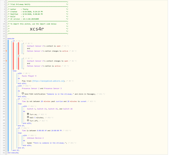

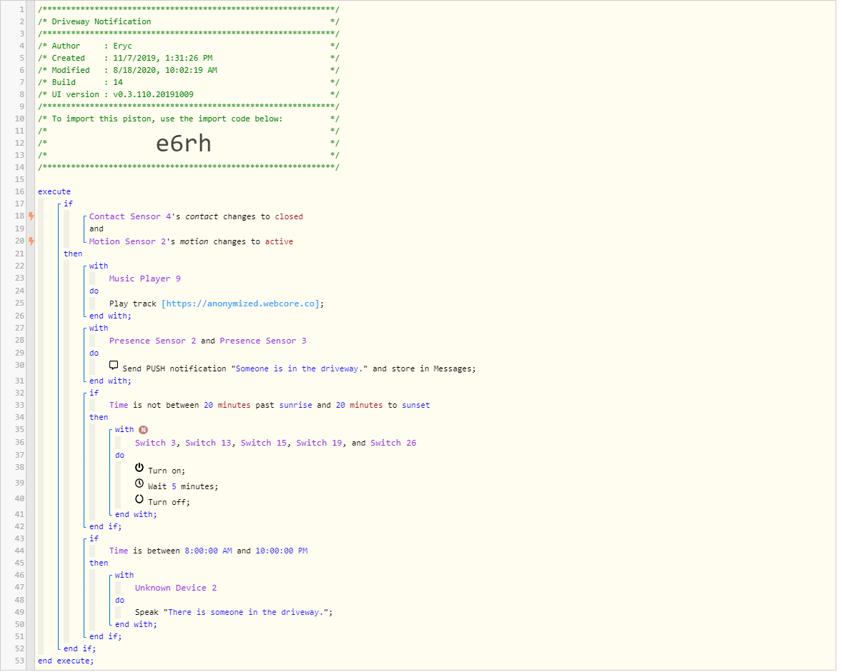

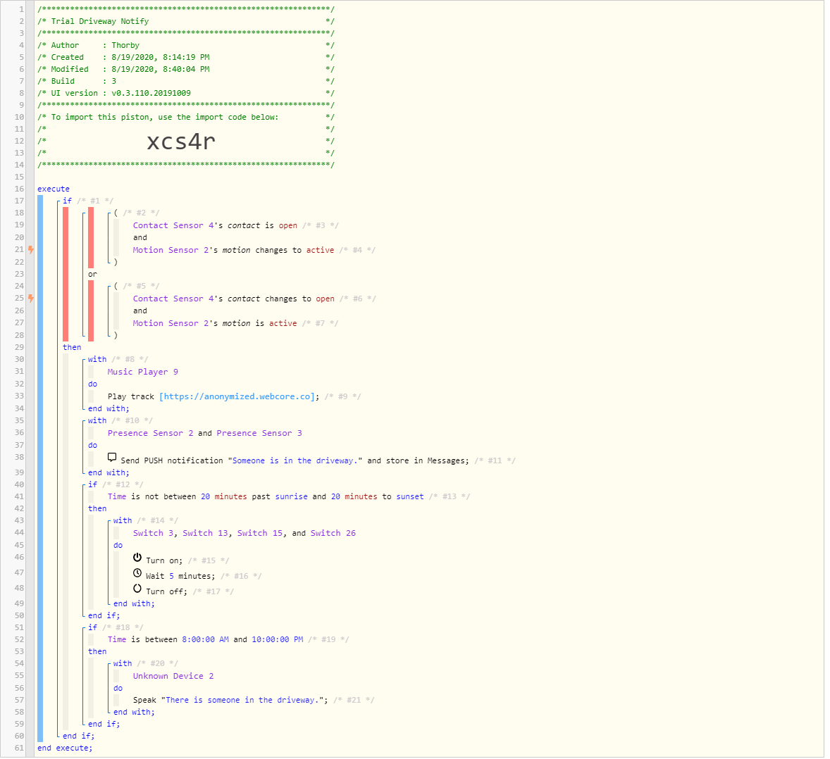

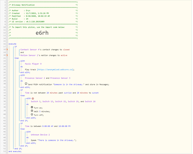

Piston help (was review) please
WAS: False positives from a motion detector, so I added a second, 10’ away.
NOW: Nothing happens.
When someone enters the driveway and BOTH motion detectors… Detect, then I get a "driveway motion notification.
WAS: Nothing yet - I want a review! :slight_smile: If just one or the other motion detector detects, then I do not want anything to happen - only if BOTH detect motion.
NOW: Need help with the triggering as Paul1964 below commented.
NOTE! The Contact Sensor 4 is wired to an outdoor motion sensor receiver. It’s normally open and closes on motion, sending that to the zwave contact sensor sitting on it. Motion sensor 2 is the second motion sensor.
** SECOND NOTE** Looks like motion sensor 2 triggers on big trucks driving past the driveway. I can adjust it a bit, but it’s fine - the motion sensor connected to Contact Sensor 4 does not. That’s why if I can get this working - it’ll be just what I want!

I don’t think it will work. Both motion sensors are triggers so would need to be triggered at exactly the same time for the if condition to be true.
As motion sensors tend to stay active, for a set time after being triggered, the following may work.
If (motion1 changes to active and motion2 is active) or (motion1 is active and motion2 changes to active)
Changes events will trigger the piston, whereas “is” is a condition and is checked when the piston runs.
Someone else may have a better solution.
Oh I see. I just went into the piston for a second to check - I don’t know what to select, after I select a contact and a motion sensor. Status? Remember the first one isn’t a motion sensor, it’s a door contact wired triggered to a non-connected motion sensor. If I select Status, then Changes To, and then Value…?
LOL I think I lost myself. Possible for you to put it in piston form so I can see?
I still need help with this one - it is not working.
@WCmore Think I should do this as a new post?
WAIT WAIT WAIT! I think I got it but the test fails… Someone check me? @Paul1964?
I don’t think you are off topic…
… but even if you were, you are the original poster, so nobody else will complain, LOL
Thats how I would have tried it.
Hitting the test button will produce those results as the sensors are not active, test forces the piston to run, but any events not satisfied on the if block will block that section of code from running.
I’d set logging to full and test by walking round your drive.
No good. I had it run overnight and got lots of notifications, and the lights (at some point) went on and stayed on. Heh, I’m rural enough that no trucks came by in the night.

Is the only problem that the light is not turning off after 5 mins?
Try setting the task cancellation policy to never on line 44.
If there is another activation while the piston is waiting, the waiting instance of the piston will be cancelled and the light will stay on.
I need everyone to laugh at me. That’s right - laugh and point, like the Simpson’s “HAHA” kid.
Mistake #1: The door contact is wired to the motion receiver (an RE-4k Plus, if anyone cares) , which plugs into the wall. The sending unit at the driveway (a DCMT-4000) uses a 9-volt battery. The battery was dead, and looking at my door contact records, just died a couple days ago, which is when I started working on this. Sigh.
Mistake #2: The door contact ( DWZWAVE2.5-ECO) is wired to the “Normally opened” terminals on the motion receiver. I did the Piston as if it were normally closed. Two places. Sigh.
Ok, NOW, we’ll see if it works or not… Sigh.
“The greatest teacher, failure is.”
