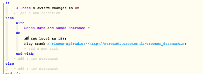

This example is for my christmas piston. It has to be something like this.
IF you can find that link, the piston part is easy.
