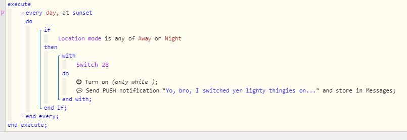

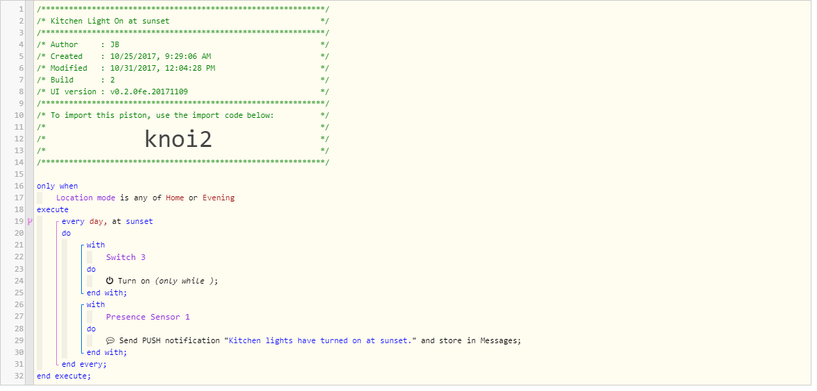

I have the attached piston created to turn on a light at sunset everyday, only if location mode is in a certain mode. The piston is firing regardless of the location mode.
The light should only turn on if location mode is set to “home” or “evening”.
The light is turning on regardless of what location mode is active.
11/17/2017, 5:51:18 PM +733ms +102ms ╔Stopping piston... +179ms ╚Piston successfully stopped (77ms) 11/17/2017, 4:40:59 PM +202ms +0ms ╔Received event [Home].time = 1510958460000 with a delay of -799ms +254ms ║Runtime (37906 bytes) successfully initialized in 111ms (v0.2.0fe.20171109) (253ms) +256ms ║╔Execution stage started +315ms ║║Executed [Light - Kitchen].on (21ms) +343ms ║║Executed virtual command [Josh Nexus 5X].sendPushNotification (19ms) +346ms ║╚Execution stage complete. (91ms) +348ms ║Setting up scheduled job for Sat, Nov 18 2017 @ 4:40:00 PM CST (in 86340.451s) +363ms ╚Event processed successfully (363ms)
