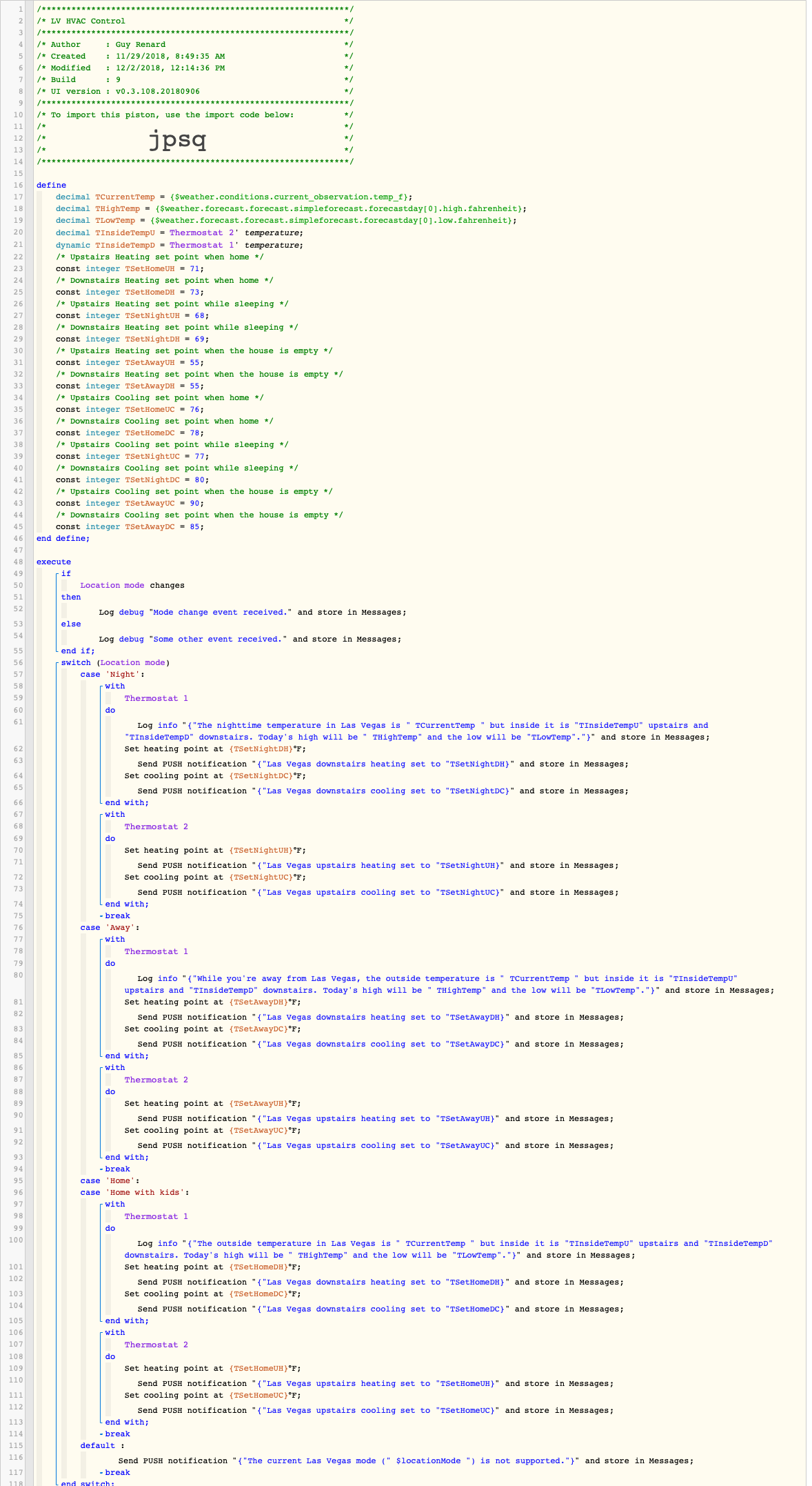

I have a piston to set my thermostat whenever the mode changes. The last two mornings, it didn’t work. I tried changing mode manually again and it still didn’t work. Then I did it a third time and it worked fine.
Change the thermostat set point and log the changes.
Sometimes works, sometimes doesn’t. Maybe I need a check and re-run?

I notice in the logs it is receiving a time/recovery event instead of the mode event. Why would that be? Anything I can do to guard against this error and ensure my piston is properly executed? Thanks.
I don’t see where you have any time triggers in your piston - only changes to Mode. Where is the time trigger?
In the smart things app I have it change mode at 11 PM and 6 AM using the simple built in ‘Good Night’ and ‘Good Morning’ routines.
Ah, gotcha. In that case you should be able to say:
IF
Location mode changes
OR
$currentEventAttribute is time/recovery
That should pick up the erroneous triggers for you. I’m not sure why it’s happening but I’m seeing it on all my pistons with a timer, too.

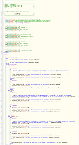

Thanks for the suggestion. I ended up pulling the switch statement outside the ‘if’ statement so it is just always executed if the piston is triggered. I just left a log task inside the if so it wouldn’t be empty. This should work no mater what the erroneous event is.
I will see tomorrow if it works. Seems to fail more often first thing int he morning vs night.
Ah, yep, that’ll do it too!
