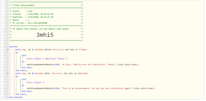

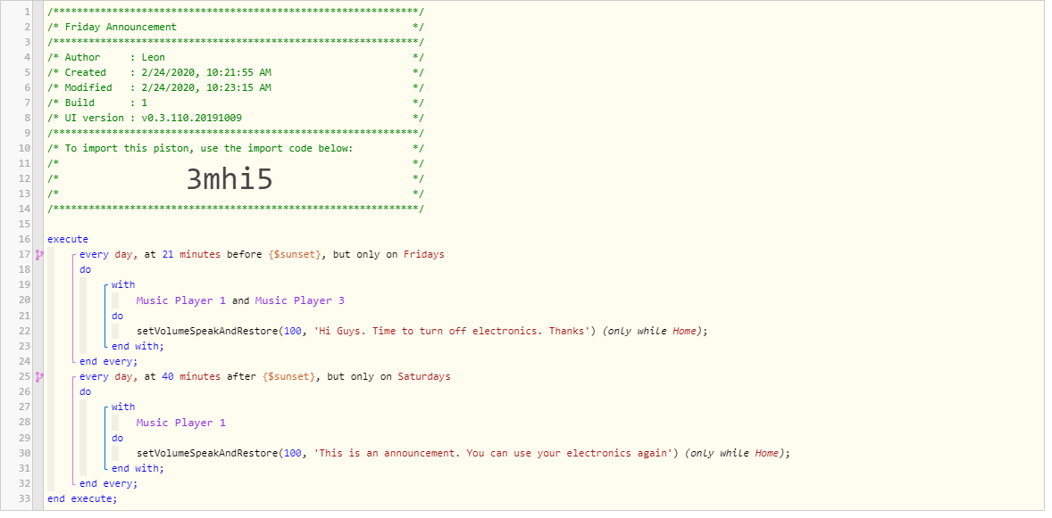

I have a weekly announcement on my echos that lets my kids know its time to stop using electronics. Its scheduled based upon sunset times. Problem is that it seems to be scheduling next week’s task based upon today’s sunset times
Once piston is completed it should schedule the task for that particular day’s sunset time, not the day its scheduling the task
