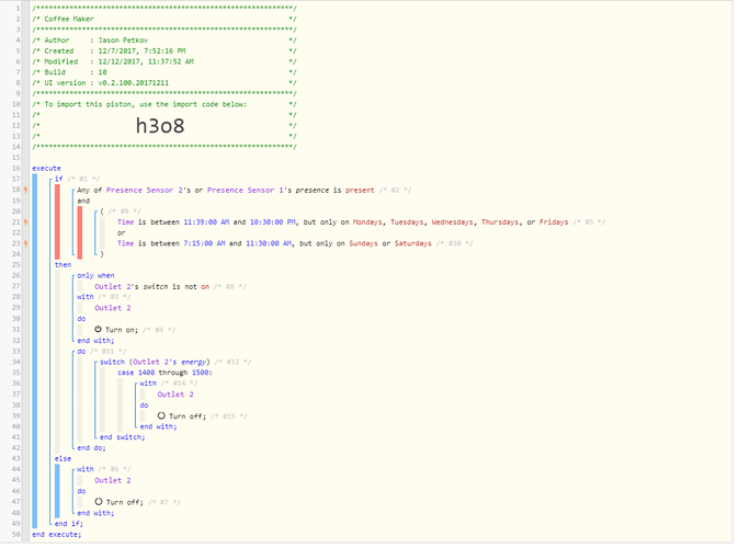

So I have a commercial pour-over Bunn Coffee Maker, I have it setup on the timer to turn on and heat up the tank. That works great, however sometimes I leave the pot warmer on, this causes problems because if it’s low or empty from the day before it burns, which is bad.
I am using an energy monitoring outlet on the coffee maker
The expected behavior is for it to first determine if either myself or wife is home. I got that. Then determine the schedule that I have set for it to run. That is good to go as well. If both of those pass, turn the coffee maker on.
Once the coffee maker is on, I want to see check the energy (wattage) Normal tank usage is approx 1300-1350 watts while heating the tank. However if the warmer is on, that wattage will be 1400-1450.
So I want it at that point to see that the warmer is on, and shut it back off.
I can’t figure out how to get this in a single piston. I could make a second, but i fear there will be conflicts especially if I run it out of schedule etc…
No logs, as I don’t feel I have gotten close enough yet.
Thank you in advance for any and all help! It’s much appreciated.
