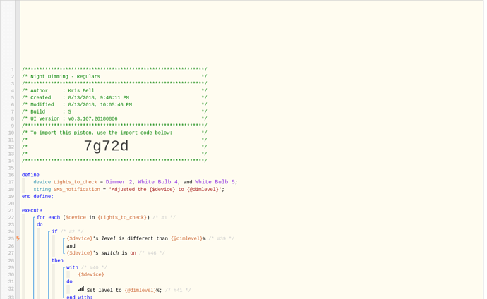

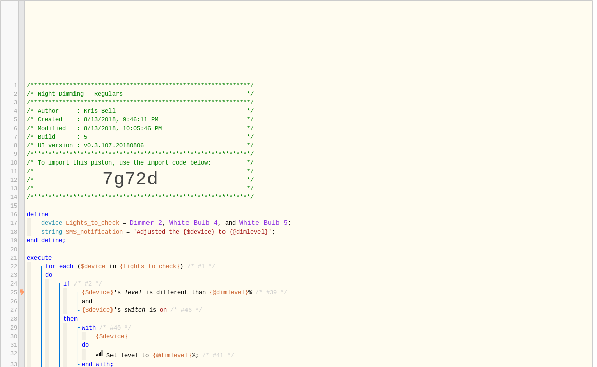

I can’t get the piston to fire based on the conditions.
I’m inputting two conditions in the if block. I realize this is inefficient, but I want the piston to fire if either a watched switch comes on or the watched switch’s level is different from the variable integer (which changes based on time of day…separate piston handles that variable).
When the piston is running, nothing happens. So if the reference integer is 10, and I have the light set to 100, I know that condition is met. Then, if I turn off, then on the switch, I know that condition is met. But the piston doesn’t fire, and so it doesn’t change the dimmer level. However, If I manually test it by pressing the test button, the piston does exactly what I want. It seems like maybe the “for each” is dorking up the piston’s ability to subscribe to the conditions I want it to subscribe to. Is this possible?
+1ms ╔Starting piston… (v0.3.107.20180806)
+398ms ║╔Subscribing to devices…
+409ms ║║Subscribing to Home.:8183ef827920214044f7df93ae2053aa:.@dimlevel…
+424ms ║║Subscribing to Home.:8183ef827920214044f7df93ae2053aa:.@SendSMS…
+561ms ║║Subscribing to Master Bedroom Lamp…
+562ms ║║Subscribing to Master Bedroom Overhead Light…
+563ms ║║Subscribing to Upstairs Hallway Light…
+564ms ║╚Finished subscribing (172ms)
+616ms ║Comparison (boolean) true is (boolean) true = true (1ms)
+626ms ╚Piston successfully started (625ms)

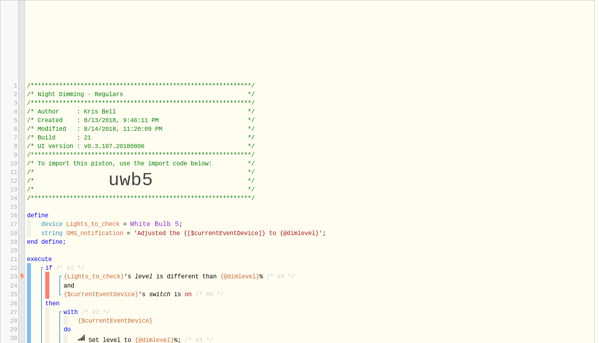

I think you just need to structure it differently:
IF level is different
AND switch is on
THEN
For each device
DO
Set Device to @dimlevel
I think I’ve found how to structure the piston so that it fires:
In some of the threads I found, there was talk of “parallelism.” I could never really discern what this does, or if I need it.
Now I’ve got another follow-on question. Every time my piston runs and sets the level, that makes the piston fire a second time. The second fire checks conditions and finds that now the level matches the target level, so it doesn’t do the actions…but is there a way I can optimize it to remove the second run? If this was excel VBA, I’d disable events in the macro, then re-enable at the end after all the actions are done. Any hints?

Try to put your triggers outside the loops. I’m not sure it works if done that way as you found out.
