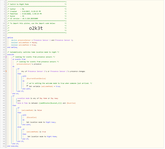

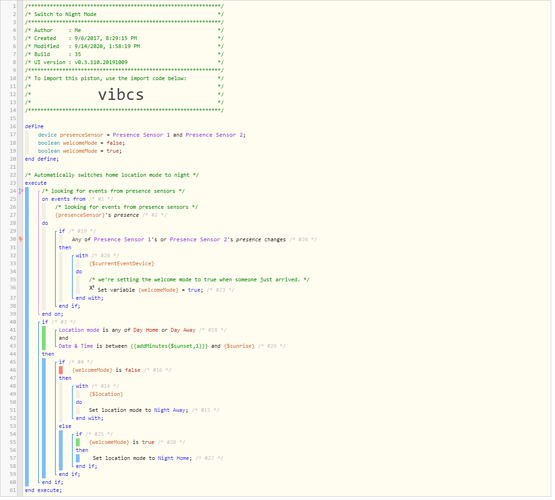

Piston snapshot as is with NO ‘test’ button pressed:
Piston snapshot after clicking ‘test’ button and trace enabled:

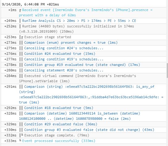

Piston logs as is with NO ‘test’ button pressed:
6:44PM
644pm
7:33PM

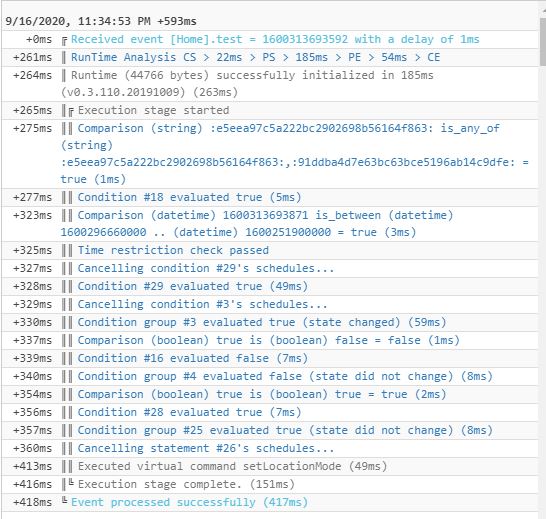

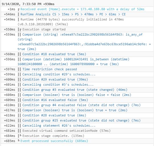

Log for piston running after clicking the ‘test’ button:

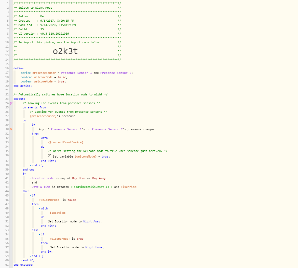

I have not looked at your logs, but at a quick glance, I think that lines 29-38 should drop the IF, and simply keep the WITH block there. This will turn line 27 into a trigger.
(although you also have to tweak your logic there, since every change does not mean welcome home!)
Alternatively, you can drop lines 25-27, by removing the ON EVENTS FROM…
This will place lines 29-38 unindented to the far left.
TL;DR:
Line 27 & 30 are identical. You only want one.

So why does it appear to work correctly upon clicking the test button and doesnt trigger the right location mode on its own?
The test button should never work with a true trigger.
(only conditions that are acting like a trigger)
A proper test is to actually do the thing with a lightning bolt next to it.
By removing ‘ON EVENTS FROM’ deletes lines 24-47. And leaves lines 48-89 only. I’ll have to see if i can cut and paste lines 29-45.
You can drag & drop the inner IF block, and then delete the empty “ON EVENTS FROM” block
