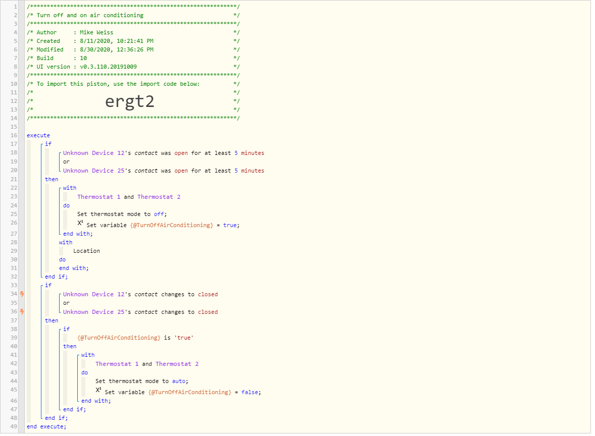

I have a piston defined to tell when the front or back door is open for at least 5 minutes then turn off the air conditioning. It looks like the piston subscribed to the initial door sensor open event but then does not continuously check to see if it is open 5 minutes from that point.
I would expect the piston to run every minute or so to see if the door sensor is still open and run the piston.
The piston never runs again and never gets triggered.
