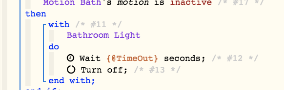

I have a piston that has a wait and then a turn off task. The piston wakes up after the wait period but seems to have forgotten the task it was supposed to execute.

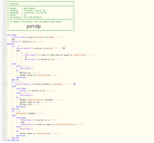

Snippet of piston. Fairly straight forward:
08 PM

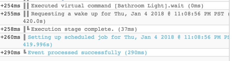

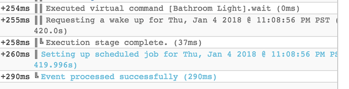

Initial run sets up scheduled job:

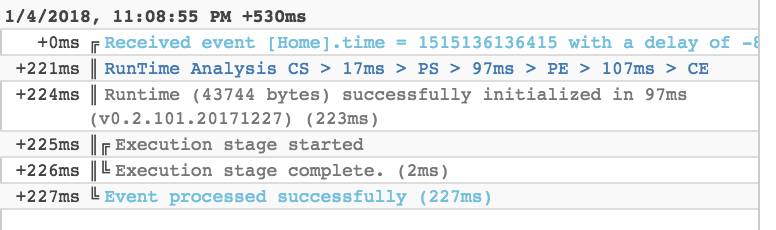

Scheduled job wakes up but doesn’t execute the turn off task:
How is this possible?

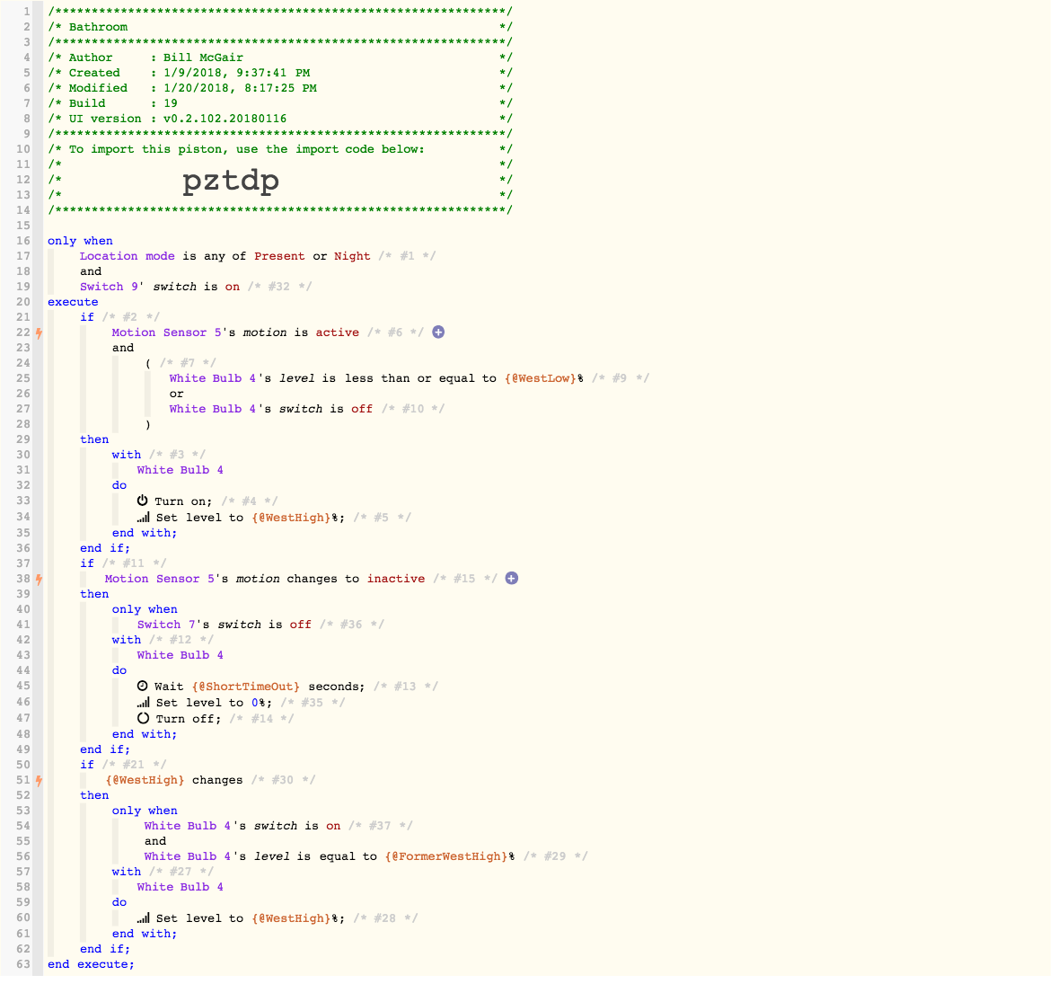

Can you post a green snapshot of your piston?
OK well here’s my theory of what is going on. The piston had a restriction based on luminance from another device, which required it to subscribe to that device.
During the wait period that other device updated, causing a notification to my piston. If my piston was notified of an event during the wait period, my piston would wake up and run. After that run all the tasks in the previously scheduled wakeup were cancelled. If per chance, my other device didn’t send any notification, my piston would run normally.
I’m not sure why this would be the case, and I’m not quite sure if it is in fact the case but that’s my current theory.
In the snapshot below I’ve removed the luminance restriction from the other device and all (so far) seems to be working correctly.
