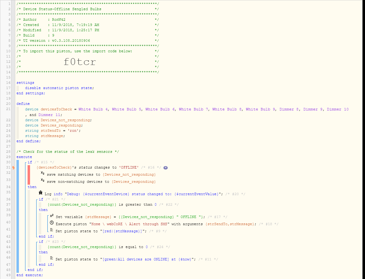

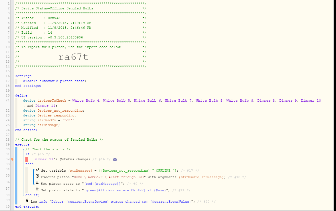

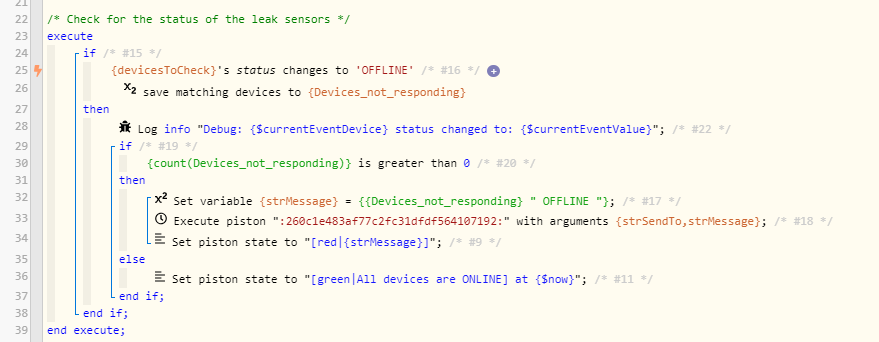

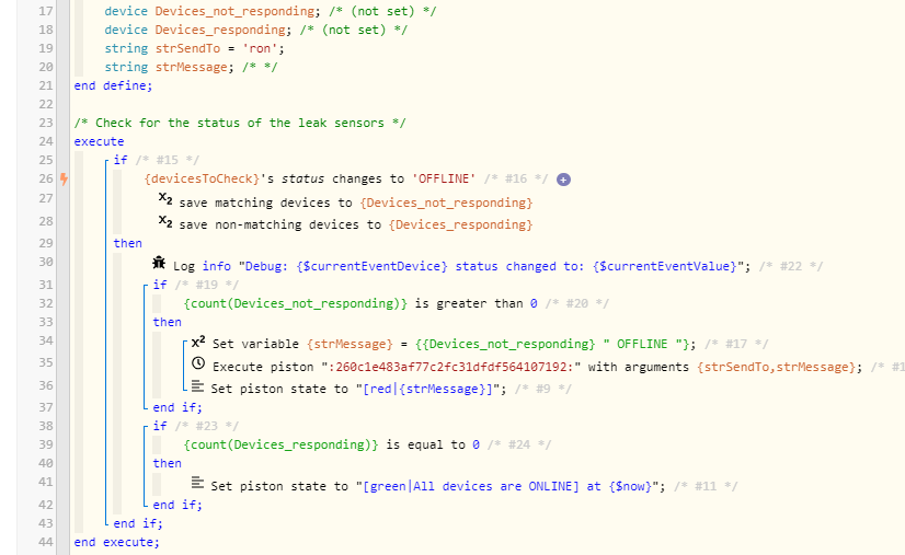

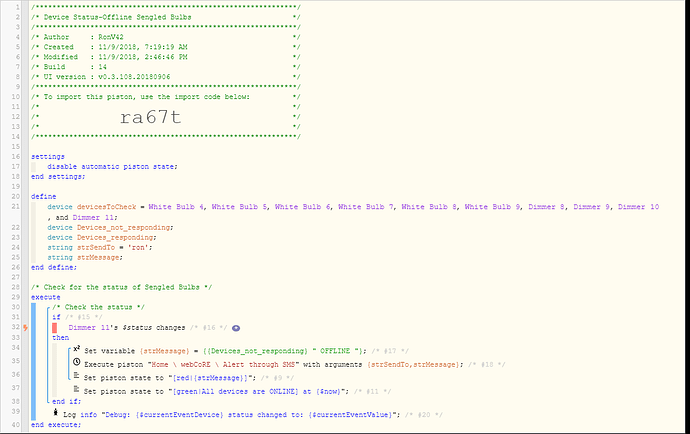

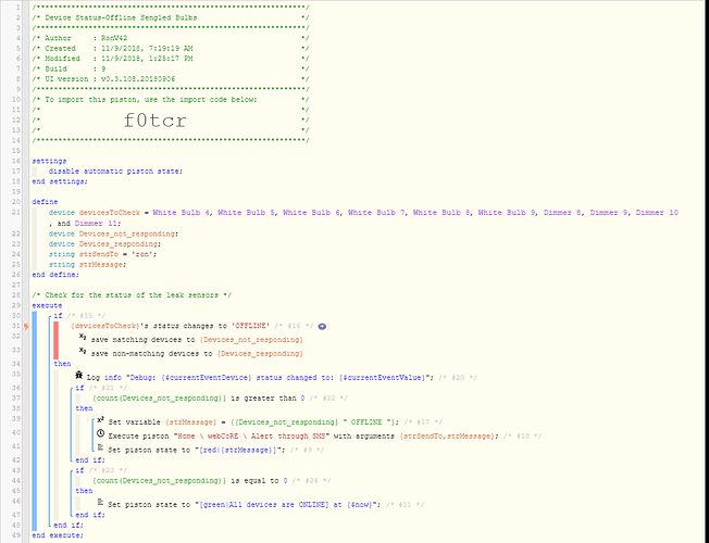

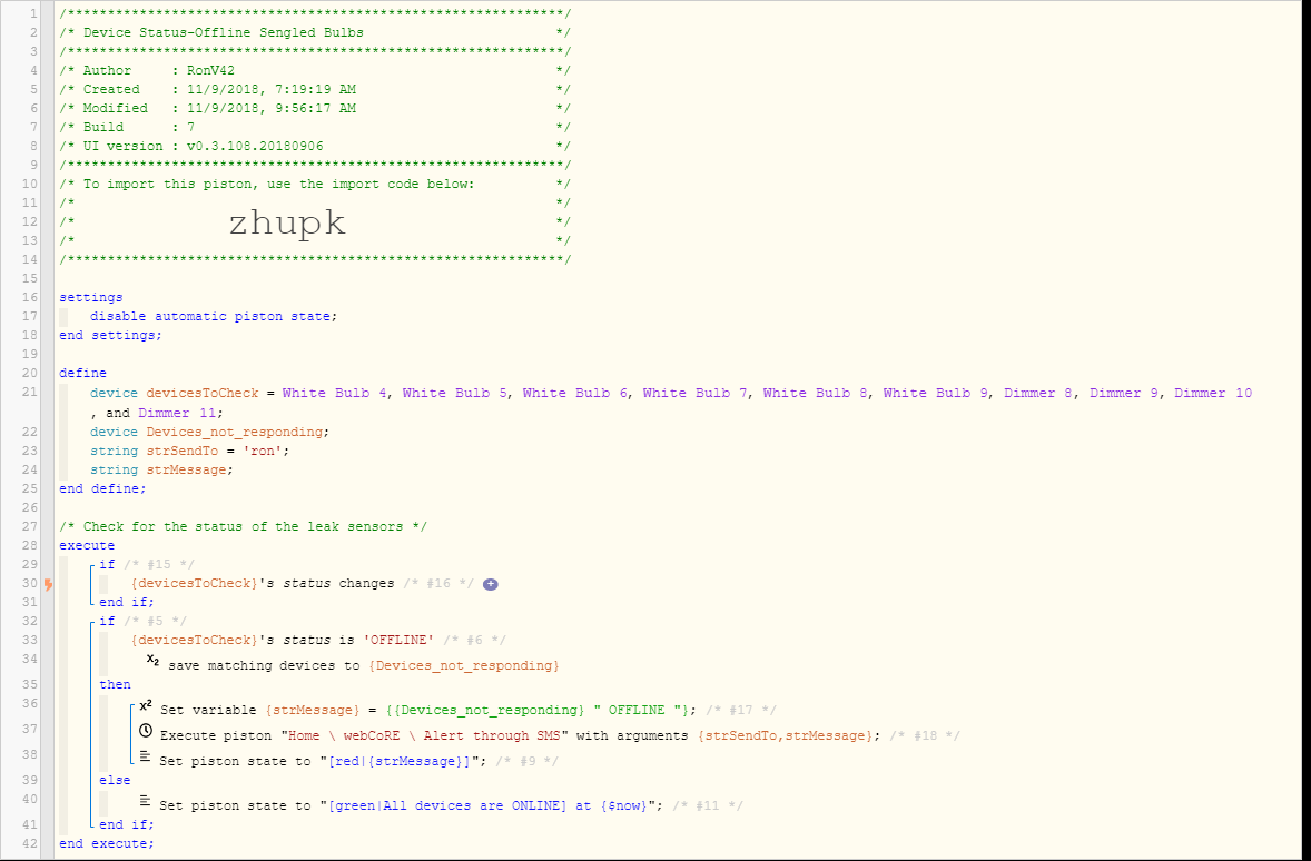

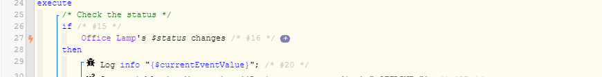

I created a simple piston to monitor the status of devices if they are offline. The issue is that it’s not firing off when testing it. The devices I defined are Sengled ZigBee bulbs.
When SmartThinigs detects the bulb is offline to run the piston

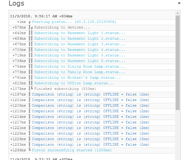

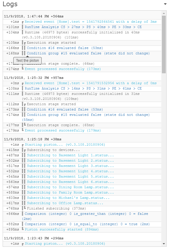

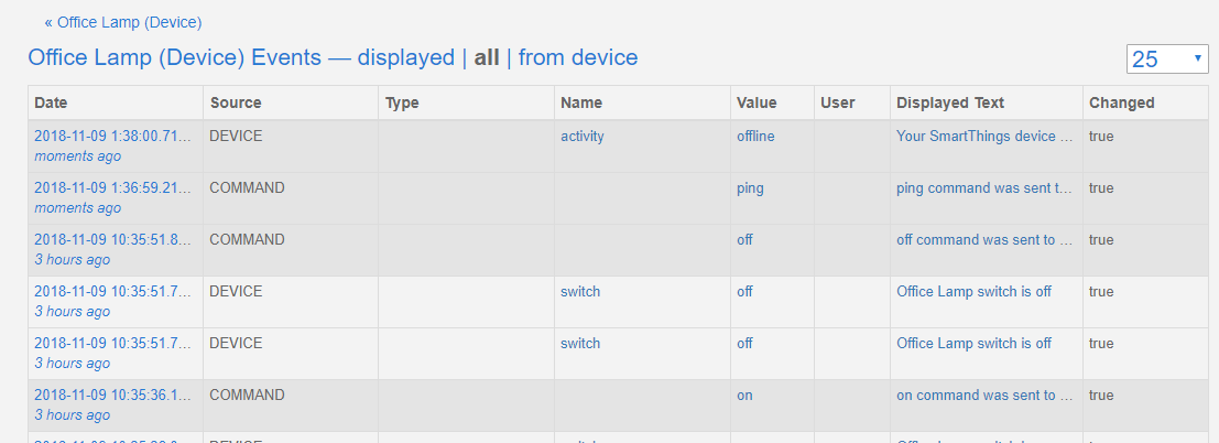

Not seeing the offline event in the piston log but the SmartThings event list for the device shows the event for the device going offline. After the piston is saved you can see in the logs that it subscribed to the devices status but at 10:01 when SmartThinigs showed one of the bulbs went offline there was no activity in the piston.
