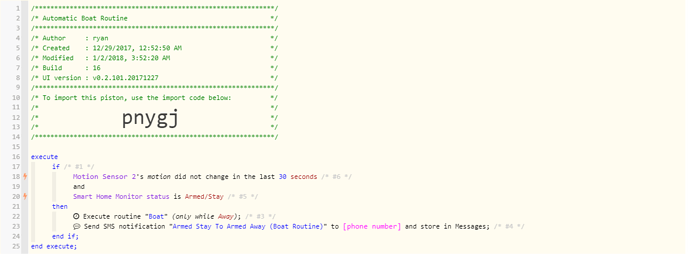

Piston not Firing Correctly
When I try to test this piston it sends a text right away and dosnt change the smart security state to armed away
(PUT YOUR INFO HERE)
After leaving my house for a certain amount of time based on motion happening or not for a certain amount of time i need it to trigger a different mode. Basically if someone is moving around the house say every 10 mins or so the piston wont fire unless motion has stopped for a period of time
When i set my routine to goodbye it automatically sends a text that boat routine is ran and it does not. i gave it a short time on the motion just to test out and dosnt work.

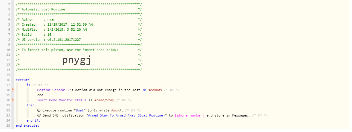

(UPLOAD YOUR IMAGE HERE)
You’re missing something which changes the mode to away, otherwise line 22 is told NOT to execute. And if the mode is set to away by another piston, this one won’t execute because of line 20.
that makes since kind of new to this i not sure how i missed something as simple as that but ill try to fix later and get back to you
