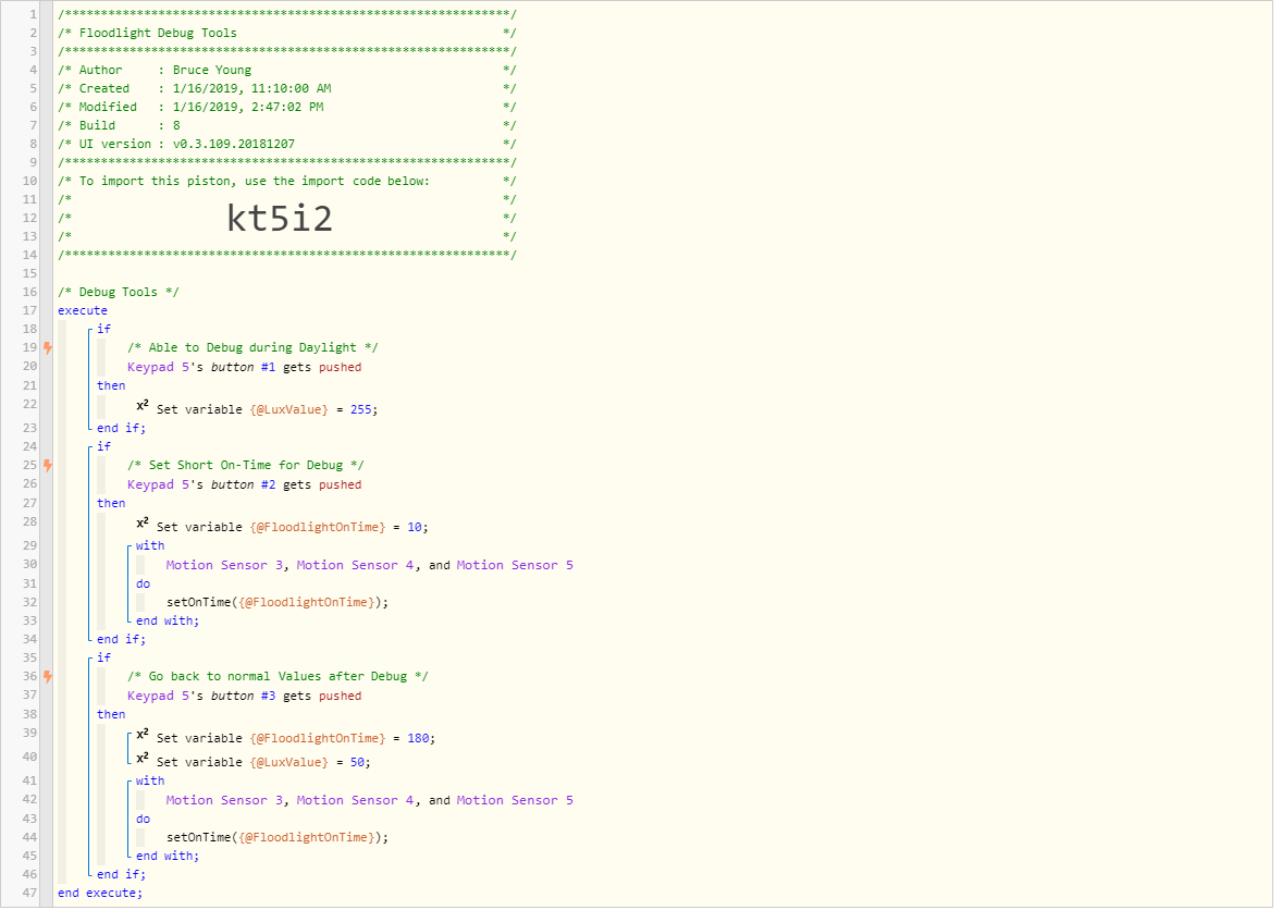

Piston Not Receiving all Button Presses
I created a virtual device (Simulated Minimote) with 4 buttons to control a piston. I have triggers for 3 of the buttons and all 3 button presses are logged in the ST. But the piston only seems to receive the first button press.
I expect that each of the 3 buttons should trigger a separate part of the piston.
Button presses for button #2 and button #3 are not being detected.

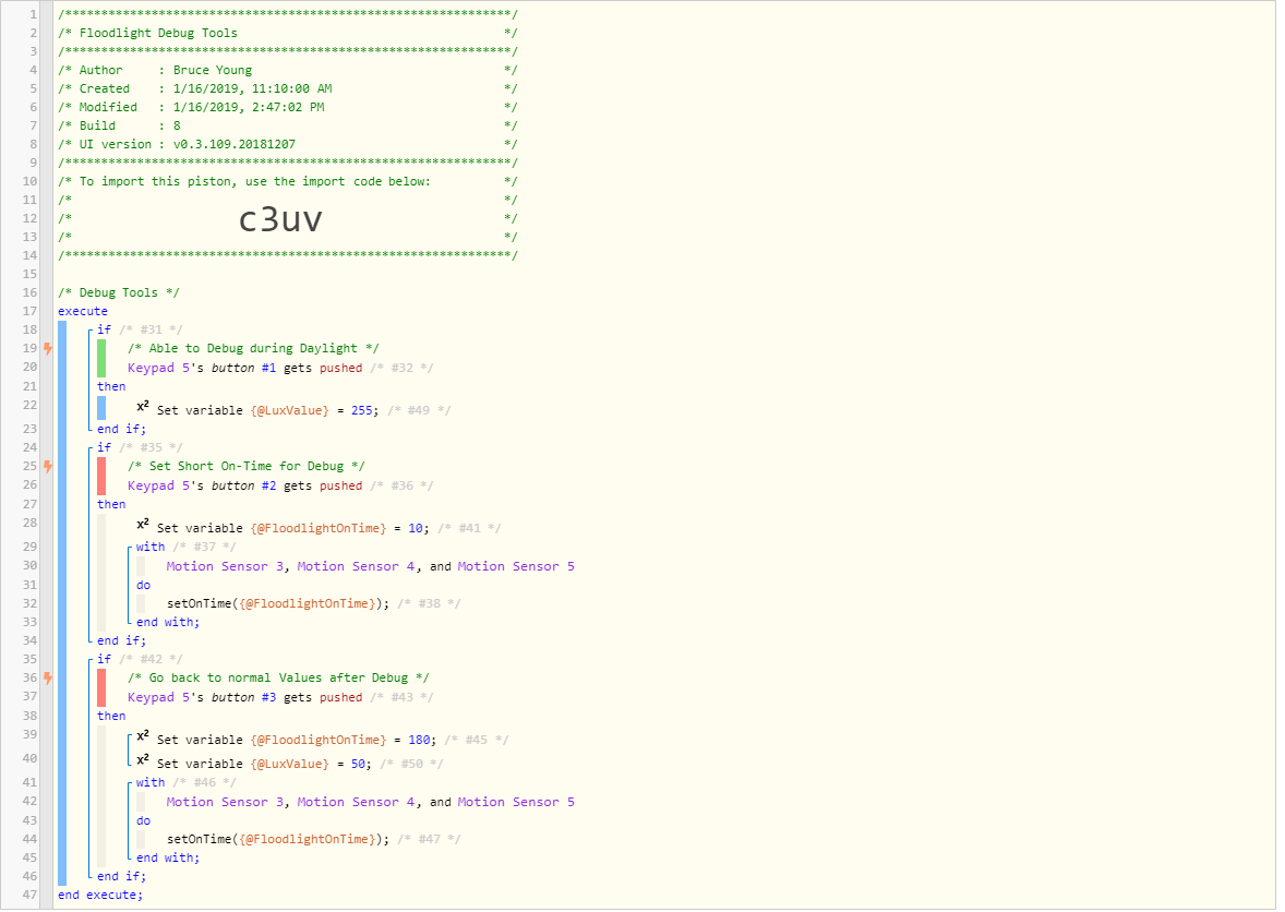

WebCore Log for Piston (note there is no action shown for button 2 or button 3)
+2ms ╔Received event [Floodlight Debug].button = pushed with a delay of 214ms
+3697ms ║RunTime Analysis CS > 26ms > PS > 3644ms > PE > 27ms > CE
+3698ms ║Piston waited at a semaphore for 3508ms
+3701ms ║Runtime (39797 bytes) successfully initialized in 3644ms (v0.3.109.20181207) (3697ms)
+3702ms ║╔Execution stage started
+3715ms ║║Comparison (enum) pushed gets (string) pushed = true (1ms)
+3717ms ║║Condition #32 evaluated true (7ms)
+3718ms ║║Condition group #31 evaluated true (state did not change) (10ms)
+3721ms ║║Cancelling statement #48’s schedules…
+3727ms ║║Executed virtual command setVariable (2ms)
+3737ms ║║Comparison (enum) pushed gets (string) pushed = false (1ms)
+3739ms ║║Condition #36 evaluated false (7ms)
+3741ms ║║Condition group #35 evaluated false (state did not change) (9ms)
+3750ms ║║Comparison (enum) pushed gets (string) pushed = false (2ms)
+3752ms ║║Condition #43 evaluated false (7ms)
+3753ms ║║Condition group #42 evaluated false (state did not change) (9ms)
+3756ms ║╚Execution stage complete. (55ms)
+3758ms ╚Event processed successfully (3759ms)

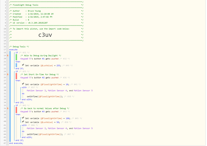

ST Log for Piston
84054beb-ed2d-43d9-bb1a-c7bd2fce9457 2:51:05 PM: debug ║║ Cancelling statement #46’s schedules…
84054beb-ed2d-43d9-bb1a-c7bd2fce9457 2:51:05 PM: debug ║║ Cancelling statement #44’s schedules…
84054beb-ed2d-43d9-bb1a-c7bd2fce9457 2:51:05 PM: debug ║║ Condition group #42 evaluated true (state changed) (10ms)
84054beb-ed2d-43d9-bb1a-c7bd2fce9457 2:51:05 PM: debug ║║ Cancelling condition #42’s schedules…
84054beb-ed2d-43d9-bb1a-c7bd2fce9457 2:51:05 PM: debug ║║ Condition #43 evaluated true (7ms)
84054beb-ed2d-43d9-bb1a-c7bd2fce9457 2:51:05 PM: debug ║║ Cancelling condition #43’s schedules…
84054beb-ed2d-43d9-bb1a-c7bd2fce9457 2:51:05 PM: debug ║║ Comparison (enum) pushed gets (string) pushed = true (1ms)
84054beb-ed2d-43d9-bb1a-c7bd2fce9457 2:51:05 PM: debug ║║ Condition group #35 evaluated false (state did not change) (7ms)
84054beb-ed2d-43d9-bb1a-c7bd2fce9457 2:51:05 PM: debug ║║ Condition group #31 evaluated false (state changed) (10ms)
84054beb-ed2d-43d9-bb1a-c7bd2fce9457 2:51:05 PM: debug ║║ Cancelling condition #32’s schedules…
84054beb-ed2d-43d9-bb1a-c7bd2fce9457 2:51:05 PM: debug ║║ Comparison (enum) pushed gets (string) pushed = false (1ms)
84054beb-ed2d-43d9-bb1a-c7bd2fce9457 2:51:05 PM: trace ║╚ Execution stage started
84054beb-ed2d-43d9-bb1a-c7bd2fce9457 2:51:05 PM: trace ║ Runtime (39799 bytes) successfully initialized in 9111ms (v0.3.109.20181207) (9150ms)
84054beb-ed2d-43d9-bb1a-c7bd2fce9457 2:51:05 PM: warn ║ Piston waited at a semaphore for 9019ms
84054beb-ed2d-43d9-bb1a-c7bd2fce9457 2:51:05 PM: debug ║ RunTime Analysis CS > 16ms > PS > 9111ms > PE > 21ms > CE
84054beb-ed2d-43d9-bb1a-c7bd2fce9457 2:50:55 PM: debug ║║ Cancelling condition #32’s schedules…
84054beb-ed2d-43d9-bb1a-c7bd2fce9457 2:50:55 PM: debug ║║ Cancelling condition #43’s schedules…
84054beb-ed2d-43d9-bb1a-c7bd2fce9457 2:50:55 PM: debug ║║ Comparison (enum) pushed gets (string) pushed = true (1ms)
84054beb-ed2d-43d9-bb1a-c7bd2fce9457 2:50:55 PM: debug ║║ Condition #43 evaluated true (8ms)
84054beb-ed2d-43d9-bb1a-c7bd2fce9457 2:50:55 PM: warn ║ Piston waited at a semaphore for 8848ms
84054beb-ed2d-43d9-bb1a-c7bd2fce9457 2:50:46 PM: info ╚ Received event [Floodlight Debug].button = pushed with a delay of 5900ms
84054beb-ed2d-43d9-bb1a-c7bd2fce9457 2:50:45 PM: debug ║║ Cancelling statement #37’s schedules…
84054beb-ed2d-43d9-bb1a-c7bd2fce9457 2:50:45 PM: trace ║║ Executed virtual command setVariable (1ms)
84054beb-ed2d-43d9-bb1a-c7bd2fce9457 2:50:45 PM: debug ║║ Cancelling statement #39’s schedules…
84054beb-ed2d-43d9-bb1a-c7bd2fce9457 2:50:45 PM: debug ║║ Condition group #35 evaluated true (state changed) (11ms)
84054beb-ed2d-43d9-bb1a-c7bd2fce9457 2:50:45 PM: debug ║║ Cancelling condition #35’s schedules…
84054beb-ed2d-43d9-bb1a-c7bd2fce9457 2:50:45 PM: debug ║║ Condition #36 evaluated true (6ms)
84054beb-ed2d-43d9-bb1a-c7bd2fce9457 2:50:45 PM: debug ║║ Cancelling condition #36’s schedules…
84054beb-ed2d-43d9-bb1a-c7bd2fce9457 2:50:45 PM: debug ║║ Comparison (enum) pushed gets (string) pushed = true (1ms)
84054beb-ed2d-43d9-bb1a-c7bd2fce9457 2:50:45 PM: debug ║║ Condition group #31 evaluated false (state changed) (9ms)
84054beb-ed2d-43d9-bb1a-c7bd2fce9457 2:50:45 PM: debug ║║ Cancelling condition #31’s schedules…
84054beb-ed2d-43d9-bb1a-c7bd2fce9457 2:50:45 PM: debug ║║ Condition #32 evaluated false (7ms)
84054beb-ed2d-43d9-bb1a-c7bd2fce9457 2:50:45 PM: debug ║║ Cancelling condition #32’s schedules…
84054beb-ed2d-43d9-bb1a-c7bd2fce9457 2:50:45 PM: debug ║║ Comparison (enum) pushed gets (string) pushed = false (1ms)
84054beb-ed2d-43d9-bb1a-c7bd2fce9457 2:50:45 PM: trace ║╚ Execution stage started
84054beb-ed2d-43d9-bb1a-c7bd2fce9457 2:50:45 PM: trace ║ Runtime (39799 bytes) successfully initialized in 8902ms (v0.3.109.20181207) (8952ms)
84054beb-ed2d-43d9-bb1a-c7bd2fce9457 2:50:45 PM: warn ║ Piston waited at a semaphore for 8767ms
84054beb-ed2d-43d9-bb1a-c7bd2fce9457 2:50:45 PM: debug ║ RunTime Analysis CS > 20ms > PS > 8902ms > PE > 25ms > CE
84054beb-ed2d-43d9-bb1a-c7bd2fce9457 2:50:36 PM: info ╚ Received event [Floodlight Debug].button = pushed with a delay of 11421ms
84054beb-ed2d-43d9-bb1a-c7bd2fce9457 2:50:45 PM: debug ║║ Cancelling statement #46’s schedules…
84054beb-ed2d-43d9-bb1a-c7bd2fce9457 2:50:45 PM: debug ║║ Condition group #42 evaluated true (state changed) (10ms)
84054beb-ed2d-43d9-bb1a-c7bd2fce9457 2:50:45 PM: debug ║║ Condition #43 evaluated true (8ms)
84054beb-ed2d-43d9-bb1a-c7bd2fce9457 2:50:45 PM: debug ║║ Comparison (enum) pushed gets (string) pushed = true (2ms)
84054beb-ed2d-43d9-bb1a-c7bd2fce9457 2:50:45 PM: debug ║║ Cancelling statement #44’s schedules…
84054beb-ed2d-43d9-bb1a-c7bd2fce9457 2:50:45 PM: debug ║║ Condition #36 evaluated false (6ms)
84054beb-ed2d-43d9-bb1a-c7bd2fce9457 2:50:45 PM: debug ║║ Cancelling condition #42’s schedules…
84054beb-ed2d-43d9-bb1a-c7bd2fce9457 2:50:45 PM: debug ║║ Condition group #31 evaluated false (state changed) (13ms)
84054beb-ed2d-43d9-bb1a-c7bd2fce9457 2:50:45 PM: debug ║║ Condition group #35 evaluated false (state did not change) (7ms)
84054beb-ed2d-43d9-bb1a-c7bd2fce9457 2:50:45 PM: debug ║║ Comparison (enum) pushed gets (string) pushed = false (4ms)
84054beb-ed2d-43d9-bb1a-c7bd2fce9457 2:50:45 PM: warn ║ Piston waited at a semaphore for 4510ms
84054beb-ed2d-43d9-bb1a-c7bd2fce9457 2:50:45 PM: trace ║ Runtime (39796 bytes) successfully initialized in 4595ms (v0.3.109.20181207) (4630ms)
84054beb-ed2d-43d9-bb1a-c7bd2fce9457 2:50:45 PM: debug ║ RunTime Analysis CS > 12ms > PS > 4595ms > PE > 22ms > CE
84054beb-ed2d-43d9-bb1a-c7bd2fce9457 2:50:40 PM: info ╚ Received event [Floodlight Debug].button = pushed with a delay of 51ms
84054beb-ed2d-43d9-bb1a-c7bd2fce9457 2:50:35 PM: debug ║║ Cancelling statement #37’s schedules…
84054beb-ed2d-43d9-bb1a-c7bd2fce9457 2:50:35 PM: trace ║║ Executed virtual command setVariable (1ms)
84054beb-ed2d-43d9-bb1a-c7bd2fce9457 2:50:35 PM: debug ║║ Cancelling condition #31’s schedules…
84054beb-ed2d-43d9-bb1a-c7bd2fce9457 2:50:35 PM: trace ║╚ Execution stage started
84054beb-ed2d-43d9-bb1a-c7bd2fce9457 2:50:26 PM: info ╚ Received event [Floodlight Debug].button = pushed with a delay of 1531ms
84054beb-ed2d-43d9-bb1a-c7bd2fce9457 2:50:25 PM: debug ║║ Cancelling statement #39’s schedules…
84054beb-ed2d-43d9-bb1a-c7bd2fce9457 2:50:25 PM: debug ║║ Cancelling condition #35’s schedules…
84054beb-ed2d-43d9-bb1a-c7bd2fce9457 2:50:25 PM: debug ║║ Cancelling condition #36’s schedules…
84054beb-ed2d-43d9-bb1a-c7bd2fce9457 2:50:25 PM: debug ║║ Comparison (enum) pushed gets (string) pushed = true (1ms)
84054beb-ed2d-43d9-bb1a-c7bd2fce9457 2:50:25 PM: debug ║║ Comparison (enum) pushed gets (string) pushed = false (1ms)
84054beb-ed2d-43d9-bb1a-c7bd2fce9457 2:50:25 PM: trace ║╚ Execution stage started
84054beb-ed2d-43d9-bb1a-c7bd2fce9457 2:50:25 PM: trace ║ Runtime (39724 bytes) successfully initialized in 146ms (v0.3.109.20181207) (192ms)
84054beb-ed2d-43d9-bb1a-c7bd2fce9457 2:50:25 PM: debug ║ RunTime Analysis CS > 20ms > PS > 146ms > PE > 26ms > CE
84054beb-ed2d-43d9-bb1a-c7bd2fce9457 2:50:25 PM: info ╚ Received event [Floodlight Debug].button = pushed with a delay of 64ms
84054beb-ed2d-43d9-bb1a-c7bd2fce9457 2:50:13 PM: trace ║║ Executed virtual command setVariable (1ms)
84054beb-ed2d-43d9-bb1a-c7bd2fce9457 2:50:13 PM: debug ║║ Condition group #35 evaluated true (state changed) (12ms)
84054beb-ed2d-43d9-bb1a-c7bd2fce9457 2:50:13 PM: debug ║║ Cancelling condition #35’s schedules…
84054beb-ed2d-43d9-bb1a-c7bd2fce9457 2:50:13 PM: debug ║║ Cancelling condition #36’s schedules…
84054beb-ed2d-43d9-bb1a-c7bd2fce9457 2:50:13 PM: debug ║║ Cancelling condition #31’s schedules…
84054beb-ed2d-43d9-bb1a-c7bd2fce9457 2:50:13 PM: debug ║║ Cancelling condition #32’s schedules…
84054beb-ed2d-43d9-bb1a-c7bd2fce9457 2:50:13 PM: debug ║║ Cancelling statement #37’s schedules…
84054beb-ed2d-43d9-bb1a-c7bd2fce9457 2:50:13 PM: debug ║║ Cancelling statement #39’s schedules…
84054beb-ed2d-43d9-bb1a-c7bd2fce9457 2:50:13 PM: trace ║╚ Execution stage started
84054beb-ed2d-43d9-bb1a-c7bd2fce9457 2:50:13 PM: debug ║║ Condition #36 evaluated true (8ms)
84054beb-ed2d-43d9-bb1a-c7bd2fce9457 2:50:13 PM: debug ║ RunTime Analysis CS > 21ms > PS > 8886ms > PE > 24ms > CE
84054beb-ed2d-43d9-bb1a-c7bd2fce9457 2:50:13 PM: debug ║║ Condition group #31 evaluated false (state changed) (12ms)
84054beb-ed2d-43d9-bb1a-c7bd2fce9457 2:50:13 PM: debug ║║ Condition #32 evaluated false (8ms)
84054beb-ed2d-43d9-bb1a-c7bd2fce9457 2:50:13 PM: debug ║║ Comparison (enum) pushed gets (string) pushed = false (1ms)
84054beb-ed2d-43d9-bb1a-c7bd2fce9457 2:50:13 PM: warn ║ Piston waited at a semaphore for 8769ms
84054beb-ed2d-43d9-bb1a-c7bd2fce9457 2:50:04 PM: info ╚ Received event [Floodlight Debug].button = pushed with a delay of 11368ms
84054beb-ed2d-43d9-bb1a-c7bd2fce9457 2:50:13 PM: info ╔ Event processed successfully (3759ms)
84054beb-ed2d-43d9-bb1a-c7bd2fce9457 2:50:13 PM: debug ║║ Condition group #42 evaluated false (state did not change) (9ms)
84054beb-ed2d-43d9-bb1a-c7bd2fce9457 2:50:13 PM: trace ║╔ Execution stage complete. (55ms)
84054beb-ed2d-43d9-bb1a-c7bd2fce9457 2:50:13 PM: debug ║║ Condition group #35 evaluated false (state did not change) (9ms)
84054beb-ed2d-43d9-bb1a-c7bd2fce9457 2:50:13 PM: debug ║║ Condition #32 evaluated true (7ms)
84054beb-ed2d-43d9-bb1a-c7bd2fce9457 2:50:13 PM: warn ║ Piston waited at a semaphore for 3508ms
84054beb-ed2d-43d9-bb1a-c7bd2fce9457 2:50:10 PM: info ╚ Received event [Floodlight Debug].button = pushed with a delay of 214ms
You did not post the webCoRE time stamps from 2:50:04 thru 2:50:45 so I can not debug this…
Also, we’d need to see a green snapshot with TRACE turned on so the grey numbers are shown at the end of each line. (this helps when digging thru the logs)
The portion of the WebCoRE log I posted was stamped “1/16/2019, 2:50:10 PM +142ms”
There was nothing in the WebCoRE log after that. Here Are the last three events in the log (the first is what I originally posted but with the time stamp.

Here is the green snapshop with TRACE turned on
Thanks.
It seems like SmartThings sees all three buttons the same:
Maybe try using your “Virtual Scene Controller” as the 3 triggers…
