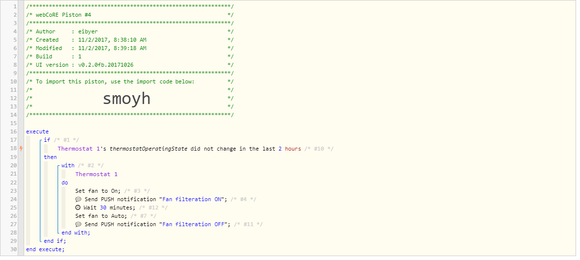

Thermostat fan should turn on for 30 minutes if heat/cool has not run for 2 hours.

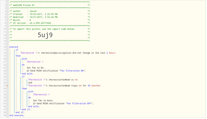

Nothing is happening. When I try manual run fan turn on for 30 minutes then turn off then immediately turn on.

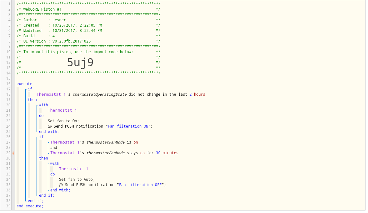

Try… starting at line 23, remove lines 26 and below…
Set fan to On;
Send PUSH notification "message here...";
Wait 30 minutes;
Set fan to Auto;
Send PUSH notification "message here...;
If I start at line 23 what will cause the ‘turn fan on’ start? Is there a way to test a piston? Like how we can evaluate a formula in excel.
Line 18 would subscribe to events from Thermostat 1 (which you can tell by the orange bolt on the left hand gutter).
There is a Test button on the bottom of the piston once you save it. Alternatively, you can create a virtual switch or to simulate the piston turning true when the switch turns on. Some folks use minimote button also.
Here’s a video an ST forum member made showing how to create a virtual device.
You said to start at line 23. So wouldn’t line 18 be deleted?
Line 23 based on the image you attached, the editor line might be off by a few lines. Please click Reply under the person’s post so that we’ll get notified.

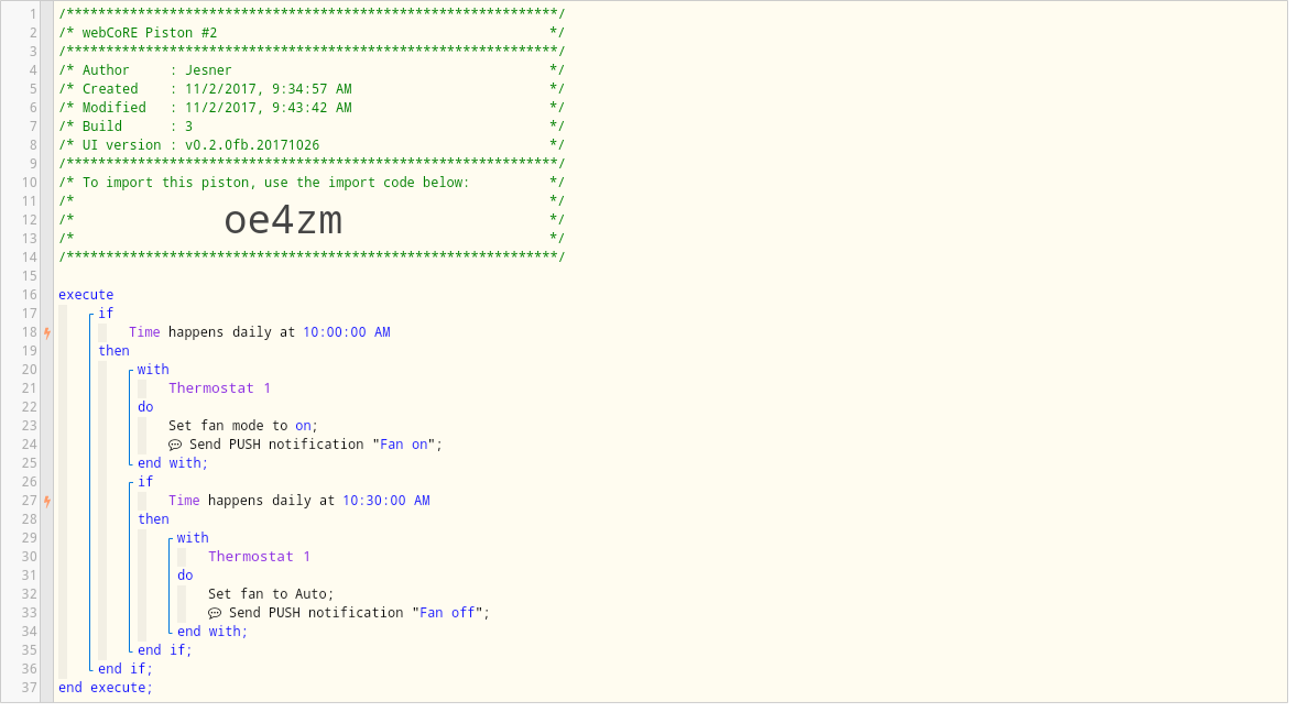

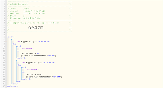

I am not sure what that means. Sorry. I tried creating another piston to start fan on at 10 am and stop at 10:30 am. It works fine but it keeps looping. So fan turn off at 10:30 am and then immediately turn back on.
Something like this…

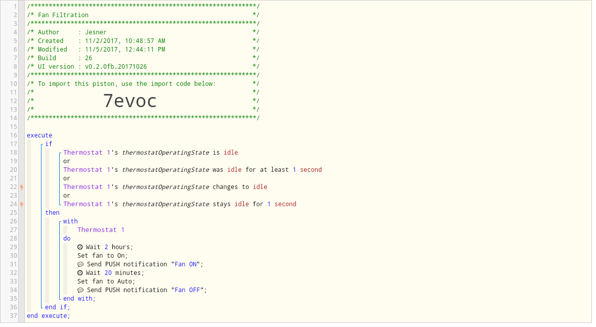

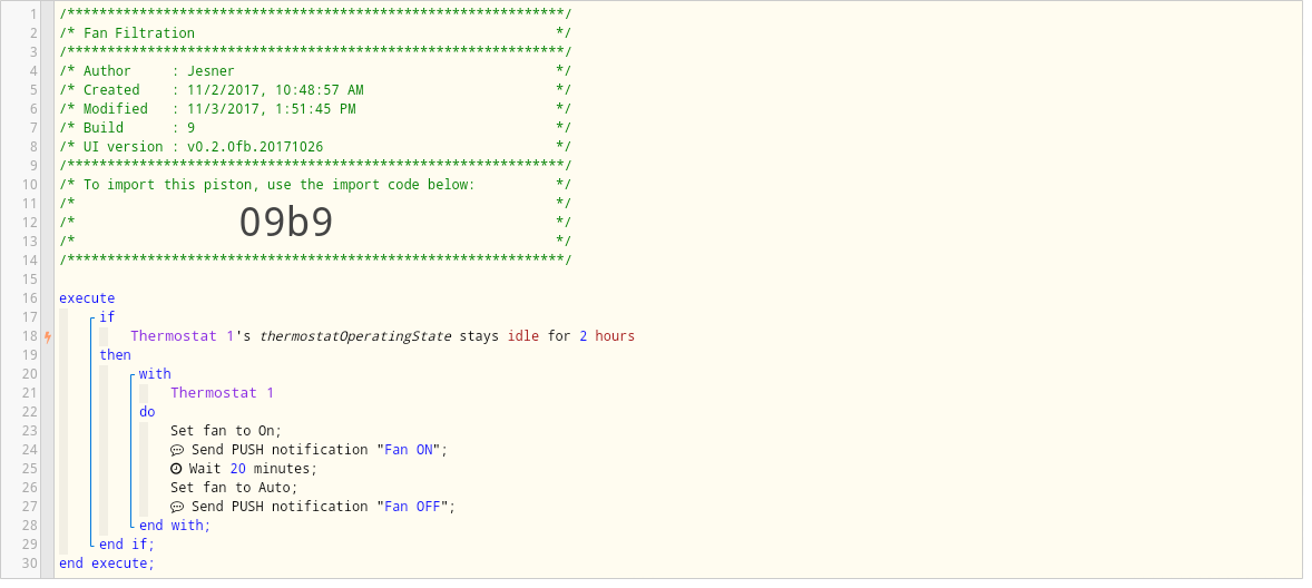

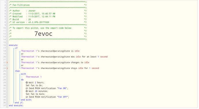

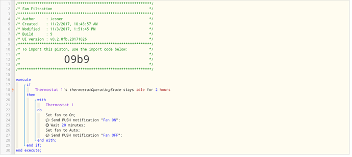

I modified my piston to this. After hitting ‘test’ it executes and schedules a ‘fan on’ after 2 hours. Shouldn’t the ‘fan on’ be instant since thermostat has been idle for 2 hours before I hit ‘test’?
I am not sure if the piston knows the thermostat status on first save so it started the 2 hour count after you hit test.
I have given up. For some reason my piston wont trigger. It works perfectly when I run a test. But thats it. I tried adding more conditions but that did not help. You are free to give me suggestions or ignore it.

I did not follow. I have a schedule for my thermostat. But since the weather is pleasant right now my system doesnt run very often which mean the air doesnt get circulated. I would like the fan to run for 20 minutes if there has been not cooling/heating for more than 2 hours.

I dont think I have that option. I am asked to select device to control. For some reason the piston doesn’t seem to continuously run. I just ran a test and it works fine. But then it stops. How do I make the piston cyclic? ie. keep checking if operating state is idle?
