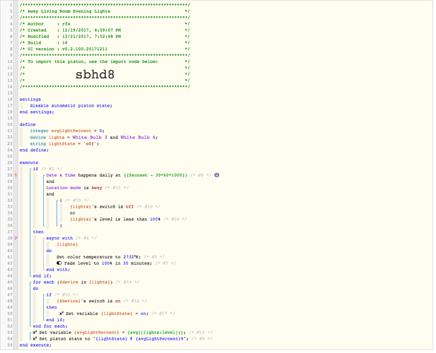

Piston not subscribing but has triggers
Should subscribe to the date/time configured in #8
Getting message that there are no subscriptions, but shows #8 with a lightning bolt
12/21/2017, 7:52:49 PM +239ms

Did you try it with just “Time happens” instead of “Date and Time happens”?
I’m pretty sure $noon is a Date & Time though (looking in the variables of the piston, $noon shows a date)… Time is just since midnight I believe
