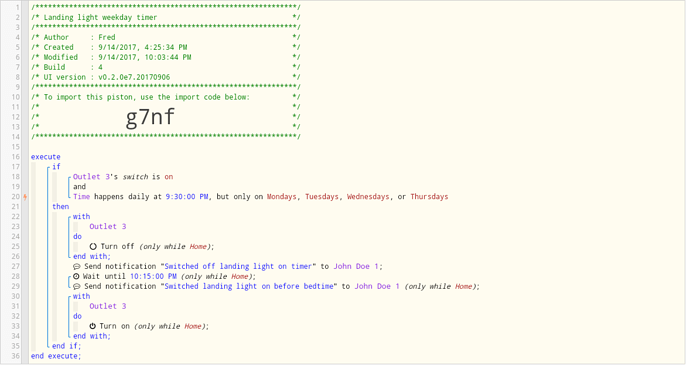

I’m almost certain this is a simple mistake I’ve made but can anyone please guide me on why this Piston isn’t triggering?
Piston not triggering

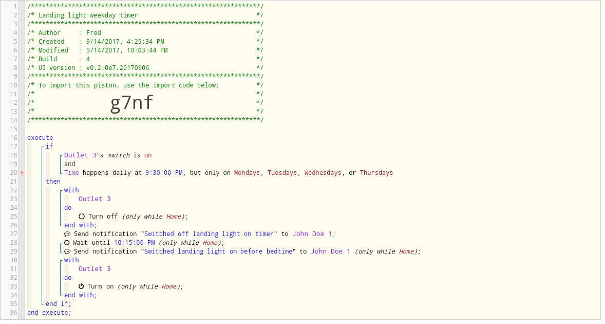

Force it to subscribe to Outlet 3… right now it’s just waiting for time… you can tell by the orange bolt.
Select the device, click the cog icon (wheel), Always subscribe under Subscription Method.
Umm ok I’ve done that so will test it later but I don’t quite get what I’m changing and what exactly does subscribing mean? And even if it is just waiting for time, shouldn’t that work because as soon as the specified time is reached it should kick off the Piston…
Subscribing means the piston will watch for events from the device. In your first picture example, the orange bolt on the gutter indicates the piston is waiting for that 930pm time only.

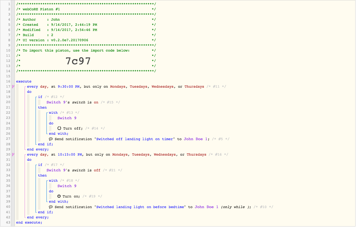

Actually, now that I looked at it some more, it will not fire because you will have 2 triggers which will never happen.

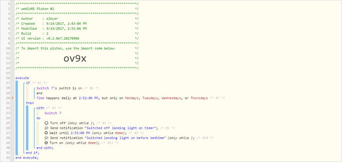

Edit: Let me try rearranging it on my end.
This is what I came up with, you can import it or edit your original. My version has shortened time for testing and also I dont have Contacts enabled.
You can edit yours so that all of the Tasks are in sequence in that one group.
This is how I was going to structure it as well. You might need to change the TCP to never cancel. You’ll find this setting by clicking on the with and then clicking the cog icon.
The reason for this is due to the long wait. Eventually the piston state will revert back to false (because it is no longer 9:30:00 pm and the switch is no longer on) and this will cancel any pending tasks. Usually happens within 30 seconds after firing.
Thanks @eibyer for the restructured code, I decided to import yours rather than mess with my original. The only bit I don’t get in your code is why the ‘Turn off’ and second ‘Send notification’ tasks have “(only while )” next to them, i.e. is that deliberate for a reason I don’t understand or do I really need to make those “only while Home”? The reason have the location mode condition is because I don’t want this piston clashing with one I have for simulating lights when we are away - although thinking about it now that light simulation piston has a condition to only run if SHM and location are Away so I don’t think a clash could happen anyway…

The (only while) is just a cosmetic bug that gets left behind when you remove all the Mode conditions. I removed your Home mode for testing yesterday.
