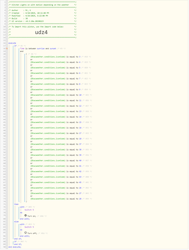

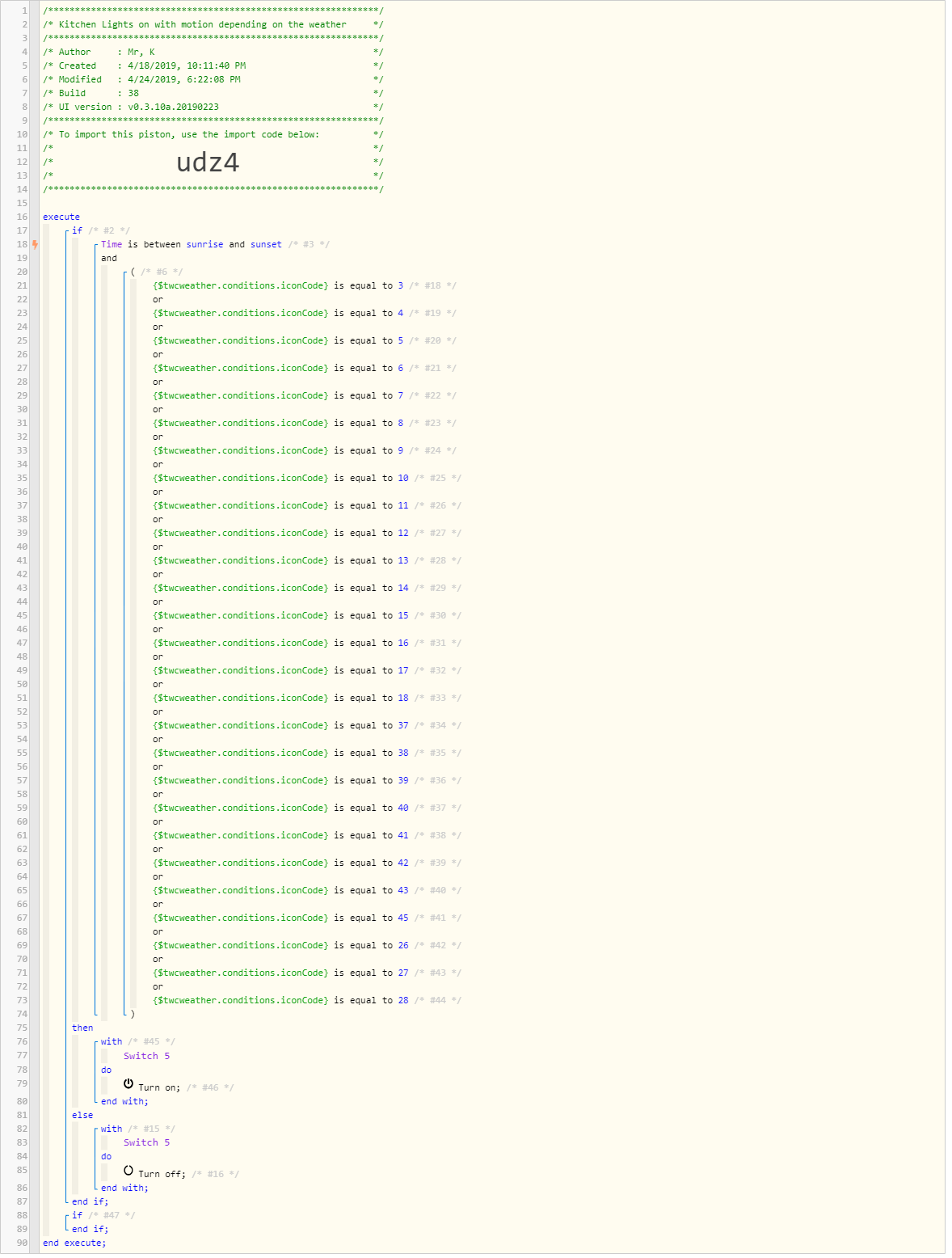

Piston only firing twice a day. want it to fire everytime the weather changes
Have piston condition set for between sunrise and sunset but its only fires at sunrise and at sunset

As far as I know, $twcweather cannot be used as a trigger.
You have to actually make a query to know the current iconCode.
can you recommend any other ways of designing this piston?

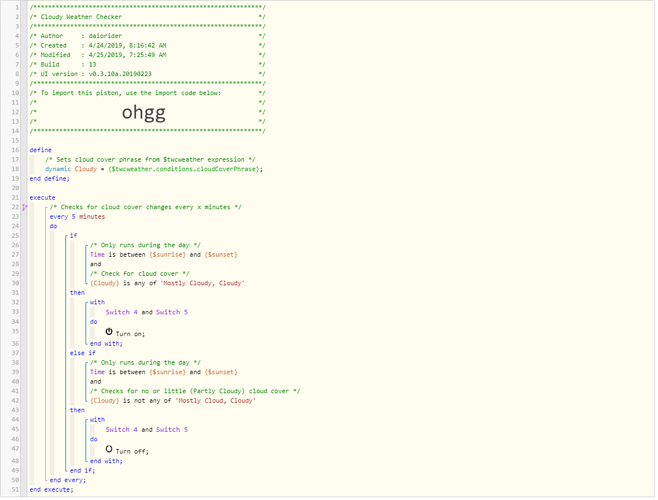

This is likely the structure I would start off with:
Note:
The TEST button will not do anything with this piston. You have to import it and wait an hour to see it in action.
Thank you soooo much you rock!

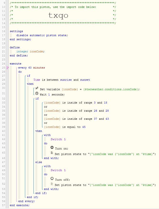

I was just working on a similar piston and found this one works pretty well.
I will most likely change the timer to every hour but for now it seems to work correctly.
One thing I did notice yesterday is that $twcweather intermittently reported cloud cover as Partly Cloudy while it was dumping down rain. This may simply be that my reporting station is far enough away that there was a momentary break in the clouds.
I also added a daylight checker so the lights wouldn’t come on in the middle of the night and I already control lights in the morning and evening via ST.
For now it seems to be doing what I want.
