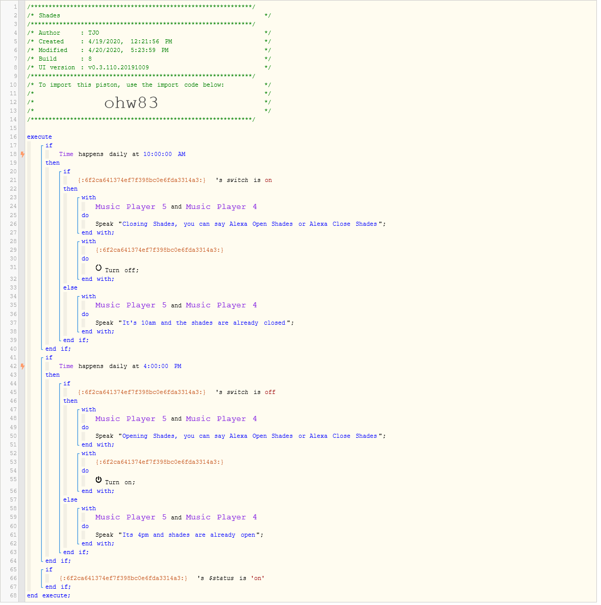

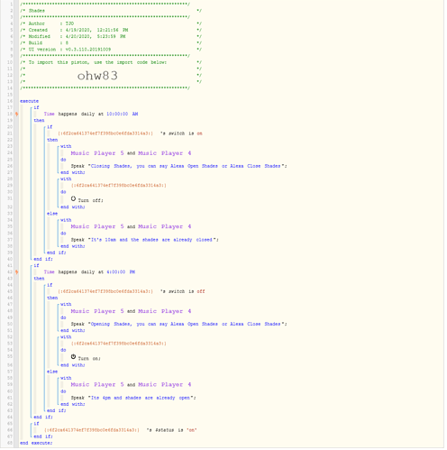

piston should have run and closed shades at 4pm
wake up at 4pm and close shades
woke up at 4:07 and happened daily time check failed
Also I’m not sure whether the funny long hex string is an indication it doesn’t know what device it is ?

6/1/2020, 4:07:00 PM +575ms
+1ms ╔Received event [Home].execute = recovery with a delay of 48ms
+65ms ║RunTime Analysis CS > 16ms > PS > 17ms > PE > 32ms > CE
+67ms ║Runtime (40148 bytes) successfully initialized in 17ms (v0.3.110.20191009) (66ms)
+68ms ║╔Execution stage started
+74ms ║║Comparison (time) 58020647 happens_daily_at (time) 36000000 = false (0ms)
+76ms ║║Cancelling condition #2’s schedules…
+76ms ║║Condition #2 evaluated false (4ms)
+77ms ║║Cancelling statement #2’s schedules…
+80ms ║║Requesting time schedule wake up at Tue, Jun 2 2020 @ 10:00:00 AM CDT
+82ms ║║Cancelling condition #1’s schedules…
+83ms ║║Condition group #1 evaluated false (state changed) (11ms)
+87ms ║║Comparison (time) 58020661 happens_daily_at (time) 57600000 = false (0ms)
+89ms ║║Condition #8 evaluated false (4ms)
+90ms ║║Cancelling statement #8’s schedules…
+93ms ║║Requesting time schedule wake up at Tue, Jun 2 2020 @ 4:00:00 PM CDT
+95ms ║║Condition group #7 evaluated false (state did not change) (10ms)
+105ms ║║Comparison (string) ACTIVE is (string) on = false (1ms)
+106ms ║║Condition #22 evaluated false (9ms)
+107ms ║║Condition group #21 evaluated false (state did not change) (10ms)
+109ms ║╚Execution stage complete. (41ms)
+111ms ║Setting up scheduled job for Tue, Jun 2 2020 @ 10:00:00 AM CDT (in 64379.315s), with 1 more job pending
+119ms ╚Event processed successfully (119ms)
