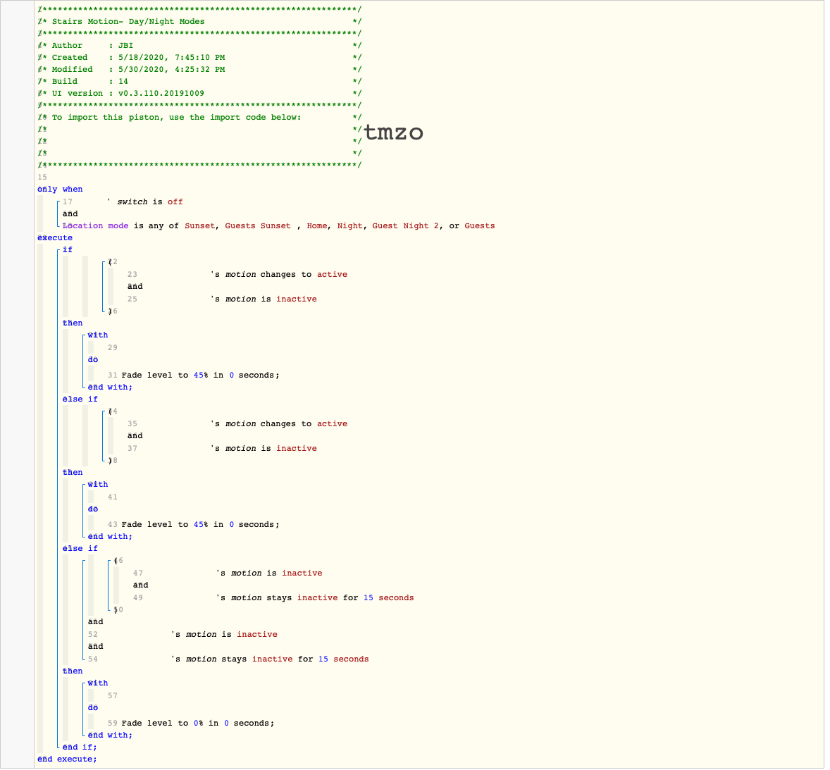

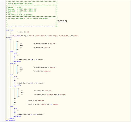

I have a piston that evaluates my motion sensors at the top and bottom of the stairs and turns my lights on. It accounts for motion being active at the top or bottom and the other being inactive so I do not get a double execution of the lights turning on. After 15 seconds of no motion on both sensors, it shuts off the lights. The piston has worked perfectly until today. Now the lights will turn on fine, but when motion goes inactive and it sets up the job to turn the lights off, instead of turning them off the log reports back the piston executed a recovery. It sets up another job. This now seems to be looping. Any ideas what could of happened?)
(Lights should turn off as they have been doing.)
(The lights turn on but do not turn off. )
