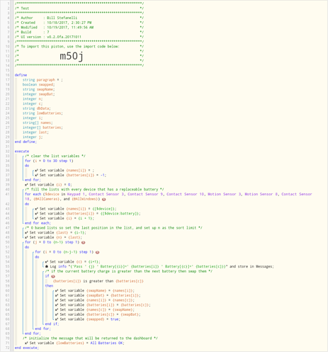

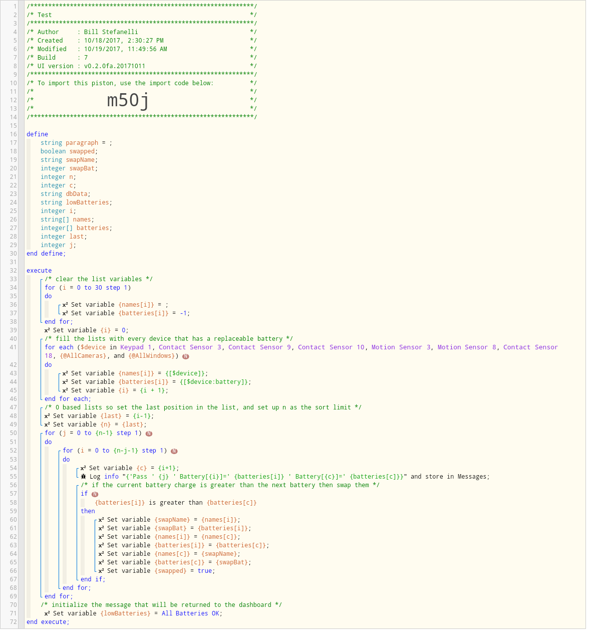

Part of the problem is the code isn’t allowing trace, so no line numbers. Full logging turned on and I usually don’t get anything there, and nothing on the IDE console. I am assuming the timeout now, maybe that’s resulting in no log data and missing Trace Toggle. I am doing a small sort on 2 lists of 24 items (plus a bunch of other stuff, but the sort takes up most of the processing). Probably not what this platform is for. I wouldn’t even have tried it if I could figure out another way to store the data to be formatted outside of webcore. Well a straightforward way, maybe i can jury rig something with IFTTT. I don’t know if this is remotely possible, but is writing to a local file system planned for webcore?
Sure thing… and thanks for looking at this!
The sort stops somewhere around the 3rd to 4th pass (outer loop) and the piston ends with no further processing. Theres a lot of subsequent code thats disabled bur it doesn’t execute when the sort is interrupted. If you prefer I enable it so you se the whole thing let me know.

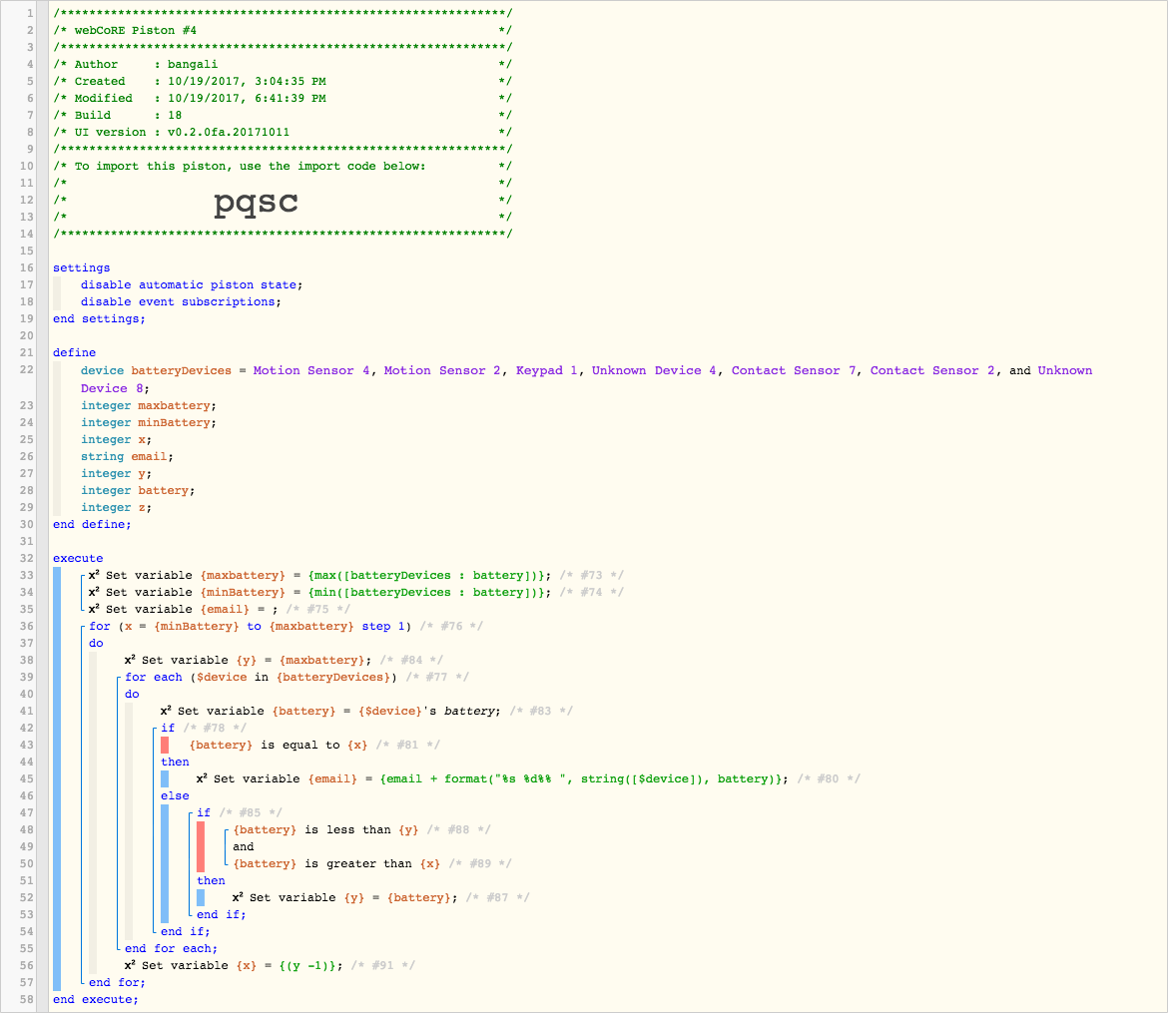

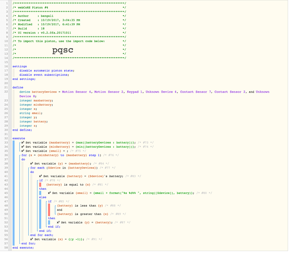

if you are looking for email formatting these devices from low to high battery heres a quick version to do this:
define
device allDevices = device 1, device 2, device 3
int maxBattery
int minBattery
int x
string email = ''
end define
set variable maxBattery = max([allDevices : battery])
set variable minBattery = min([allDevices : battery])
for x = minBattery to maxBattery step 1
for $device in allDevices
if ([$device : battery] == x)
set variable email = email + $device + ': ' + [$device : battery] + '% '
end if
end for
end for

sure! mind you not guaranteeing this wont run in to the 20 second boundary! probably depend on the number of devices.
very.

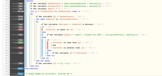

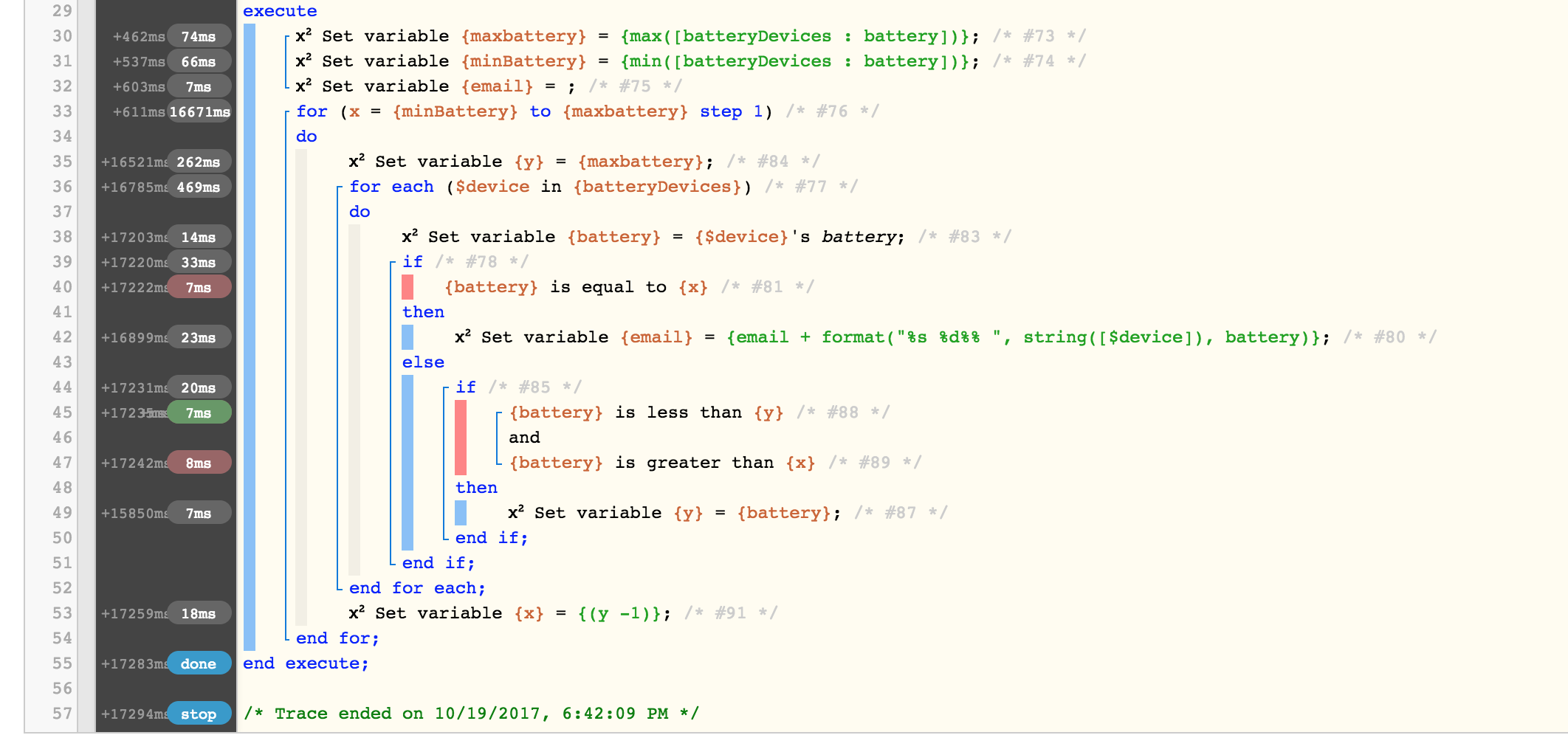

heres a slightly optimized version of the snippet above. from trace its taking ~17 seconds to run and thats with 7 devices. once i include 10 devices it times out.

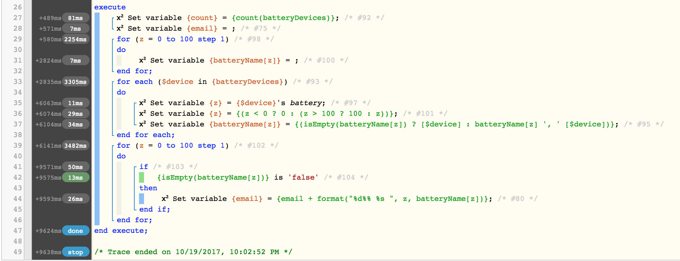

fixed mine for you. with 26 battery devices takes under 10 seconds:
even wtih 50 or so battery devices shouldnt take more than 15 seconds so a 5 second margin.
