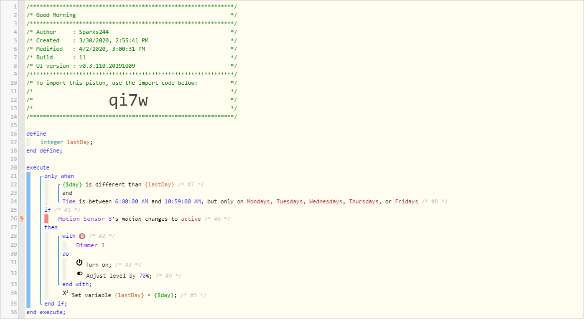

Piston run once per day

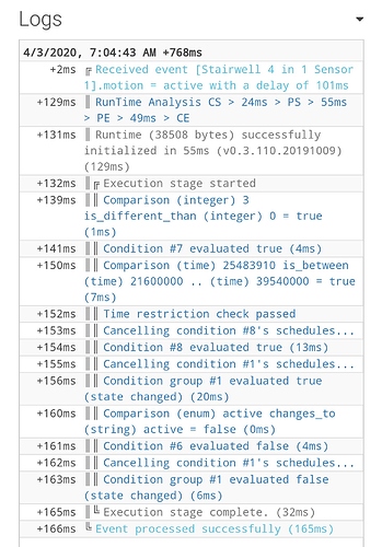

I researched many posts about this and thought I did it right but the piston does not turn the light on
Once per day, between 6 and 11, if motion is detected, turn on the light

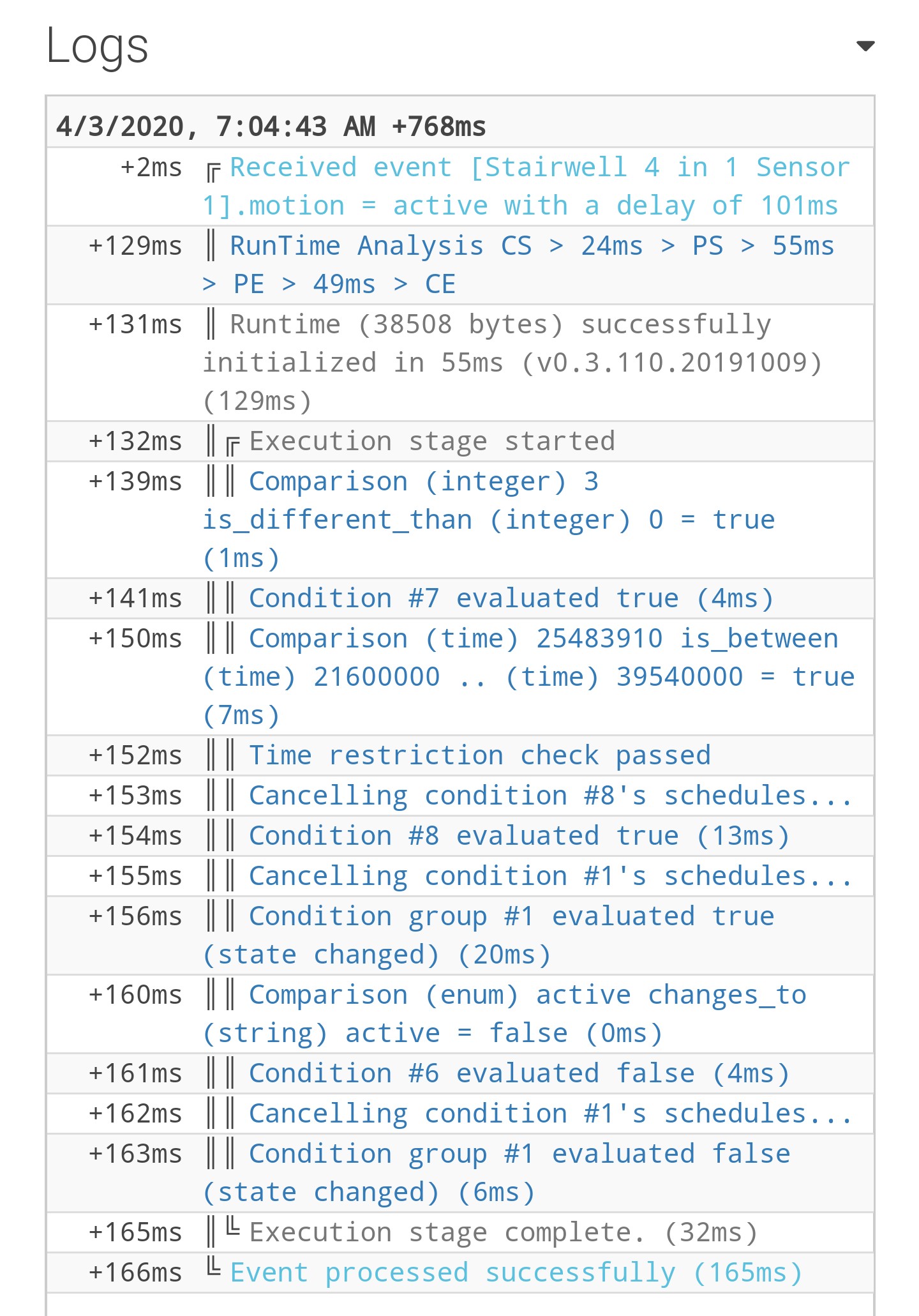

Looking at the log it appears that it starts to run but the light does not turn on.
Looks like it is showing false for the changes to condition which it shouldn’t. I was getting caught by a similar situation last week with a short piston. Try adding a wait at the end of your piston to be sure it completes properly. If that doesn’t work, you could try turning the only when conditions to a nested if statement.
The piston has received a motion active event but the ‘changes to active’ trigger requires it have previously seen a motion inactive event in order to recognise it as having changed. Does your motion sensor device handler send inactive events?
If it doesn’t you can use ‘is active’ which has the side effect of also running the piston at your between times (which is often handy anyway).
Actually looking closer at the logs, it looks like the state has changed which suggests the device handler may well send inactive events but also sends consecutive active events instead of just changes. Some handlers do that.

+130ms ║║Condition group #1 evaluated false (state did not change) (16ms)
+132ms ║╚Execution stage complete. (22ms)
+133ms ╚Event processed successfully (133ms)
4/8/2020, 5:55:35 AM +162ms
+1ms ╔Received event [Stairwell 4 in 1 Sensor 1].motion = active with a delay of 115ms
+108ms ║RunTime Analysis CS > 18ms > PS > 44ms > PE > 47ms > CE
+110ms ║Runtime (38533 bytes) successfully initialized in 44ms (v0.3.110.20191009) (108ms)
+111ms ║╔Execution stage started
+118ms ║║Comparison (integer) 8 is_different_than (integer) 7 = true (1ms)
+120ms ║║Condition #7 evaluated true (4ms)
+128ms ║║Comparison (time) 21335282 is_between (time) 21600000 .. (time) 39540000 = false (6ms)
+130ms ║║Condition #8 evaluated false (10ms)
+131ms ║║Condition group #1 evaluated false (state did not change) (17ms)
+132ms ║╚Execution stage complete. (21ms)

Thanks… Just to clarify, are you still running piston “qi7w” from your first post above?
Or have you modified it since then? Please post a fresh snapshot if there are any changes.
