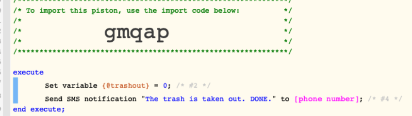

Piston runs on a day it shouldn't

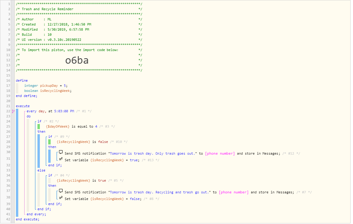

I have a piston that should send a text message on Thursday reminding us that the next day is trash day. It runs on Thursday but also runs again on Friday. I’ve attached a screenshot of the piston and also what’s showing in the log. It ran successfully yesterday but you can see it’s scheduled to run again today. Please ignore the variable declaration pickupDay. It’s from a previous iteration and is no longer used. Thanks for any insight anyone can provide.
The piston should only run every Thursday at 5:03.
This piston runs at 5:03 on Thursday and again on Friday.
**4) Post a Green Snapshot of the piston![image|45x37]Log

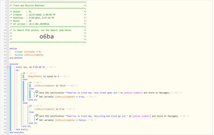

According to line 22 in your piston, it will execute every day at 5:03PM…
…but…
Your condition on line 25 should abort it a moment later on every day except for Thursday.
I don’t use timers much but you should be fine with this piston…
Something like this.

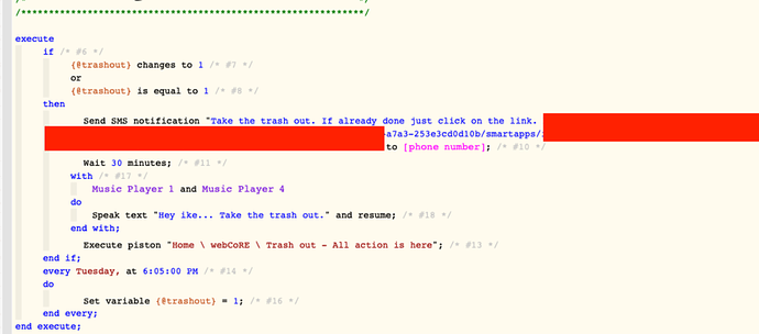

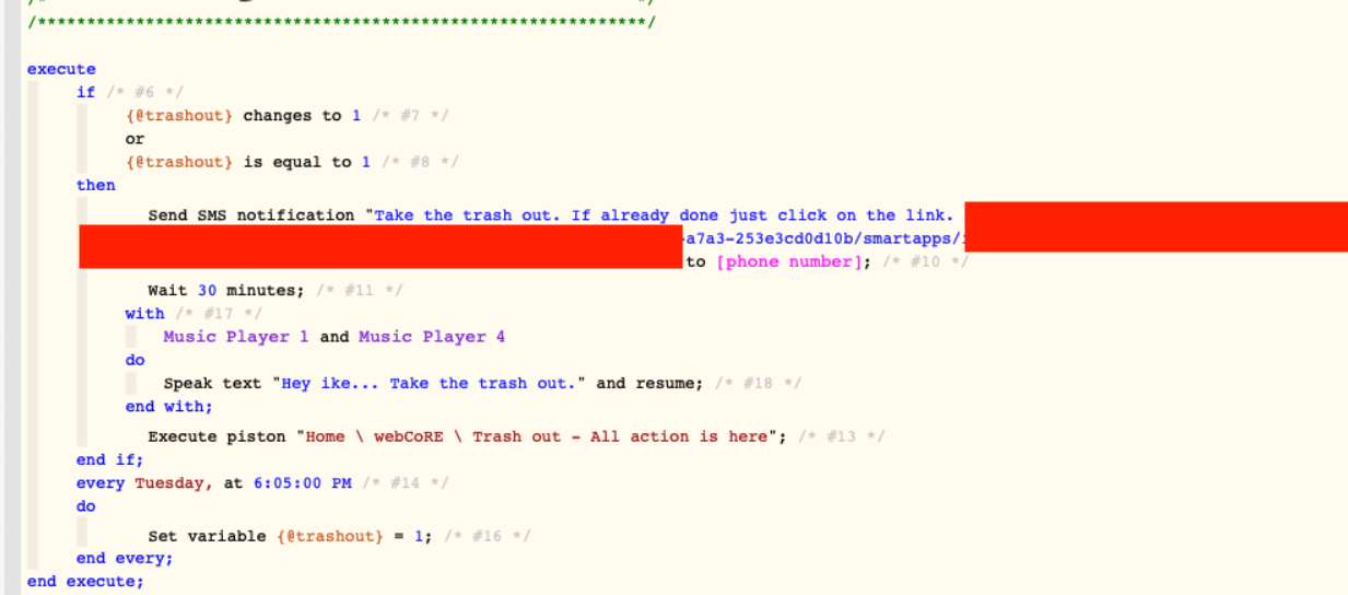

I want to share my TRASH OUT piston.
The piston sends me an SMS every 30 minutes until I take the trash out.
When I click on the SMS message link, it executes another piston to stop the 30 minute madness:)
This one STOPS the repeating messages…
This one sends messages
